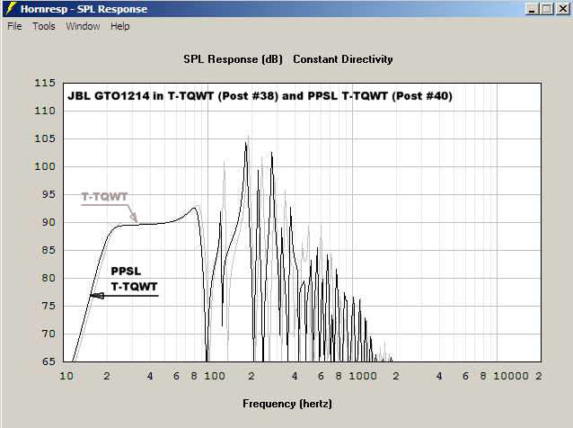

whats the box tuned to? is there a response plot?
tb46, what do you mean by both, do you mean ppsl vs your older design with just pp?
The reason I am a fan of ppsl is the lack of distortion, since tapped horns/t-tqwt still have a side of the driver near the mouth, the distortion from that side of the speaker will be heard (educated guess).
Upon reading the differences in horn vs tapped horn many have said that because of this that distortion can be heard in taped horns a lot more than traditional horns.
Also I read somewhere that ppsl has even less audible distortion than horns and that some hifi enthusiasts replaced their tapped horns with ppsl designs.
I do know that it could be minimized a lot by having a similar design to your first but both speakers in opposite directions yet this doesn't not yield as much distortion reduction as does ppsl.

With both I ment the T-TQWT from Post #38 and the PPSL T-TQWT from Post #40.
I was under the mistaken impression that you were using Hornresp, that way you could get all the data/graphs you want for both enclosures. You could just type in the input screens that I provided, and look around in Hornresp; if you do that don't get confused with the Hornresp impulse response in graph form, it does not represent the impulse response of the partially stuffed enclosure, and does not have any provision for representing the effect of low-cut and high-cut filters; use the impulse response spectrogram instead.
From Post #38: "...The driver that sits further away from the mouth could be reversed for improved distortion cancelling, but that will require a 3/4"-1" shim, and it will restrict the duct, so it would have to be tried. ..."
As to the construction: personally I use something like Titebond glue with a nail gun and clamps/straps. The nail gun makes positioning easy. Sometimes I'll use a bisquit joiner for more difficult, or stressed, corners. Col's advice sounds fine too.
Whatever you do, make sure that you can get the drivers in and out, and that you can modify the filling/stuffing easily. For the PPSL that will be more difficult. I did obviously not draw all the fine details for cleats, or blocking, etc....

Providing the access to the drivers and throat is not too much of an issue I am thinking I should order the drivers and get started soon!
Hi reminence,
Go with the T-TQWT (Post #38), much easier build, much easier access. Just a few pointers:
- make the front baffle removable (!), that'll give you access for easy speaker mounting (use T-nuts or hurricane nuts on the back of the speaker baffle)
- provide access to the sections that need stuffing if you feel like you would like to fiddle with it; or, just apply about 1 lb (16 oz.) evenly as indicated in the drawing, and leave it as that. Maybe bjorno can help with a more scientific explanation.
- with cleats and blocking I'm just referring to corner reinforcement.
- you also may add some board to board bracing as DrDyna did here, Post #21:
http://www.diyaudio.com/forums/subwoofers/188283-fiddling-hornresp-peerless-831759-a-3.html
- if you add braces, cut holes in the braces to reduce their acoustic influence (I'll try to find a better picture for you, or maybe somebody else can provide one)
Take a good look at how ODougbo solved his problems:
http://www.diyaudio.com/forums/subwoofers/203345-isobaric-less-then-20-a.html
He even retrofitted access holes in a box he had already glued together (Post #125), just a lot of ways of doing all this.
If your studio is residential, you'll get more than enough output out of even one of the T-TQWT.
