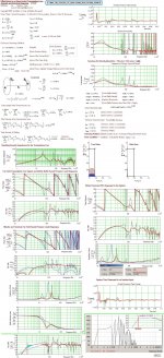

Here is an attempt to find out what's needed:
b:)

Hi reminence,
"... how your schematic fits with the plans?"
Just an example, I'm just showing the location of screws in a removable panel. Obviously, this panel could be made removable, so one can fiddle with the stuffing, but-as we discussed earlier-it doesn't have to be.
bjorno,
Nice work, so you are recommending about 1.3 lbs. of fiberfill? This should be a very nice sounding subwoofer.
