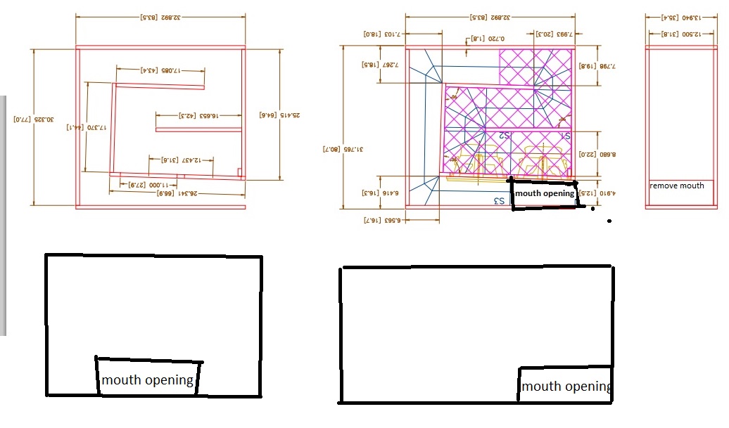

Hi reminence,
Here is my first stab at it, a simple folded T-TQWT. Gross volume is 238.7 L. It should be able to handle 500W without exceeding Xmax in its passband.
The size could be slightly modified to provide for better wood usage. The driver that sits further away from the mouth could be reversed for improved distortion cancelling, but that will require a 3/4"-1" shim, and it will restrict the duct, so it would have to be tried. When building it I would leave one side removable to get to the drivers and filling. It could also be build as a single fold.
Let me know what you think.
Can the mouth opening of this design be remove and be place as indicate in the attach picture. If it can be done what would be the cutout size. Please see attach picture below.
Hi Beat Street,
Post #38 has the Hornresp Input screen. Looking at Hornresp your mouth opening on the right hand side would work fine, keep the area the same. The other opening should be centered on the middle between the two drivers (not any further left), opening size the same.
Once you apply an active bandpass filter in the Filter Wizard it looks like you might not need any damping. Hornresp has come a long way since this was done.

Hi Beat Street,
There will be very little difference in the simulated performance when changing the external width from 13.94" to 13.5"; but the driver won't fit (see below).
The mouth particle velocity peaks around 24Hz @ about 16.8m/sec w/ Eg=63.25 V (500W into 8 Ohm). It will take a 4th order bandpass (20Hz/80Hz) to keep everything under control.

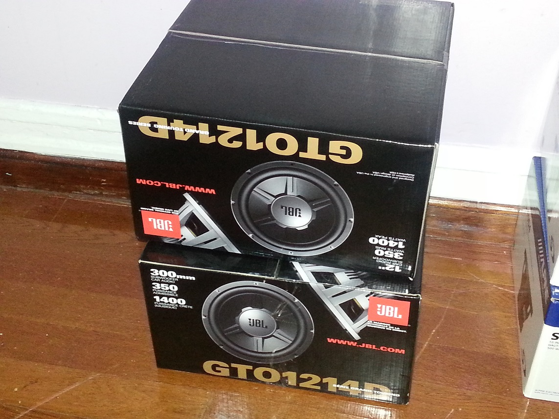

Watch out for the driver dimensions, I have the JBL GTO 1214D @ 12-5/16" 12.323"[313mm] in my drawings. If you use standard void-free plywood (23/32") you'll have only 12-1/16" left over as the internal width; you might have to go to 1/2" plywood for the side plates (at least in the driver area).
You could also make the box square, e.g.: 31-7/8" x 31-7/8" without changing the response materially.
