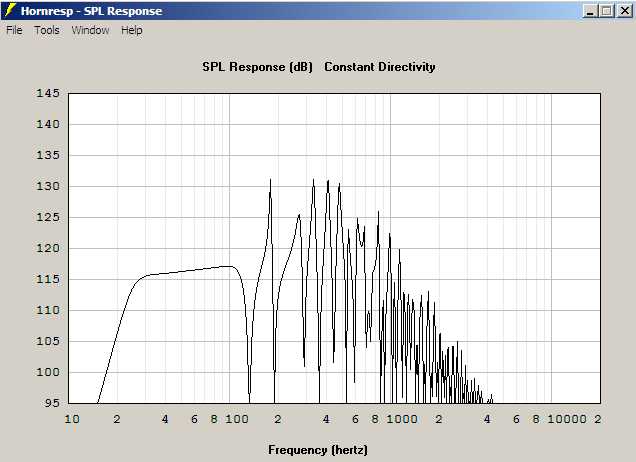

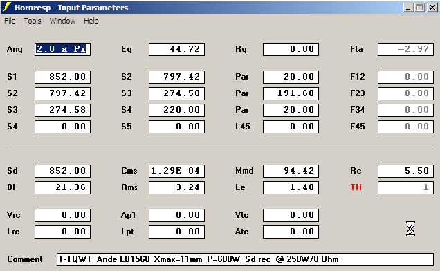

How about bjorno's T-TQWT for the Ande LB1560 (please, note the changed Sd), you could build two of those, and still have room left over:
