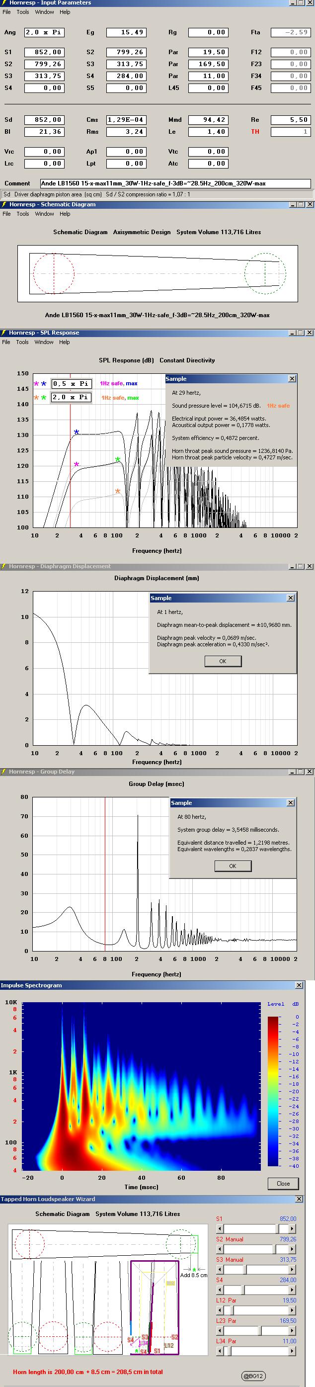

The T-TQWT is bjorno's specialty, he has suggested that particular layout many times; maybe he'll chime in on this subject for your application. For general information and references see these threads:
http://www.diyaudio.com/forums/subw...band-w8q-1071f-8-x-12-box-reccomendation.html, and
http://www.diyaudio.com/forums/subwoofers/188283-fiddling-hornresp-peerless-831759-a.html
The simulation is for Xmax (Hornresp: 11.0991mm @ 38Hz) @ 250W into 8 Ohm. Obviously it depends totally on the quality of the data. The best first step would be to measure the T/S parameters.
By the way, even a dual driver version (e.g.: push-pull) would be only 260 L_net (Hornresp).

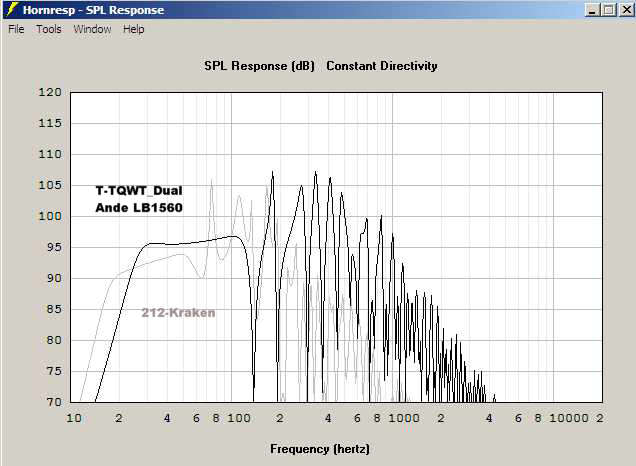

Hi reminence,
Post #24:"...the t-tqwt design needs a lot of tweaking and damping to get right."
If you compare the SPL responses of e.g.: the 212 Kraken (485.837 L_net) v. a Dual LB1560 T-TQWT (260.603 L_net), I think that is pretty much a wash as far as tweaking is concerned. Both benefit from some absorptive treatment in the horn path, and both need steep high and low cut filters.

So a t-tqwt does not need much tuning? I am surprised that two of the much larger and more powerful ande drivers don't give much more volume.

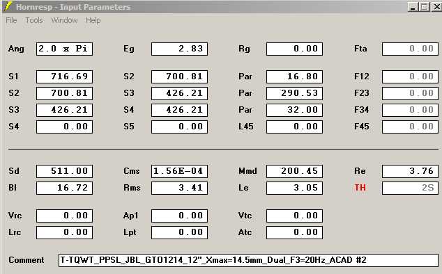

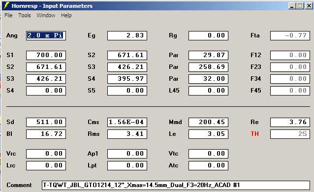

Hi reminence,
For a single T-TQWT with the Ande LB1560 about 125 L_net, for a double about 260 L_net. Note that bjorno's in Post # 22 is a bit smaller.
For the JBL GTO1214: I ended up with 211 L_net for a home theater version that goes down to about 15 Hz, and 181 L_net for a dual with F3=20Hz (which is what I would probably recommend). So quite similar.
I have not done a full design/drawing to see how the drivers would fit, etc., obviously, you can push the response up and down a bit to suit your requirements, and to fit whatever final layout/space requirements.

Hi reminence,
Post #34: "...If you cant think of any reason why this hybrid design might not work I might just build it..."
Should work well.
The layout will be more difficult than for a simple T-TQWT. NEO Dan designed a very straight forward T-TQWT box for ODougbo that you could use as a starting point, Post #50:
http://www.diyaudio.com/forums/subwoofers/203345-isobaric-less-then-20-a-5.html
It'll be a bit of a puzzle to add the PPSL feature to it, but it should be possible 🙂-)).
I've been doodling on T-TQWTs for a while, here are two examles, Post #50:
http://www.diyaudio.com/forums/subwoofers/198056-th-t-tqwp-5.html
The T-TQWT should work fine in a studio environment, especially in multiples.
