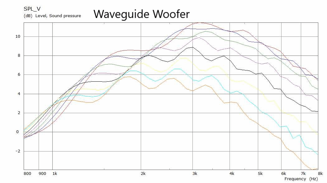

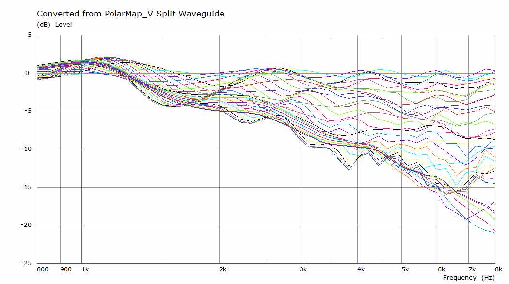

Here's the gif, the difference plot was not a simple solution so far so that may not happen. You can see the changes clearly when you look. The peak of the SPL is shifted, the first two contours cross over each other more often and the further off axis vertically the more ripple there is in the response tending towards slight nulls at some frequencies.
Dave Zan posed some questions...to reduce centre to centre distance and what effect that would have.
It turned out to be much more complicated...🙂
I kind of expected it would be more complicated than expected, first law of software.😉
So thanks once more for the effort, obviously not just for my benefit but for everyone to learn more.
It is an eye opener to see the disturbance to the WG response from the woofer alone, even when not nested in the WG.
The incremental difference from the nested closer distance seems rather small.
Unfortunately the vertical scales don't quite match to overlay, so it's difficult to compare exactly.
Is there an easy way to make it switch from one view to the other on demand rather than have it jump interminably?

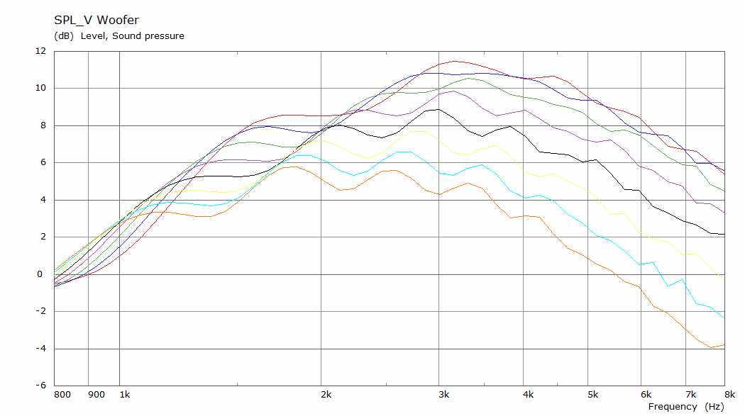

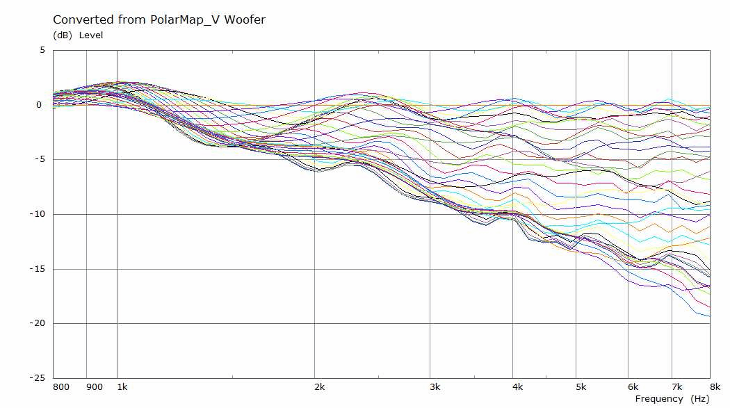

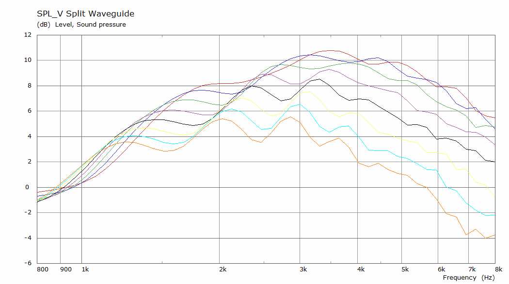

Thanks for that! And for the effort of investigating the integration between tweet and woof!!
Would it give a more clear view if the plots were normalized? As they have effects at different frequencies it is hard to see all of it. When normalized (at the design/listening height) you'd get to view the specific differences compared to the preferred axis.
It ended up being more a CAD task than anything else to allow the meshes to be generated properly. I'm glad you and others found the effort worthwhile.I kind of expected it would be more complicated than expected, first law of software.😉

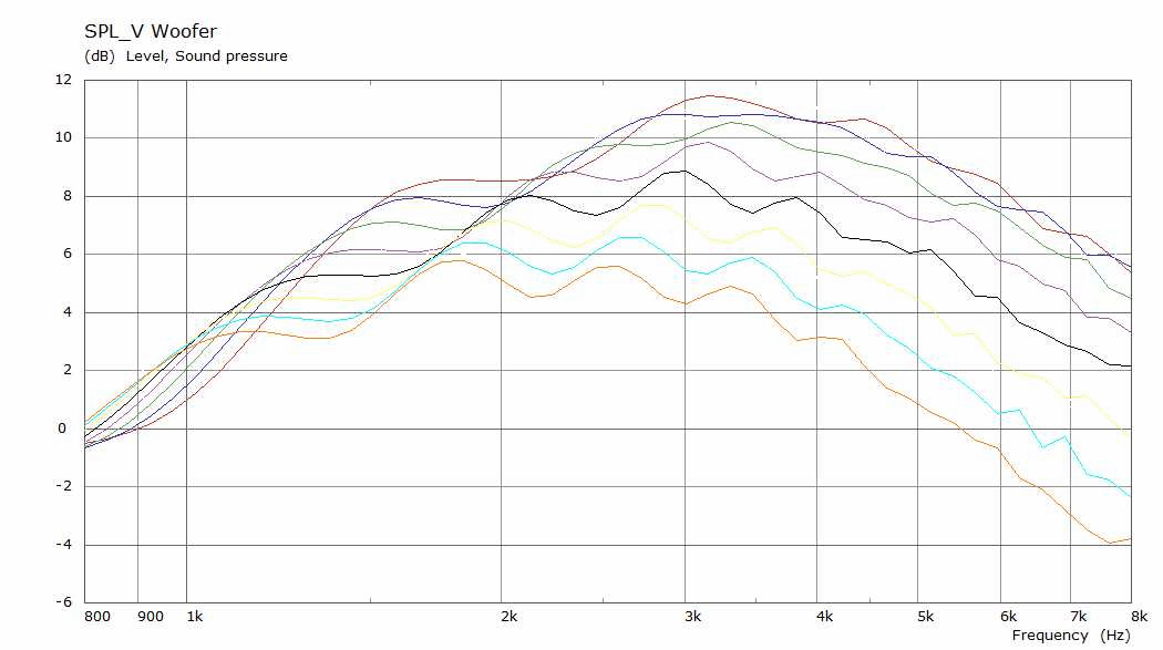

Yes the woofer is the main culprit but I think the scaled graphs I'm adding below show the differences more clearly and that there's an overall shift to the diffraction pattern that is not positive from the split.It is an eye opener to see the disturbance to the WG response from the woofer alone, even when not nested in the WG.

I have slowed down the gif as much as I can due to the forums file size limits for gif's. I have added the graphs as separate images so you can switch at your leisure in the same post 🙂Is there an easy way to make it switch from one view to the other on demand rather than have it jump interminably?
A difference plot would be very helpful.

Scaled normalized polar curves added as wesayso suggested. They get messy but the pattern shift is clear.

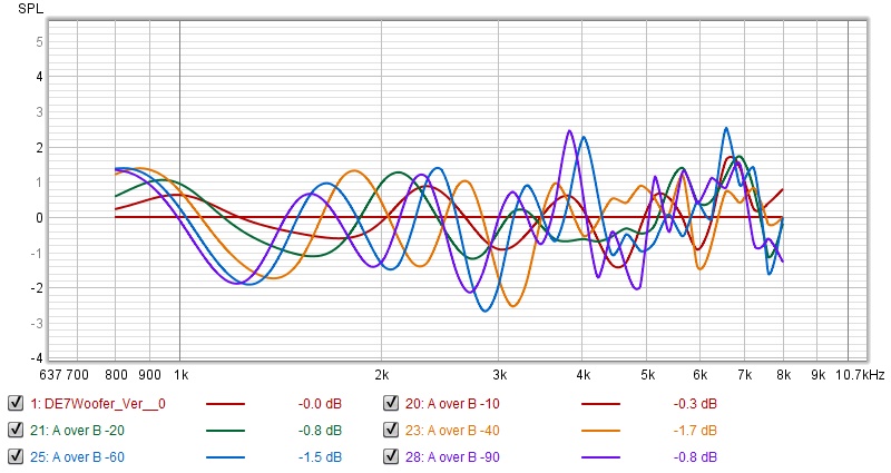

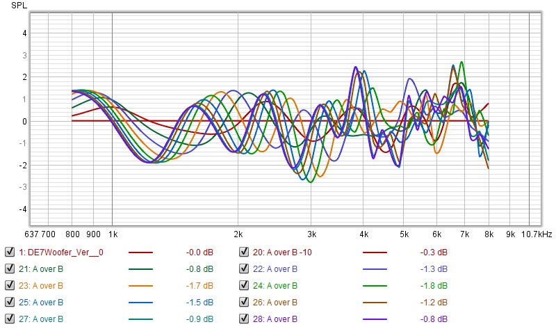

What would be nice is a plot of the difference between the two cases.

Very true and in this case produced an unexpected result that now needs further investigation.Hopefully you too. I usually find my answers to questions help me understand better at least as much as the questioner.
So far this is the best I can do. The plain woofer measurement divided by the split waveguide measurement after normalization of the polar curves. These are the negative vertical angles in 10 degree increments. I could not find a simple automated way to do this so experimenting is quite tedious.Thanks, that's much better.
Reduced angles and a better legend

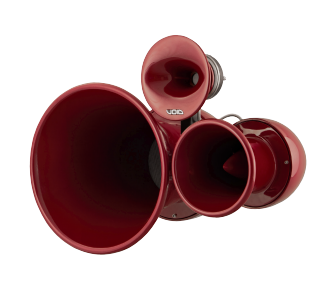

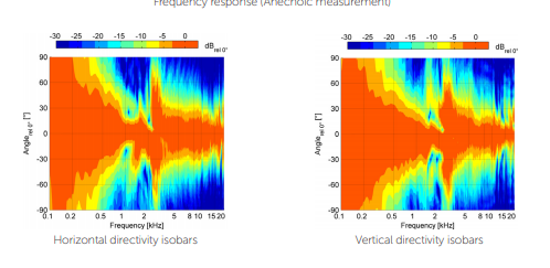

Coaxialy mount the woofer behind the compression driver and use expanding taps from the woofers phase plug (that contains the compression driver) into the main horn bell. A bit like the RH co-entrant horn: Renkus Heinz 1996 unity horn patent? US5526456A
would look a bit like a Void airmotion but with only the large horn and additional side horn ducts:
https://voidacoustics.com/support/air-motion/Air_Motion_Specification_Sheet_V1.1.pdf
(and would hopefully have much better directivity plots than said speaker!)

would look a bit like a Void airmotion...
The "pile of independent horns" has always looked to me like it would have polars that were also a pile...
of ****.
The Void polars confirmed my expectations!
Hence my scepticism of proposals for a free stand horn.
But not to rubbish your RH proposal because maybe there's a way that I haven't seen yet, hence my interest too.
