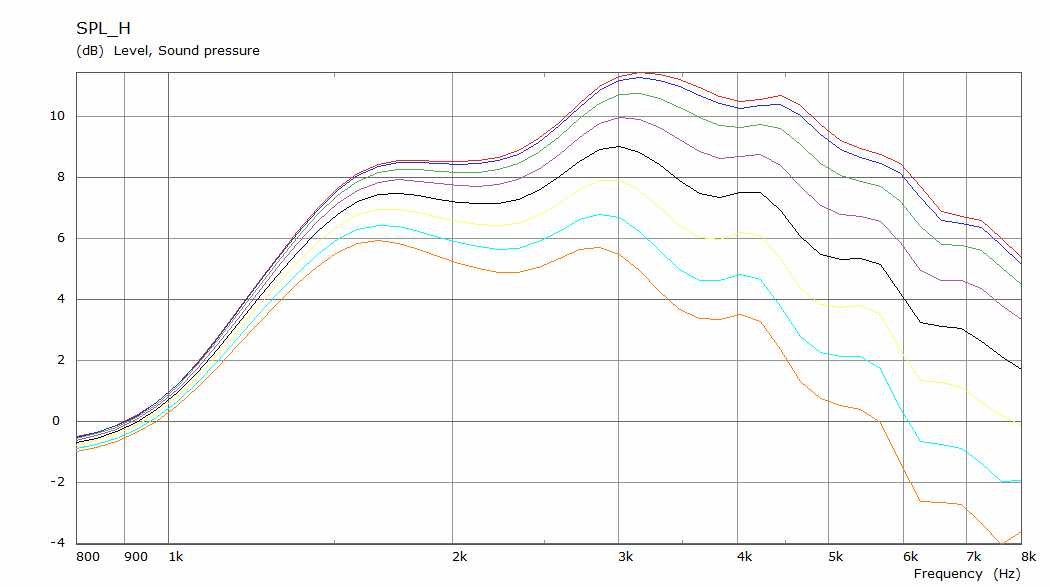

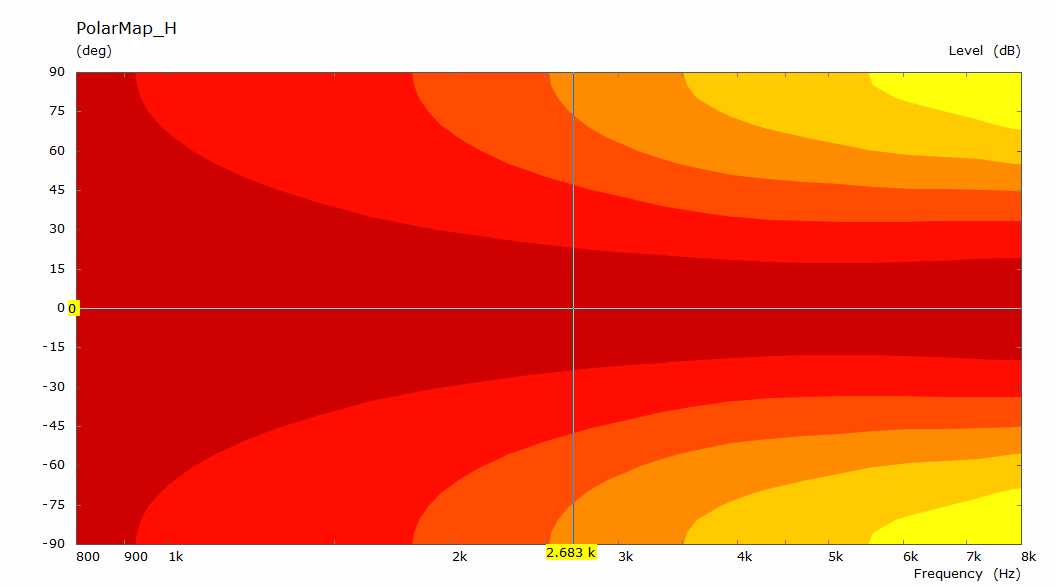

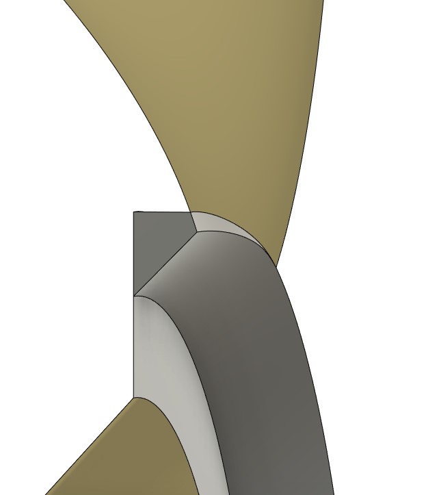

Dave Zan posed some questions on Mabat's waveguide thread about nesting a woofer into the waveguide to reduce centre to centre distance and what effect that would have. I was intrigued to see if I could simulate the effect. It turned out to be much more complicated and time consuming than I thought it would be 🙂

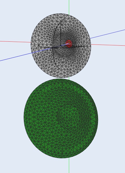

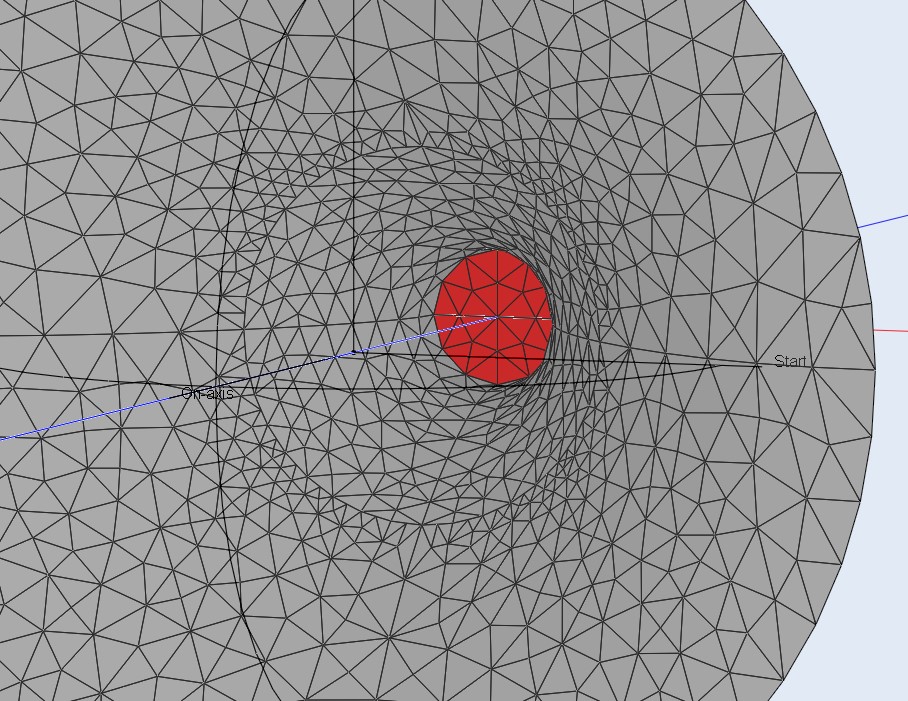

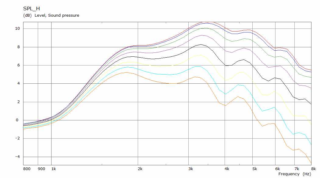

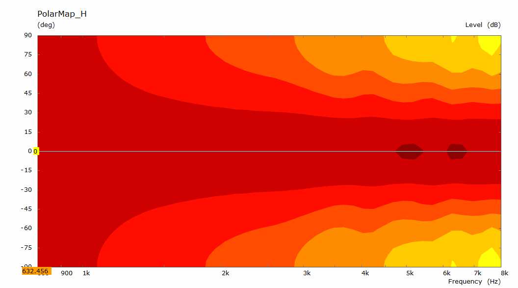

Anyway it forced me to dig deeper into what I was doing with ABEC and 3D CAD to get the profiles and meshes needed to run the simulations. I worked out a method to mesh the waveguide in sections to allow higher resolution near the throat but still allow it to join at a lower resolution further out so it could be combined with the woofer in a single mesh.
For these simulations I have used an infinite baffle to reduce the element count and to keep an even playing field for diffraction effects. I have also used a smaller waveguide to keep the simulation times down to manageable levels. The woofer is an approximation of a 6" size. The SPL peak is at 3K instead of 1K on the bigger devices. I have limited the frequency range to 800 to 8K.
I have picked a guide with smooth basic response alone so the differences are more obvious. I'll put the versions tested in different posts below.

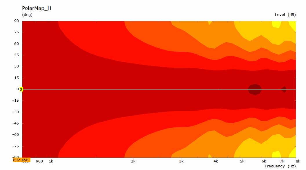

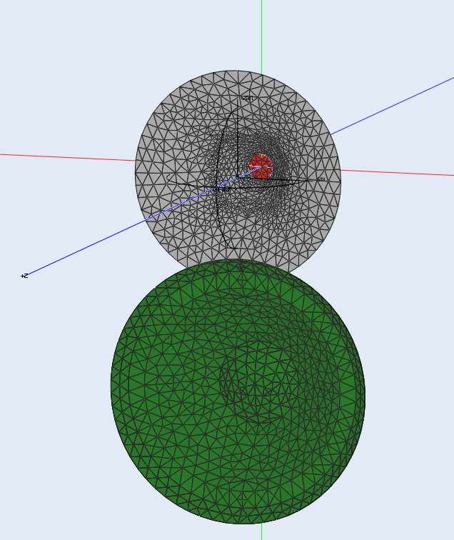

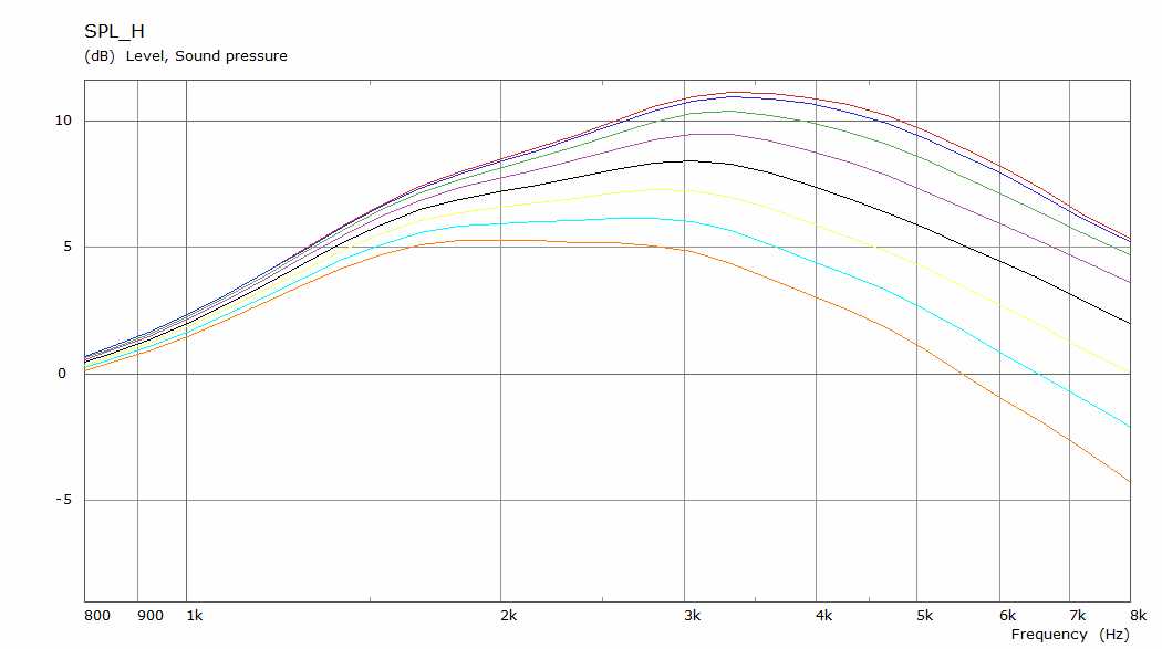

Attached below are the control waveguide SPL and Polar plots.

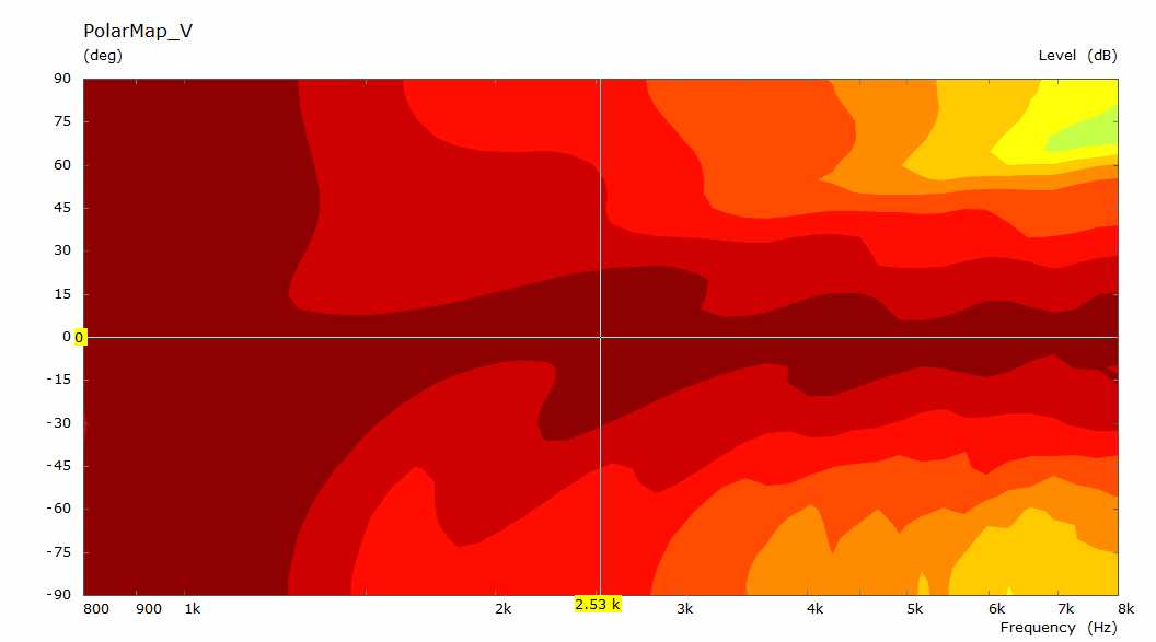

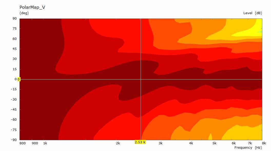

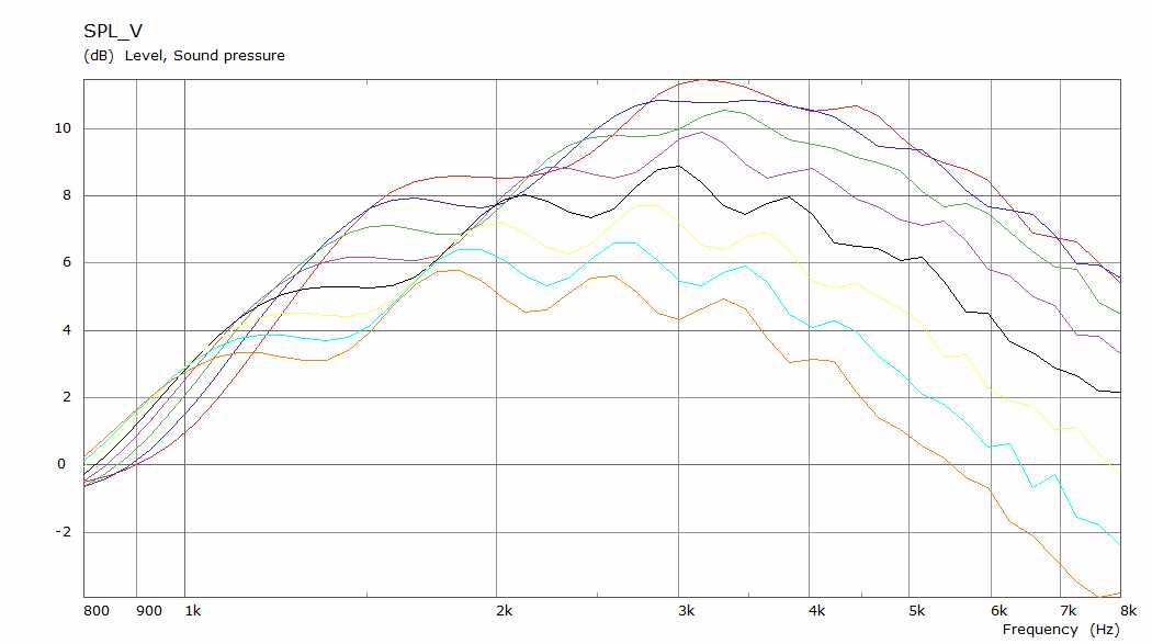

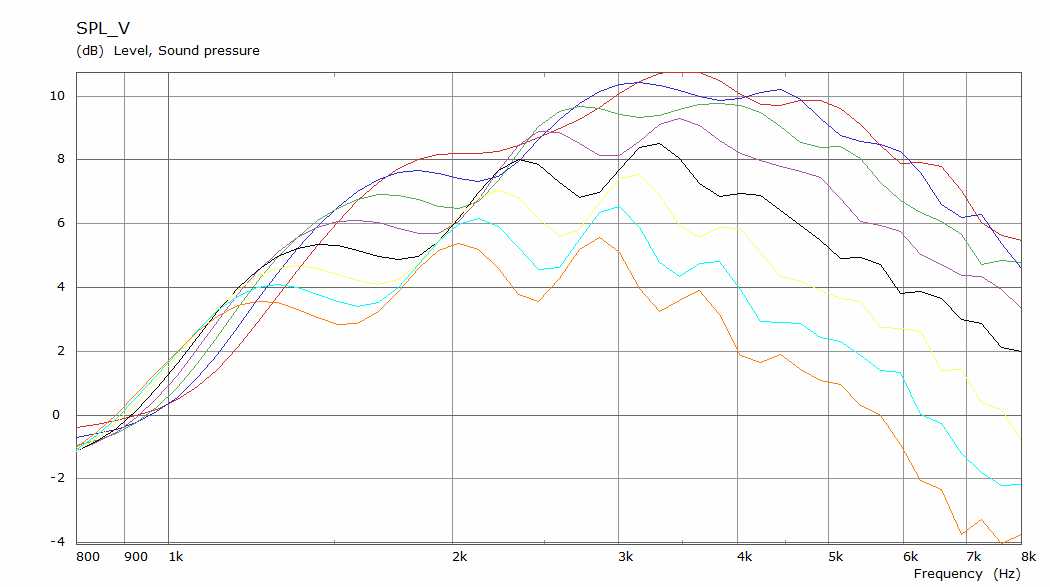

This is the change in response by adding a simulated woofer profile below the waveguide almost as close as possible. It introduces about a 0.5 to 1dB ripple in the horizontal as well as a more even vertical as would be expected. Not so pretty vertically anymore. The boundaries are rigid in the simulation and in reality they may be less pronounced.
This is the response by moving the woofer up 20mm so it cuts into the bottom of the waveguide. I cut the rebate with the waveguide then the waveguide with the rebate and removed the residue. It could be smoothed better for for these purposes the geometry will be meshed anyway.
Result is more ripple and worse vertical the lower in frequency you go. This seems to me that the degradation in polar would make crossing higher more necessary with this arrangement. To make a true comparison a driven woofer and crossover would need to be simulated to see the end result.
I am now more happy that I bought the HF1440 to allow me to cross lower and get the woofer further away from the waveguide.

Great comparison but a bit hard to evaluate. The bass is not in the simulation so one can't asess (total summed FR of LF & HF) the eventual positive in the lesser c-c of the last variant - I suppose this is why one would like them closer.
If it would be possible to do a difference plot between the 2 it would be easier to understand the differences... but maybe that is not so easy. Sorry for just wanting things and not contributing - if I only had the skills....
