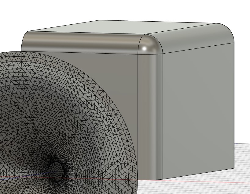

Was the same R18mm radius used on the cabinet edge as well?
No the cabinet edge is the same 36mm roundover that was used on the waveguide sims. The 18mm value comes from the fact the 36mm baffle would be laminated from 2 x 18mm pieces so chamfering one of them would be fairly easy.

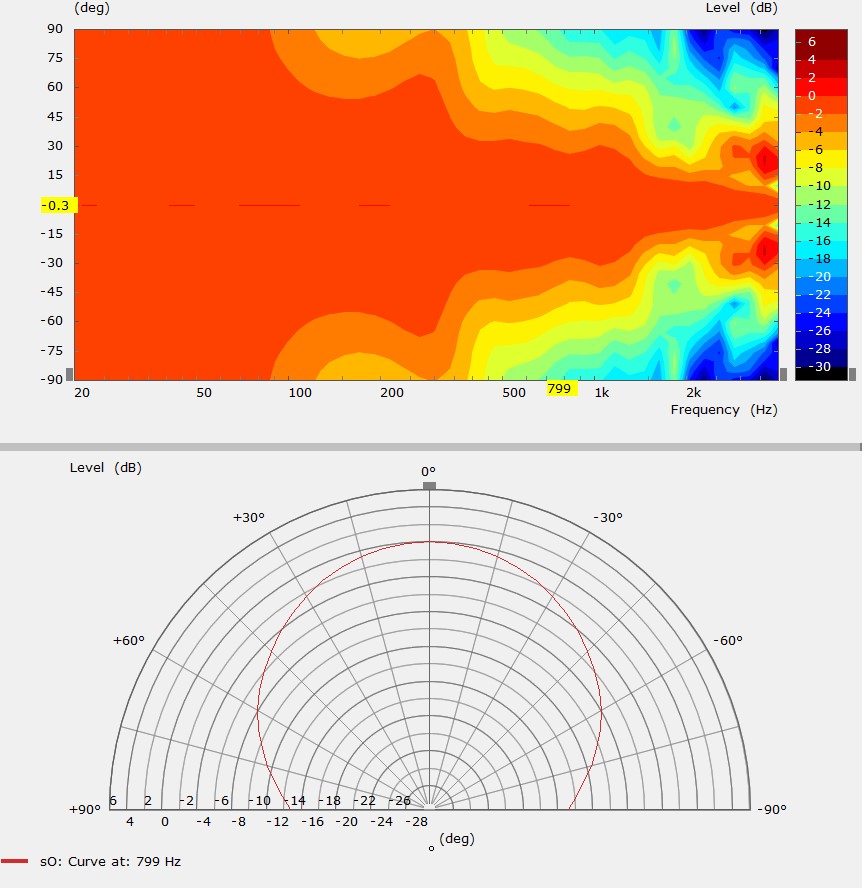

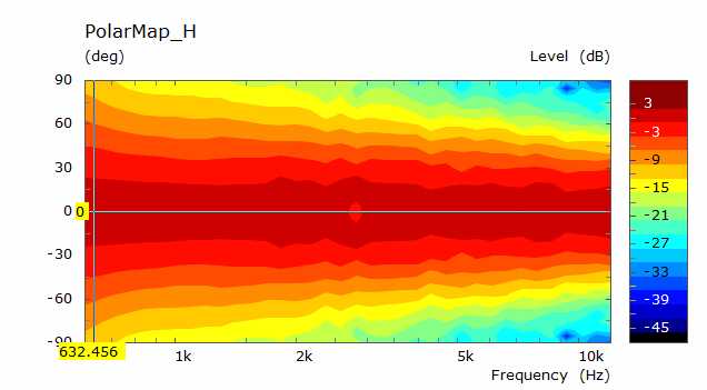

Here's a 0 deg normalized polar of the chamfered version which I think is the most practical option. 120 deg pattern at 800Hz to match the waveguide nicely.

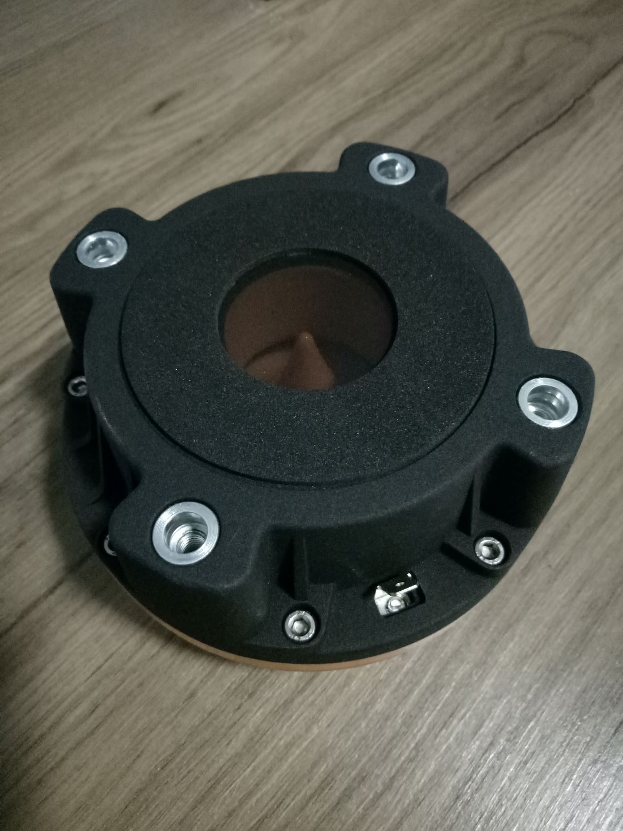

I've decided on a change in drivers from my original plan. I still have the HF146R's but I have now bought a pair of HF1440 drivers. These were always my first choice but seemed to be hard to get hold of at the time I bought the others. Anyway there was a pair in stock while I was browsing so they have now landed here 🙂

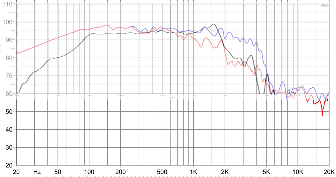

I've narrowed down to the Faital 15FH510 or 15NBX100. They are quite different in their parameters but model surprisingly similarly. The Faital is low Rms High Qms with less Le and a shallower slower rolloff towards high frequencies.
The 15NBX100 has a shorting ring and is flatter through the main pass band but peaks before a sharper rolloff.

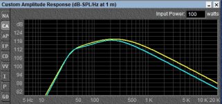

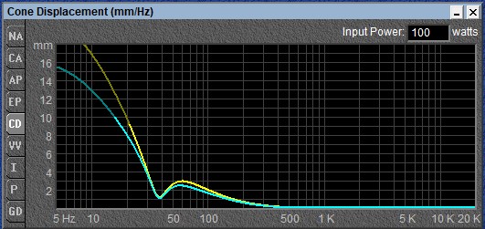

Hi, for home use I'd choose the one that does better smaller enclosure (model either, then use same box size with the other driver and compare simulated responses). My faital 15fh520 parameters are a bit of from the factory spec and requires even bigger enclosure than with the factory TS parameters. That said I'm having now some old Beyma 15k200 drivers on that require half the box volume for similar low end extension. There is of course difference in power handling for the 15fh520 benefit but that really doesn't matter with my home setup, I'm never going to reach the limits with either driver.
The drivers sound different "naked" ( no enclosure, no crossover ), but in my three way speaker application I'm not sure if there is any real difference other than the now lower extension with the Beyma driver. One could always use EQ and power for the extension as well but it feels silly to me to do it that way. So, TS parameters might not be too important, maybe check out the box size and if there is distortion graphs available. Best thing would be to buy them both and listen side by side. Have fun!🙂
edit. either of my drivers is fine, differences are small after all and are mostly due to room interaction. Faital has a bump in response (according to simulation) which is in the boomy region of my room, beyma doesn't and thus feels better in the room. I haven't done ground plane measurements so cannot confirm 🙂

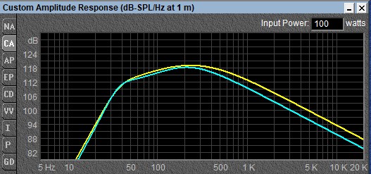

Thanks for the input. The bassbox sims above were with both drivers in a 70 litre (excluding drivers and port) enclosure tuned to 38Hz (yellow 15FH510 and blue 15NBX100). I narrowed down the choices to drivers that worked better in smaller boxes. The 15FH520 could go lower and flatter but wanted a much bigger box that I want to build.
I haven't been able to find any Klippel or distortion measurements of either, I would think that the B&C is better in that regard as it is one of their more premium models. Faital has the new 15FX600 driver which looks more similar but ends up costing the same. Of the Klippel results I have seen for B&C and Faital on other woofers, both are good but B&C do know how to make some extremely linear drivers.

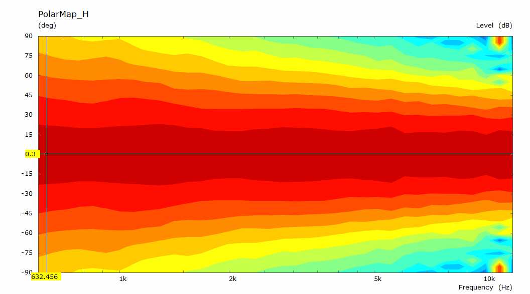

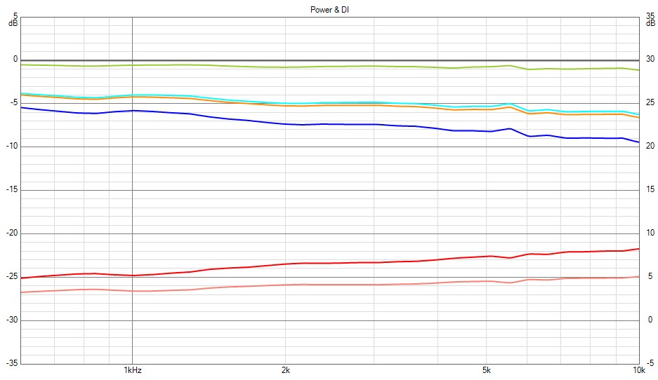

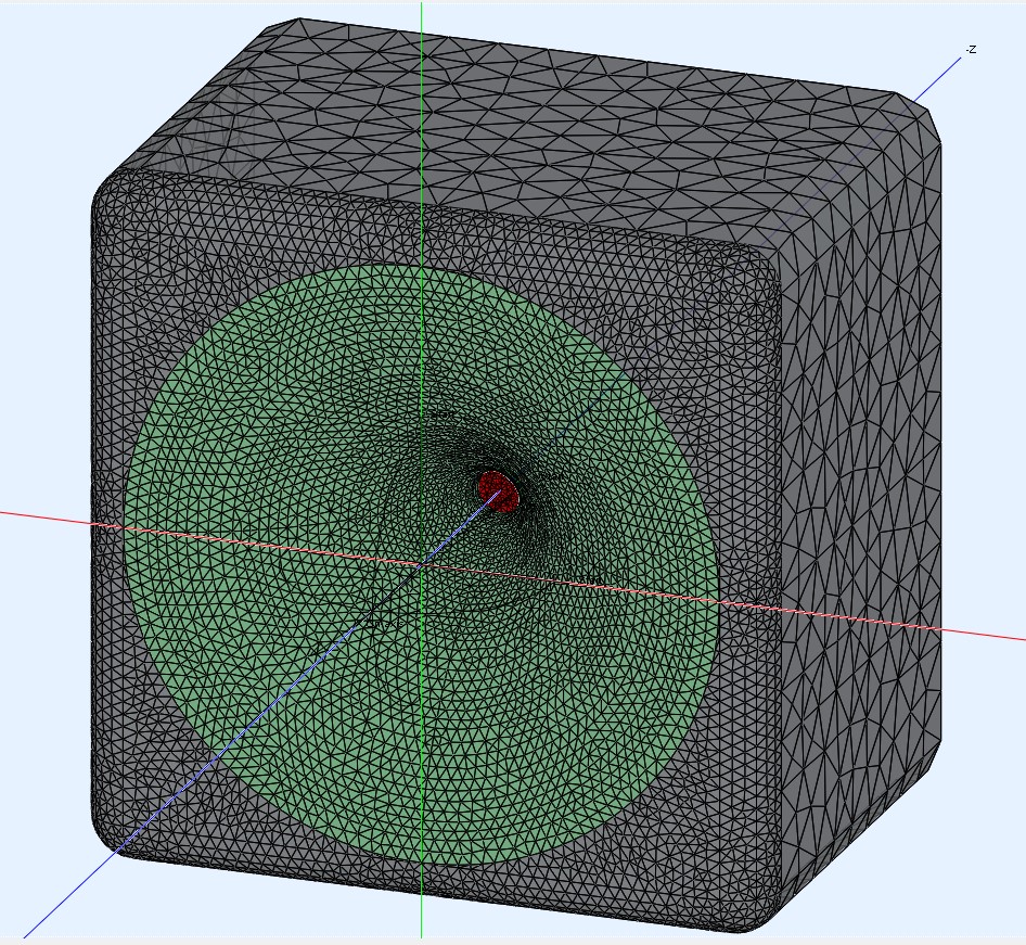

I've also been experimenting with a different type of curve that results in a very smooth on and off axis response with a slightly rising DI approximately 3dB / decade when in an enclosure. I have tried a rectangular version of it which looks very good in an IB but the enclosure sims had some issues which I have yet to work out. I made the enclosure shallower and this had a much more pronounced effect on the directivity between 1K and 2K than I would have imagined. Part of the same issue shows up in graphs below but at 1.2 - 1.5K. There is a bit of a mesh problem where the baffle corner roundover meets the rest of the cabinet which makes the response above 5K look worse than it should. I can fix that but this sim has a pretty high element count and takes a few hours to run so I'm in no rush to prove it to myself 🙂
attachment.php
attachment.php
attachment.php

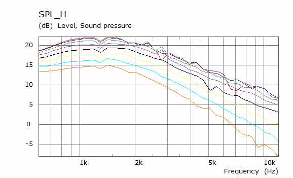

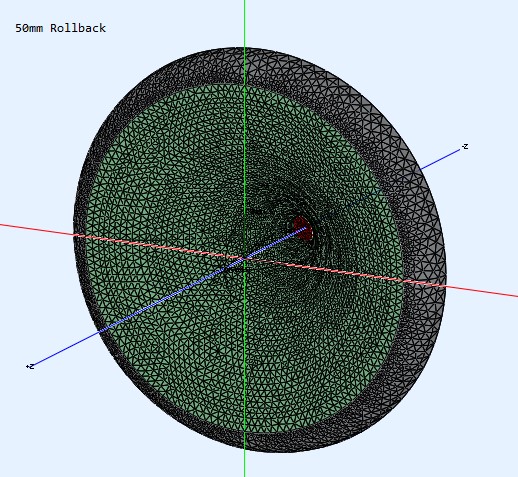

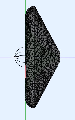

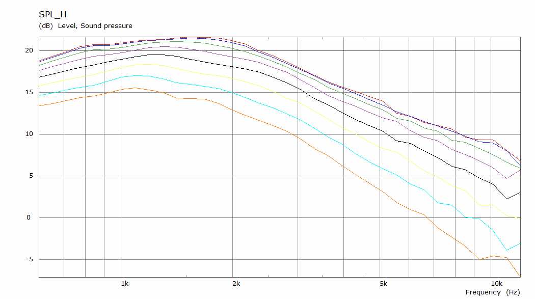

Here is a try at a Freestanding simulation using the same waveguide as before but placed into a 50mm radius rollback joined to a cone. The directivity is taken to a lower level than an Infinite baffle but not quite as low as the enclosure. The sim has some issues with numerical stability possibly from the interface / horn / rollback junction. The general idea can be seen but the random peaks and dips make it harder. Smoothing the sharp edge from the rollback to the cone would probably help too.

Seems to me that the glitches are just numerical issues - probably most of them, if not all. Try CircSym mode with high mesh resolution (~40 kHz), I think they will go away as they would on a real device.
- At least if the rollback is really smooth. It's hard to say from the picture.
I would agree, I don't have a working CircSym template as yet this is the first axisymmetric curve that has interested me enough to simulate it this way.
The rollback is a 50mm fillet but the junction to the cone is not smoothed.
