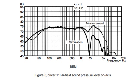

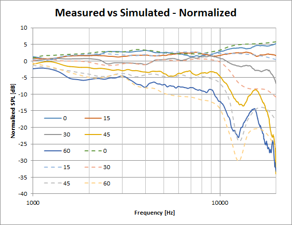

I think this graph (from the above linked thread) illustrates my contention that the output of these fairly simple simulations (in relative terms) is quite useful and pretty close to the mark already.
Below 10K the measured and predicted responses are quite similar and give a good idea of the directivity and potential issues allowing iterative improvements to the desired outcome. Above 10k and particularly with a dome tweeter all bets are off. But there are still off axis issues that are predicted at near the correct frequency if not quite the right magnitude.
With this speaker I am trying to build something that could be used successfully in various different rooms. Simulating a speaker in a specific situation and tailoring a solution to that specific case is a very valid route.

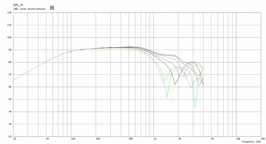

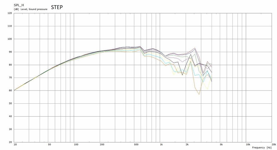

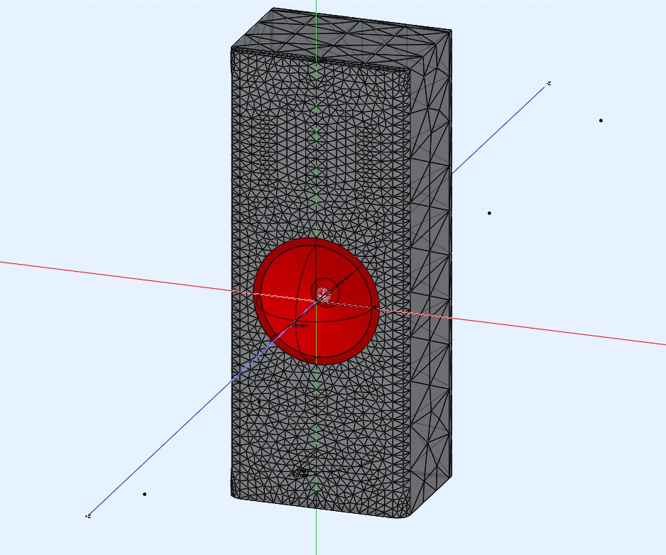

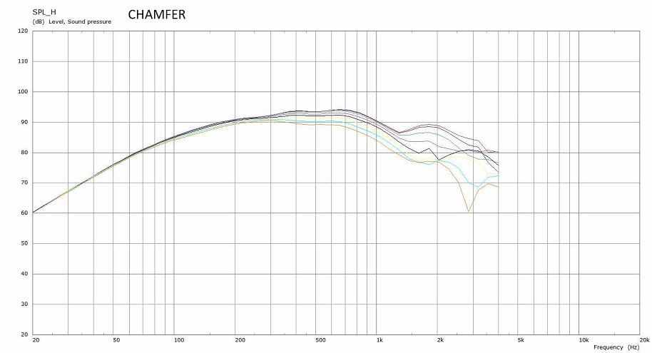

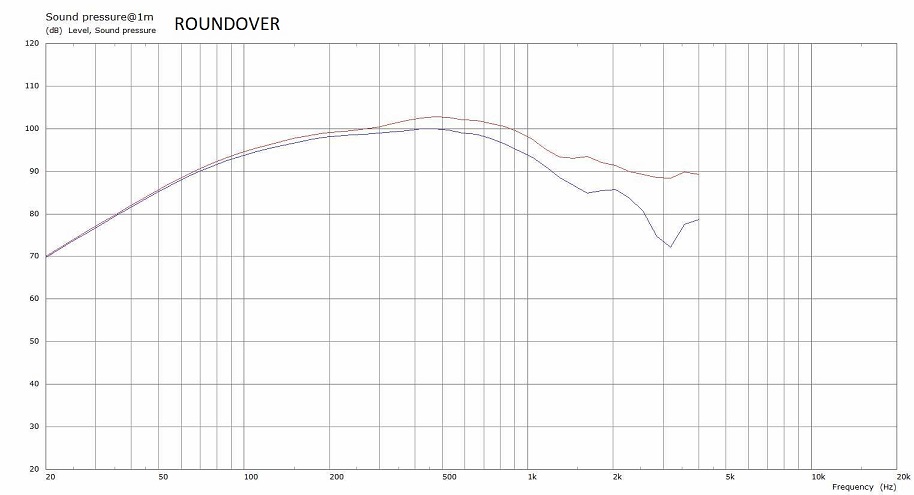

I have been working on woofer simulations with help from Don. It has taken a while to try and understand the results I was getting but I think I have something useful to work with now.
I have tried to represent the overall shape of the enclosure and have had to go to half symmetry. Fortunately simulating up to 4KHz, using a less detailed baffle and an Le Script meant the simulation times were very reasonable.
Two things affected the output from the simulator and to start with they made the results look pretty funky. The depth of the cone used for the woofer and the length of the rear chamber in the Le Script were the two factors. The length of the rear chamber created spikes in the response which can be removed by not specifying a length. Much like masking resonances in Hornresp.
The depth of the woofer cone was a guess based on the drawing in the datasheet and that also turned out to have done a good job of muddying the water. What this means is that the level of confidence in these simulations has to go down for now as I don't have the exact dimensions of the proposed woofer to make the simulations more accurate.
On the other hand what I was trying to look at was what effect did different woofer mounting methods have and I think the simulations answer that question reasonably well at least in a general way.
Any time the woofer is set back into the baffle it effectively looks like the woofer cone is deeper. A deeper woofer cone introduces a dip in the response so this needs to be considered carefully.
Don put me on to a paper by Joerg Panzer 'Radiation impedance of cones at high frequencies' which confirms that as the depth of the simulated woofer increases, the accuracy of the prediction goes down as frequency rises. The simulations of this sort of woofer depth are only reasonable up to 1.5K or so.
What I have simulated is the woofer in an Infinite Baffle. This gave the best response at the low end and the worst response at the upper end.
I have also simulated the driver mounted flush, set in 18mm with a 45 deg chamfer, an 18mm roundover and a 13mm vertical step. There is not a huge difference between the chamfer and roundover, most likely due to the limitations on the mesh making the two quite similar. Flush is impractical as the driver has a 13mm step up from the surround but it shows a worst case scenario for this situation. Diffraction off the edge of the basket.
I have attached some gif's to show the different simulations against each other.
1m On axis and 45 deg Horizontal
3m Horizontal 7.5 degree steps

Individual graphs of above plus IB curves
