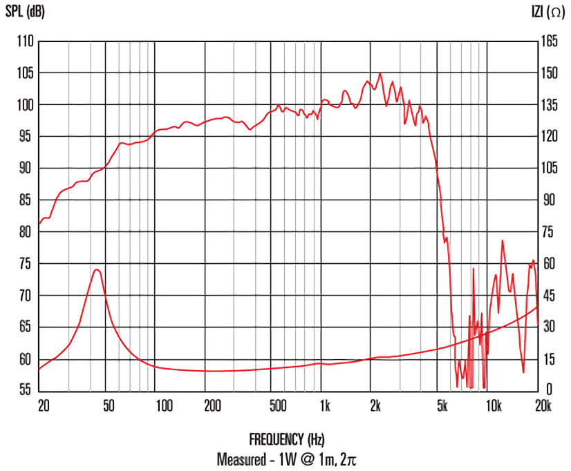

The 15NBX100 is more of a (sub)woofer than a midwoofer and in practice I have only encountered the NBX in subwoofer applications.Thanks for the shot of the Klippel results it certainly backs up 18 Sound's Tetracoil marketing information where they show very symmetric results. I did look at this driver for that reason, two things are against it the first one being a high Fs and the second was it not being easily available without a long wait. I'll put the figures into a box modeler to see if the high Fs is a deal breaker.
Do you have any data on the newer B&C drivers I don't see them being that much better than the 15NBX100 but they are quite a bit more expensive with even more ridiculous power ratings for home use.
There are 2 (main) issues:
- the heavy cone, heavy motor and suspension > needs lots of power, or rather: it's designed to withstand a lot of power/torture
- Le is high.
Some French DIY folks have tested the NBX and found it to sound muffled above 500Hz, which makes perfect sense, considering the parameters.

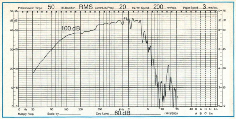

The 15NTLW3500 is a midwoofer, but I'd consider it overkill for hifi. It's well known that the best midwoofers for hifi are often the most basic ones.
One example is the Celestion FTR15-3070C, which handles bass and midrange (up to ca. 1200 Hz) equally well. According to 2 leading German DIY magazines it's one of the best measuring and sounding 15s ever, regardless of the price.
It is no coincidence that the response of my own woofers is similar:

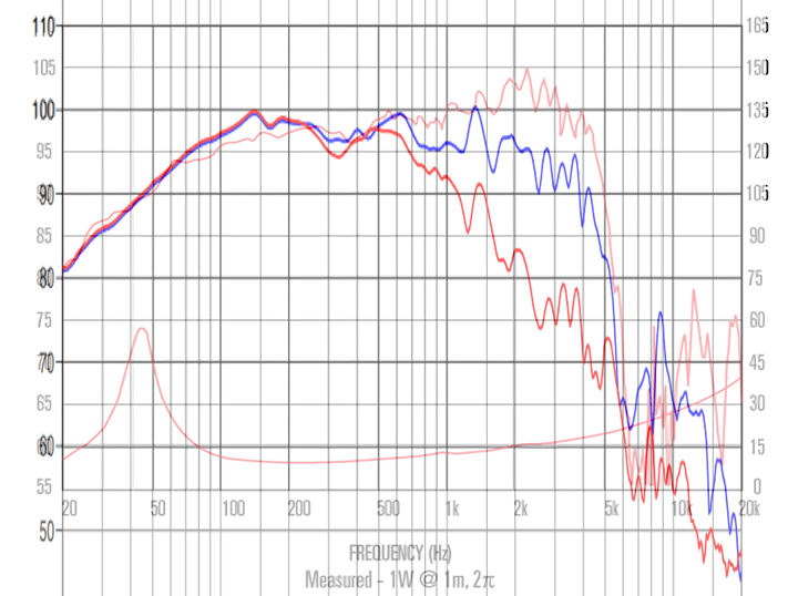

Very similar to the 15FH500 drivers that I bought (at least in the intended frequency range) too when the scales are the same 🙂
Indeed, similar. The 15FH500 is a bit more heavy duty (motor + moving parts) with lower Fs and subsequently higher Xmax and higher Le.
I'd use the Faital below and the Celestion up to 1000Hz as indicated by the first impedance ripples. The Celestion needs a larger cab to go low.
