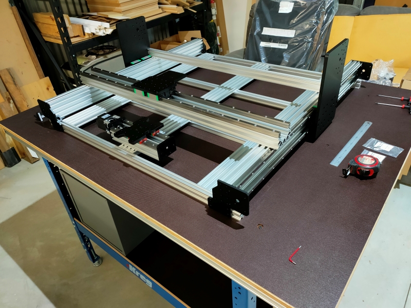

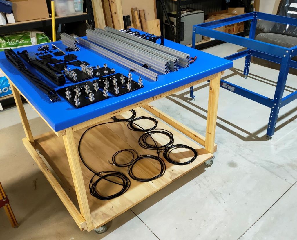

The old CNC came apart much easer than it went together and I now have a nice assembly table 🙂
attachment.php

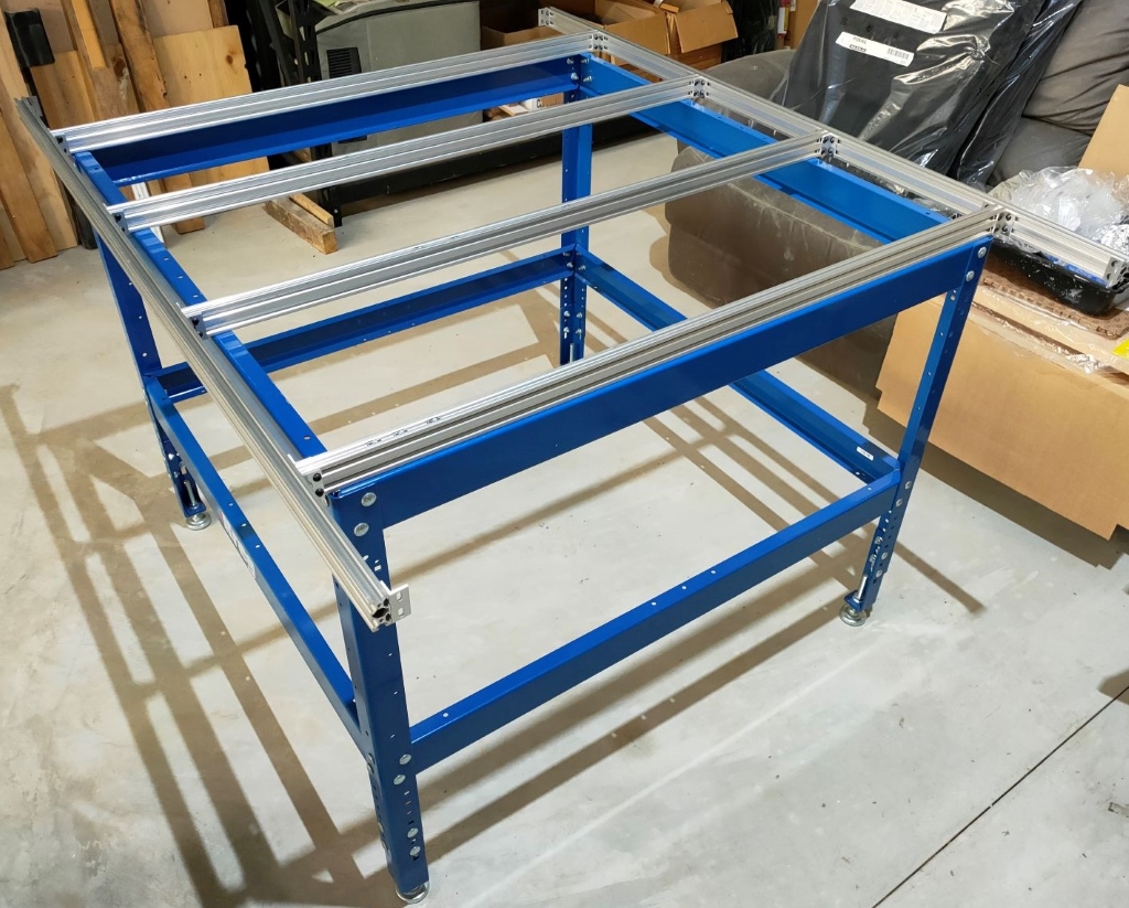

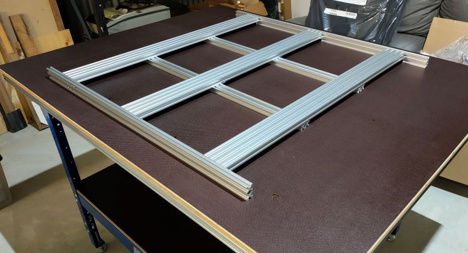

New base frame is taking shape, non ferrous blades really do cut aluminium nicely
attachment.php

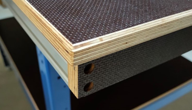

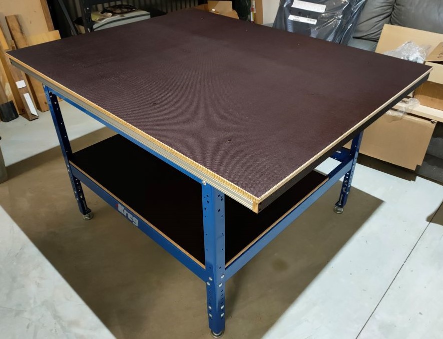

The new table top is now completed, this is much better and considerably lighter than the previous try.

New spoilboard supports are much stiffer and better braced than before

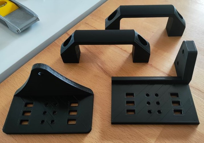

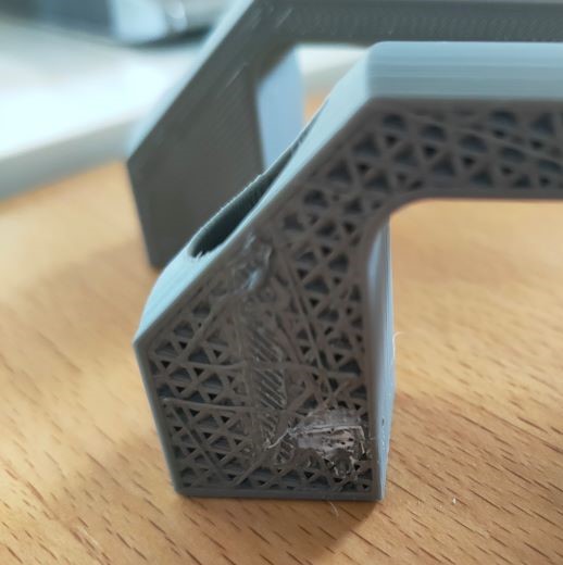

Some functional parts have been 3D printed, drag chain mounts and enclosure handles
attachment.php
I can see why ABS is tricky. Almost at the end of this print something went wrong and a lot of spaghetti was the result.
attachment.php

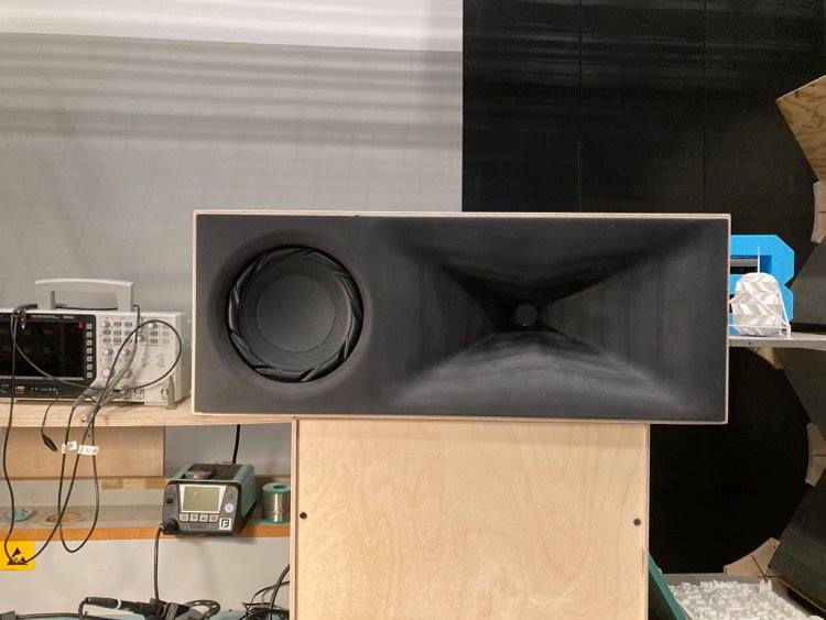

I made a pair of speakers that will be wall mounted in a low ceiling apartment.
And due to the placement they could only be about 25cm high.
I'm not a fan of horizontal speakers, but this was the only option.
I'm not sure the Purifi drivers are ideally suited but don't let that stop you from trying 🙂

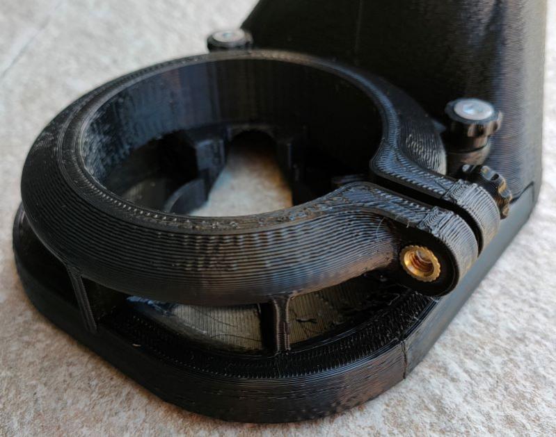

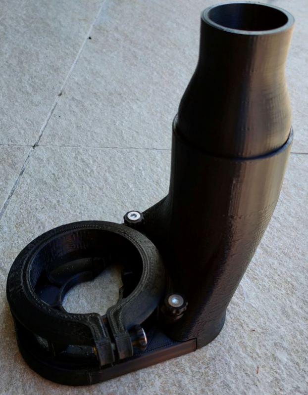

Progress is happening if slowly. I found a nice dust shoe to print for my Makita Router, waiting on a brush strip to arrive to see if it fits the slot as the one it was designed for is impossible to get here.
Printed very fast with a 0.3mm layer so the finish is rough but the parts are strong.

Did you not want to try porting the woofers into the horn? Seems like it would have been a good application.
I did, but my friend who ordered the speakers wanted good punchy bass...
I feel like the bass from taps isn't as punchy and doesn't extend quite as much-
Unless the taps are very big which would degrade the performance of a small horn like this.

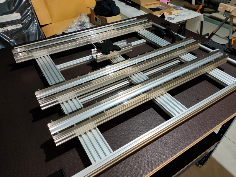

Progress is in slow motion, Linear rails have been installed, 3D printed dust collection boom parts visible on the right side

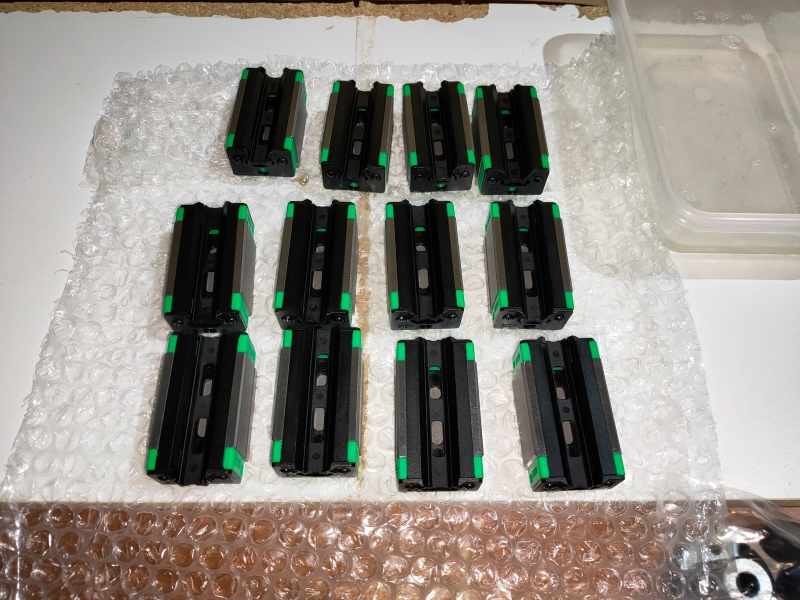

Bearing blocks cleaned and greased, this was a real time drain

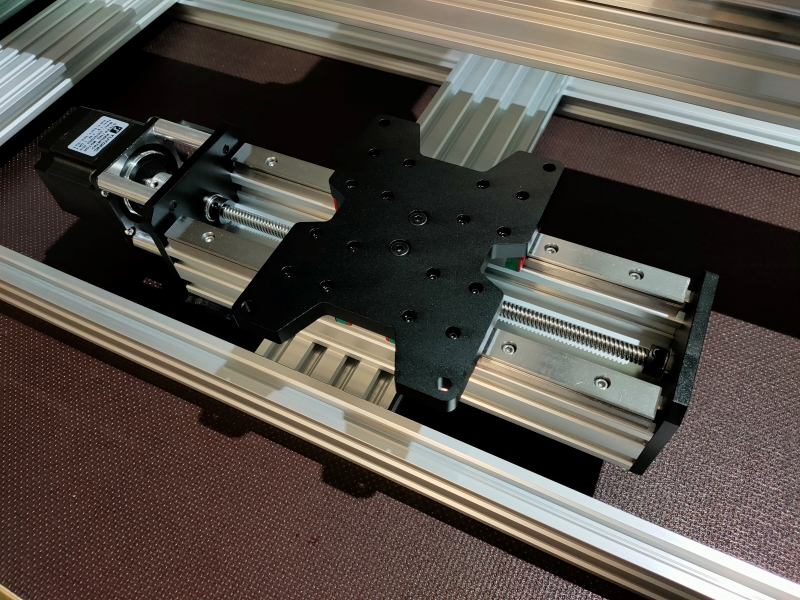

While I have been having some fun with 3D printing I haven't forgotten the CNC. Fairly close to having the mechanical setup completed. Getting the lubricant for the bearings and rails proved to be difficult. Standard amber lithium grease caused the small guides to grind to a halt. Slickoleum which is used in cycling and motocross for fork seals turned out to be the right consistency and viscosity to make the balls roll instead of drag in the races.
