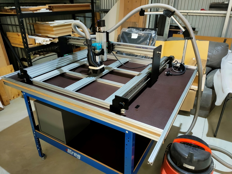

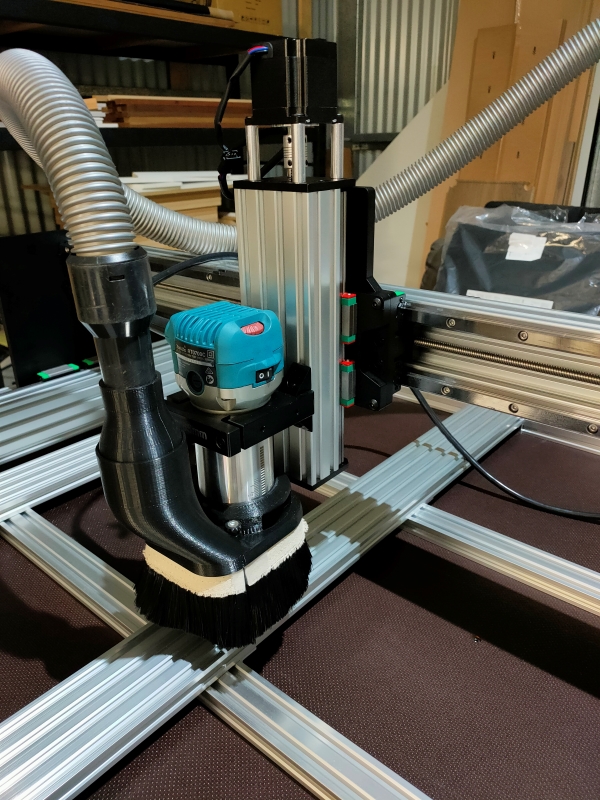

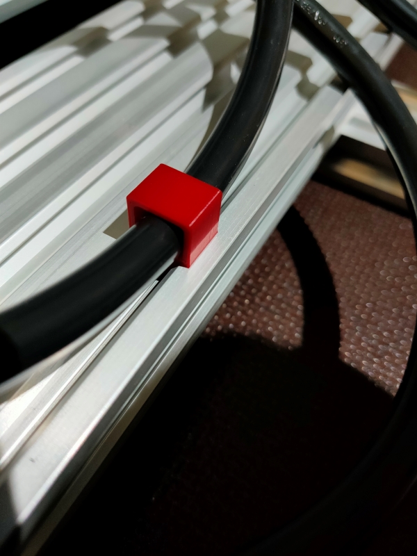

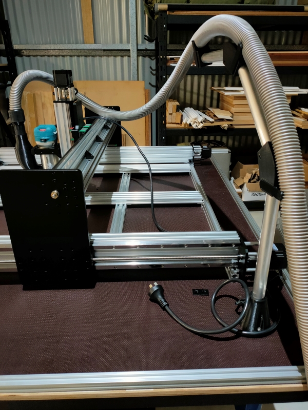

The images in my last post seem to have disappeared so here they are again with a few new ones for the Z Plate Mounts and Power Cable Clips to route the router power cable along the X axis.

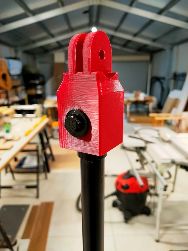

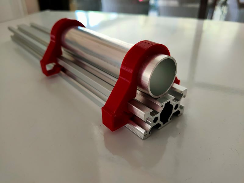

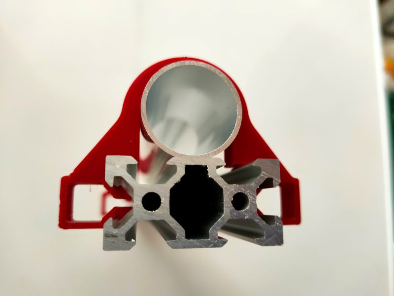

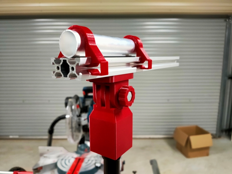

I've been working on a microphone mount to use a tube behind the mic to avoid reflections. The bottom mount attaches to a 3m lighting stand which is much more heavy duty than most mic stands and it came for free as the music store couldn't find it in their system so they gave it to me 🙂
The other half of the mount is bolted into an offcut of 2040 V slot extrusion and the tube is fixed with a piece I designed incorporating the cable clips to hold it in place. The tube in the images is just an offcut test piece the real one will be 2m long.

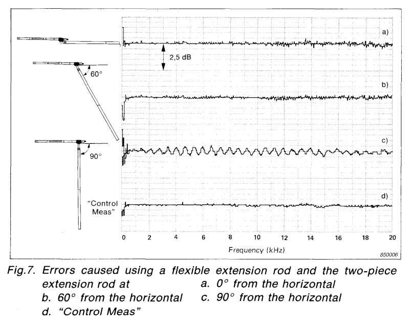

This is pretty cool, but it’s quite bulky in itself and the mic is still pretty close to the upright part which is one of the main issues (other than the clip) that I took from their report. Have you read the B&K paper on mic stand reflections?
I recently did a bunch of work in a hemi-anechoic and found that my Manfrotto nano stands were far better than a typical mic stand for reducing reflections. They're quite stable with the legs folded out flat too, so I was toying with the idea of making a contraption to dangle the mic from a wire to really get the stand influence out of the data.
In practice I just ended up hot gluing some leftover bits of acoustic foam to the whole stand though 😁
I don't know if you missed this part or it didn't make sense?
The mic will go inside an aluminium tube which will be anywhere from 1 to 2m from the mount. I don't think the mount is that bulky given how far away it will be from the mic. I think the most interesting picture from the B&K measurements is this one as it shows the negative influence of the 90 degree mounting. I have some felt off cuts which I use in my current measurements to reduce the influence of the mic mount. I will most likely use more over the mount and 90 degree section unless it turns out to be unnecessary.

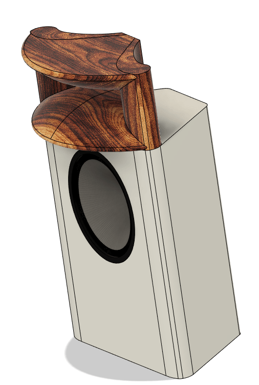

Hardly any progress has been made in the real world towards making the CNC functional, but in the land of make believe and wishes an interesting idea has emerged, the look of which is growing on me greatly.
I have been involved in some group work with docali and DonVK that stemmed out of a Yuichi A-290 simulation I tried and tacked onto the work they had been doing with different horn curves. I intend to create some separate threads with more details but one very promising candidate has emerged that simulates very well indeed, given that it is still using a 2" source.
I very much like the idea of making something K2 inspired in looks. While it's bigger than I would like at 610mm wide, I could happily stare at it in the living room. The render is missing fins and a throat adapter, but the general idea is there.
I have parts for a second system and I think that will be a freestanding OSSE variant, maybe mabat's CE360 with BMS 5530Nd and 12PR320 in a passive or active cardioid mid enclosure.
