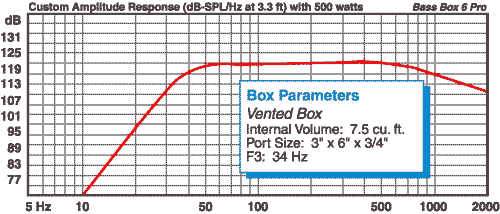

If you have the room...
This looks like it would do really well for a large outdoor setup:

I take it those drivers you mentioned yesterday are not meant for outdoor use. Still, I wonder how they, or even car subs would work outside if they were in a sealed bandpass enclosure. (I admit I don't know a thing about bandpass enclosures, but it looked like a possibility.) One must also be curious about horn loaded car or home hifi subs, but I don't think car subs could ever achieve the sound quality I want anyway.
As for pro subs, another one with good specs at Parts Express is a $75 Eminence 200W 18", it has a 7mm Xmax, goes to 25Hz. It's #299-716. The Dayton one has more power handling, but the Eminence has an extra mm of Xmax. Lower Vas than the Dayton though. It looks like I'll have to choose between those 2. Nothing else pro comes close. What gives lower distortion, rubber surround or accordion surround? The Eminence has a rubber surround, the Dayton doesn't. Does it make a difference?
Here's something else, 292-774, it has a way longer Xmax (12mm), but it's not as efficient and has a dual 2 ohm voice coil. Maybe I could make some separate powered subs with these for like 40Hz and below.

What I'll probably do is get some Eminence 18s, they're only $75.88 each, and I'll be buying lots of them, so maybe there will be a bulk discount, and they have a 7mm Xmax. These will be horn loaded, if I can find plans for a horn. I'll then get maybe 4 Audiobahn ALUM12Xs for sub bass, and build bass reflex enclosures for them and cross them over at about 50Hz.

Eminence 18"
The Eminences from Parts Express are a buyout product which were originally used in the Definitive Technology flagship speaker - the BP3000TL.
