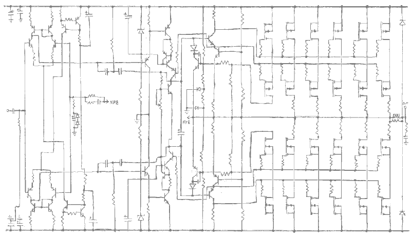

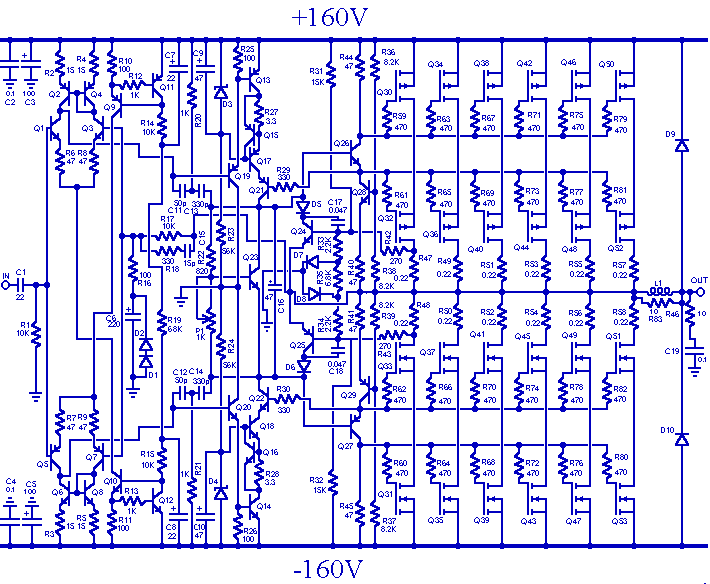

As far as my project (it's my thread), I have come up with some arbitrary component values (actually, I calculated to the best of my limited knowledge, and I still have no CAD software) that would probably work, but there might be room for improvement. I have also altered the protection circuit and removed the sense resistors from all but one set of outputs, as they should all have about the same load on them and I feel there's no need for more resistors. Also, with that protection circuit, I'm not quite sure how to calculate the values of R35 & R44, I want it to start operating at about 6 ohms on the output, so I may need some help there. I would like to achieve a slew rate of about 90 or even 100V/uS, and I don't think it can quite do that now, I might need a little more tail current, but It needs to be stable too. There might also be some question about the way my OPS and VA tie together, it's a little wierd. What do you all think?
I'm still deciding on transistor values, but MPSA42/MPSA92 looked good for small signal. Outputs are IRF240/IRF9240. Any transistor recommendations are welcome. The most common ones can't handle my 160-170V rails.
I'm sure many of you can offer some great insite into the design of my amp.
P.S. I have no idea why the text turned out purple, it's black on my computer. ????????

Did you attach a JPG or a GIF? If it's a JPG, the compression type will smear like that. If you email the original (big one) to me I''ll try and correct it / sharpen it up and size it down. I know some tricks.
There's a small freeware CAD program a couple of others on the forum have suggested, but I don't have it on the laptop I'm on now, or I'd see if I can clean it up.

Does anyone have any insite on my schematic here? Djk? I heard you were a schematic design guru. Does anyone think this thing could possibly be close to something that will work?
There's alot of you that I haven't heard from in a long time. It seems almost like some of the smartest people on this forum tend to ignore any threads that have the name "Kilowatt" in them. That hardly seems fair, but I refuse to change my alias just to get design help. Maybe I'm just being paranoid, I hope so.
Anyway, I'd just like to get my circuit figured out, and I confess to not being quite smart enough to do so by myself, at least not yet.
