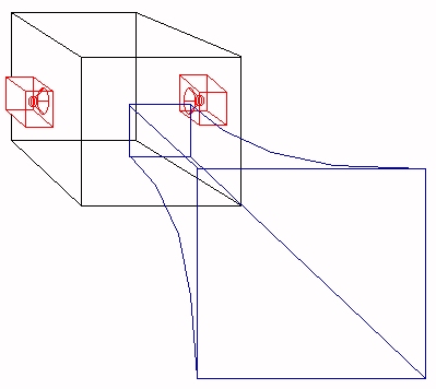

What if I built an enclosure the size of an automobile cabin, with a vent going into an exponential horn, and the subs mounted in boxes built into the side of the enclosure, something like this. Would that work well? (Of course the sides of the big enclosure would be made out of lexan so everyone could see the beautiful excursion on those subs!😀 )
Sweet.... would certainly decrease the amount of EQ needed and apart from the fact that you'd have to run the drivers on either side of the enclosure electrically out of phase (actually that's a good thing from distortion point of view) you'd lose 3dB because not all drivers are mounted on the same panel but you'd probably gain more than 6dB from that configuration.... I say Go For It! Now I cant wait to see this in stereo ....

Pardon ?.and apart from the fact that you'd have to run the drivers on either side of the enclosure electrically out of phase

OOPS! sorry about that. I just realised the error 😀 i'm not thinking straight at the moment (I had a 4 hour Maths exam today). All drivers should be wired same phase. Thanks for the head's up MrFeedback.
Inverted Drivers Not
Hello AudioFreak,
Forgive me if I am wrong, but my understanding is that to cause an output from the horn, the drivers need to be electrically in phase, so as to cause a net compression or rarefaction in the cavity that supplies the horn.
If the two drivers are electrically out of phase (inverted) then there will be no net compression or rarefaction in the enclosure, and no net horn output.
Quite simple really.

The horn at the top of the page won't work. You want a very small, not large enclosed cavity (throat). the energy output by the drivers will dissipate in the large enclosed volume and dribble out the horn appendage, which won't provide any acoustic "gain".
Look how an expert (Tom Danley) does it with a pair of 12" custom drivers. These are designed to be used as half space loaded horns in groups of 6 a side and put out 149dB.

The flare is truncated because it's designed to fit standard truck pack dimensions. Build it as it is, and then add another flare till you reach full mouth size, at a rate of double the cross-sectional area every 26"
This is probably the best large capacity bass horn in existence, driven by a magnetic motor. When I can get the motors, I think a pair (eq'd flat to 20 Hz) would be fine in my living room.

Hey that's that LAB horn everyone was talking about. It's nice to have plans for it. The explanation of why I need a small cavity seems reasonable (I should have thought of it myself). How big should it be? Would it still do what I want it to?
