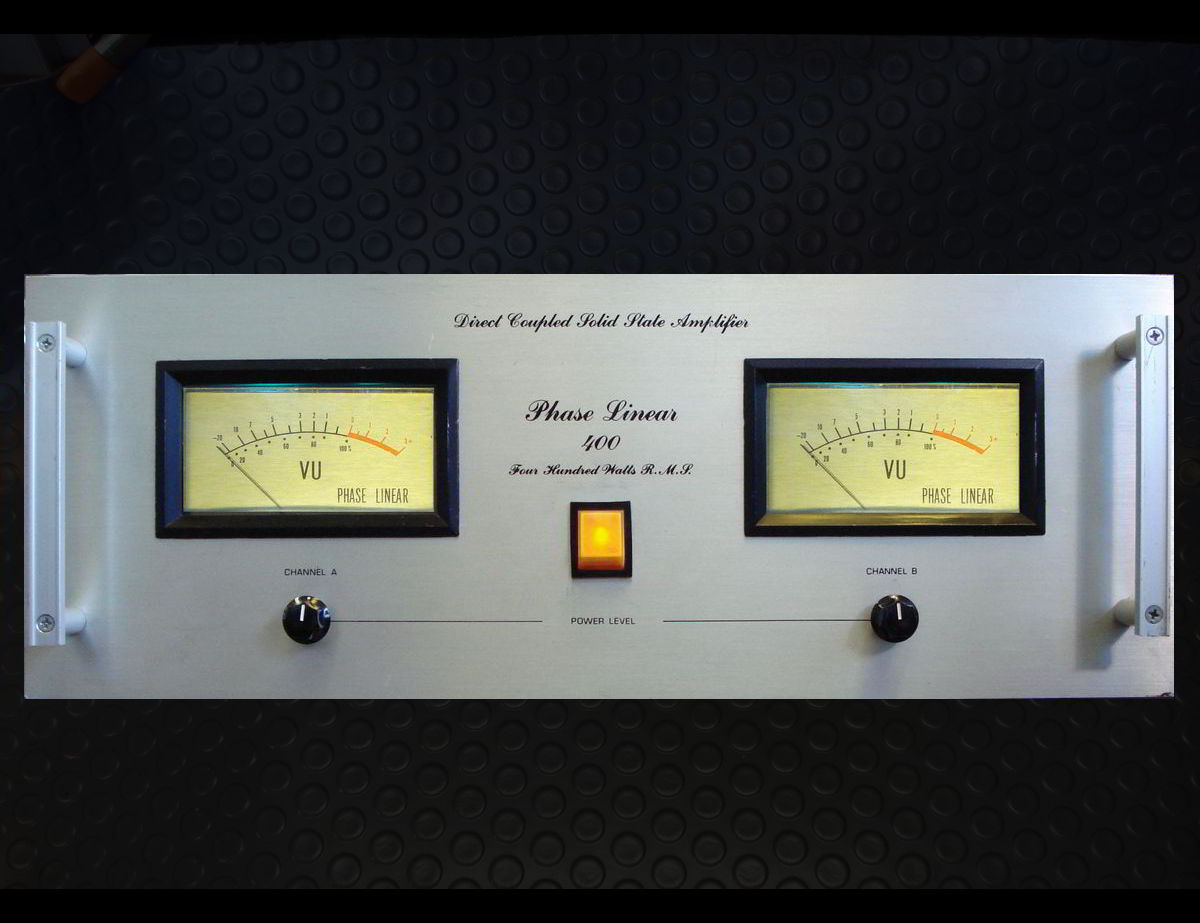

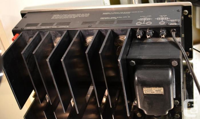

I've bought three or four Phase Linear 400s, with an eye towards refurbishment. They have a good power transformer, a good heatsink arrangement, a good chassis. All they need is a modern design using modern parts, to really shine. 200 RMS watts/channel for $1 per watt (1978 dollars). How hard could it be?

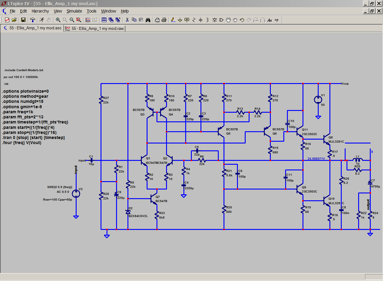

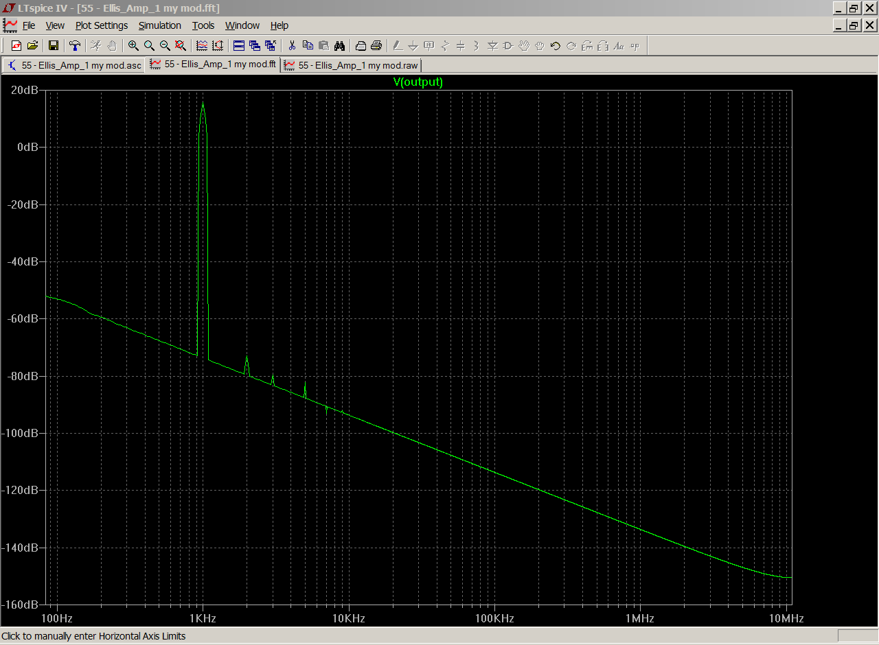

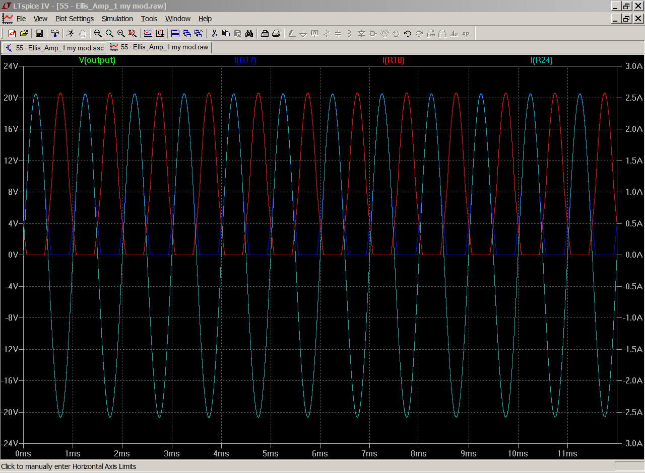

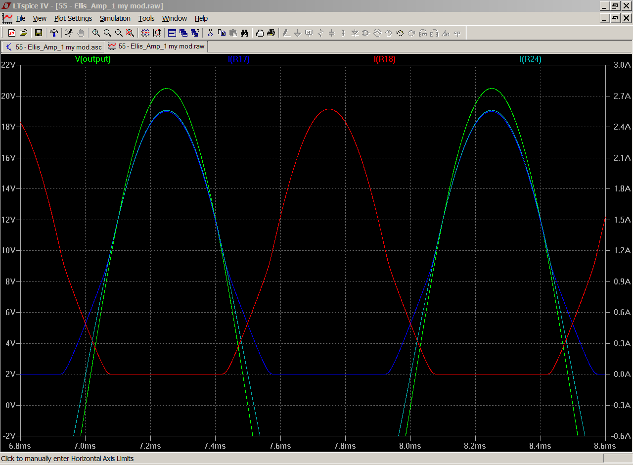

Can this circuit work in AB mode with high bias? If we keep the bias at say 800ma , can it give up to 10 watts in class A and then slide nicely into class B? How bad are the Distortion products in class B?
Dear friends,

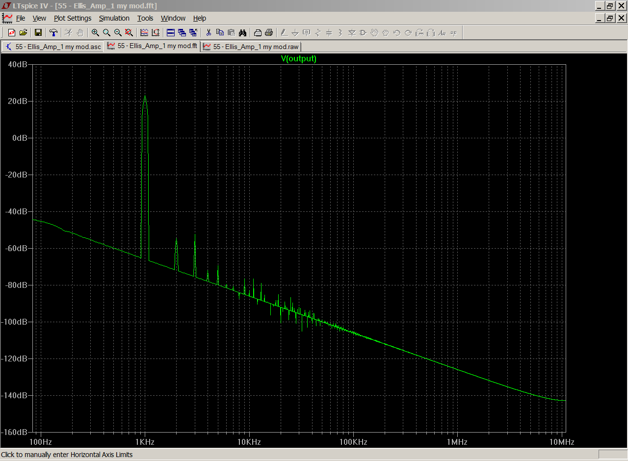

I fooled around with LTSpice. I slightly changed the circuit to my preferred mod (Retro) with bias current adjusted to ~500 ma on the outputs. In class A, the circuit can give ~1 amp into load. As I increased the input voltage, the currents increased up to 2.5 amps (Five times) just before clipping. The Voltage output to LS is about ~40 Volts, peak to peak, with just a little increase in Distortion. Please see the pics attached. Where did I goof ?
--gannaji

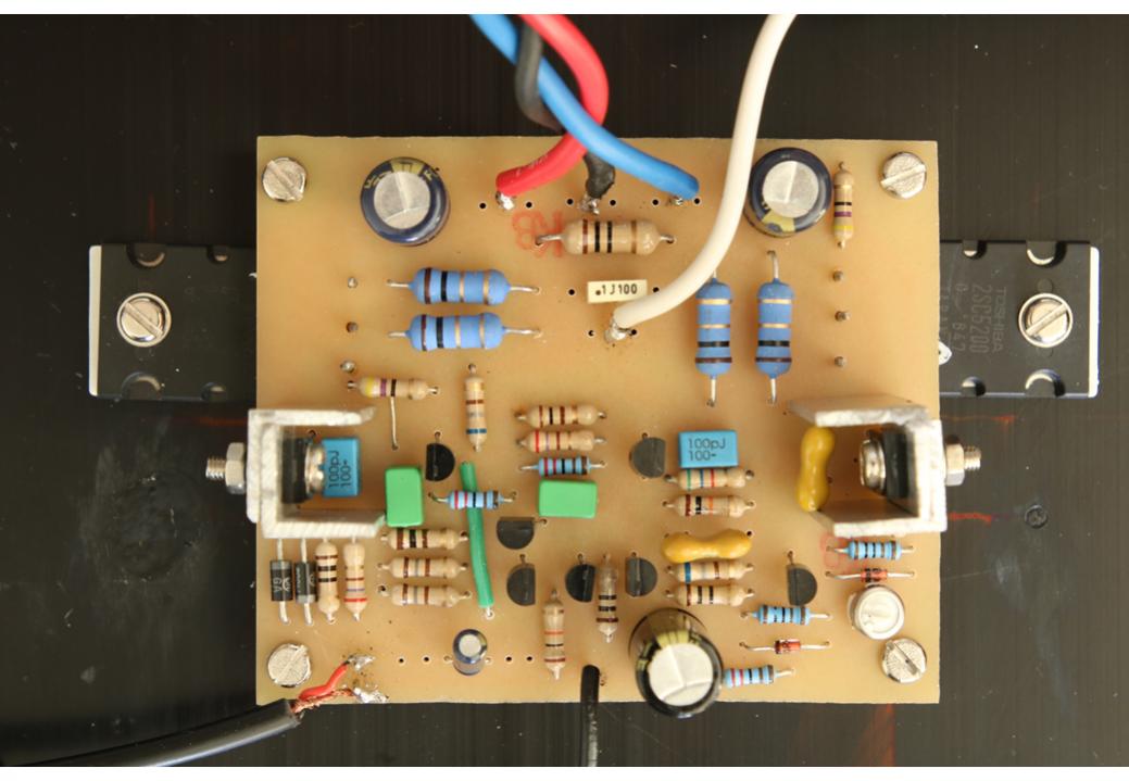

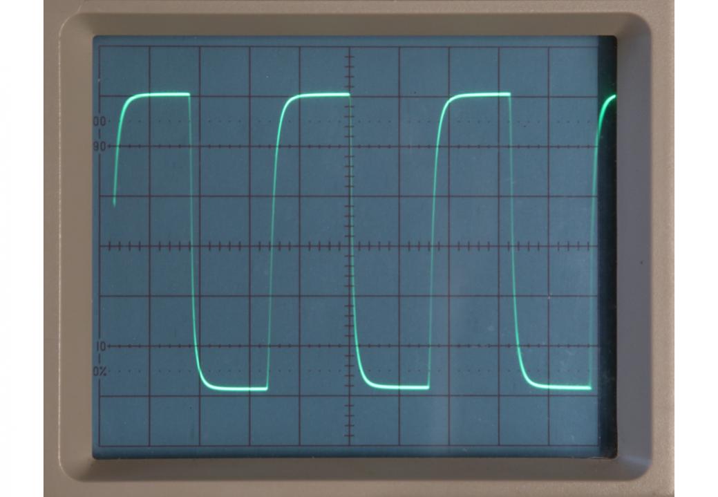

As mentioned I have now got some updates. I have completed a PCB laid out by Prasi, and this seems to work as well as the prototype.
While investigating stability of this it seems that the original choice of capacitor for rolling off the gain gave a rather low gain margin, though the phase margin was OK.
I have correspondingly increased the 100pF capacitors (C2, C3, the ones at the input stage, not the output stage driver capacitors) to 150pF.

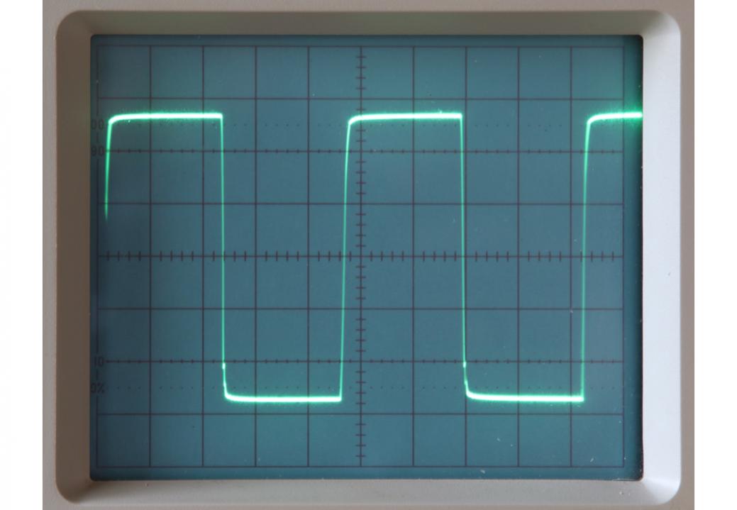

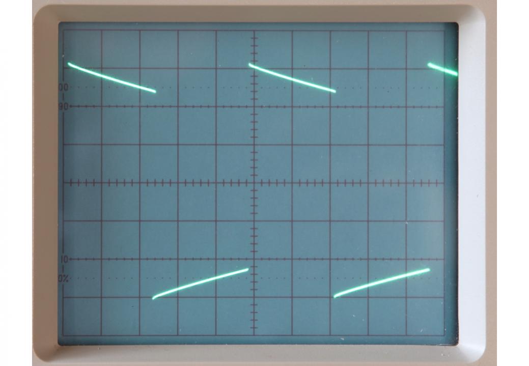

A Tian probe plot showed that 20dB gain margin could be achieved by further reducing the feedback capacitor from 22pF to 15pF. But square wave testing showed slight oscillations (well damped) in 20kHz square wave testing. This was put back to 22pF and shows better results (50kHz square wave image).
The low-power bandwidth (about 1W) is from <5Hz to >700kHz.
Distortion at 25kHz is measured at .005%
It seems this circuit will need a little more work on stability margins. but seems to be working well. Have tested with speaker but not tried excessive testing as that is too loud.
Note that Prasi's original circuit layout has a missing link, which has since been corrected. (Tr7 base to Tr1/Tr4 collectors).

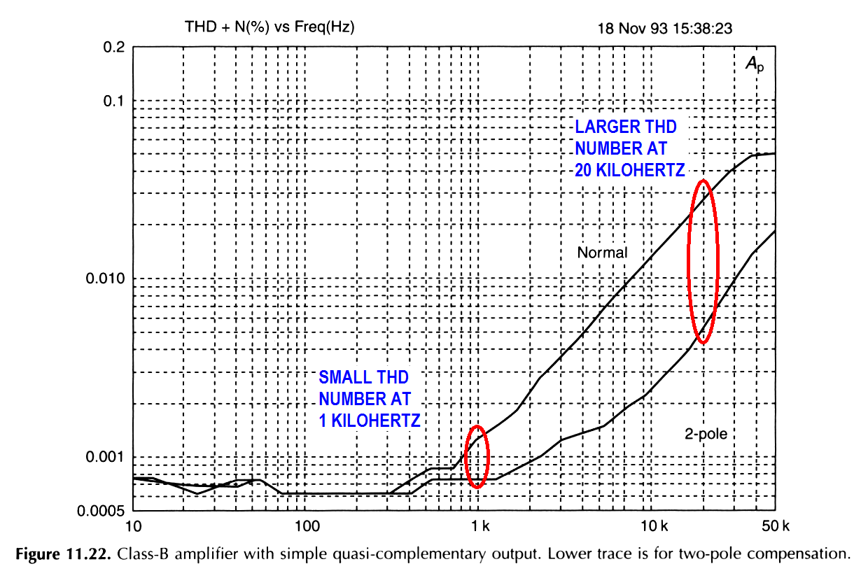

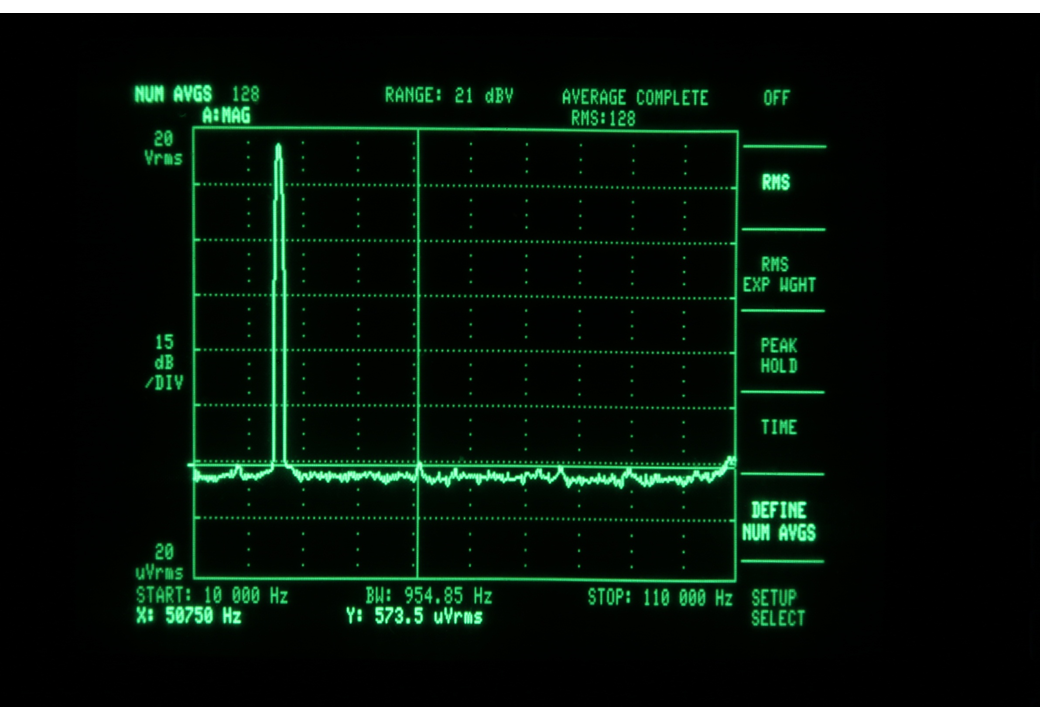

Both Douglas Self and Bob Cordell emphasize that THD @ 20kHz is a much more sensitive test of nonlinearity, as there is less "available NFB" (another way to say there is much less excess gain) at 20kHz than at 1kHz. Image from Self 6th edition attached below.
BTW your scope photo #3 might indicate some kind of a calibration issue. If indeed it IS a 50 kHz square wave, then 1 complete period of the square wave = 20usec = 3.2 horizontal divisions, therefore the horizontal sweep rate is 6.3 microseconds/division ?!

People typically set their THD analyzer to its highest available bandwidth when measuring THD at the top of the audio band. On the Audio Precision analyzers that's 80 kHz bandwidth, which just barely includes the 4th harmonic of 20 kHz. So most folks only measure AP-THD up to 20 kHz.
