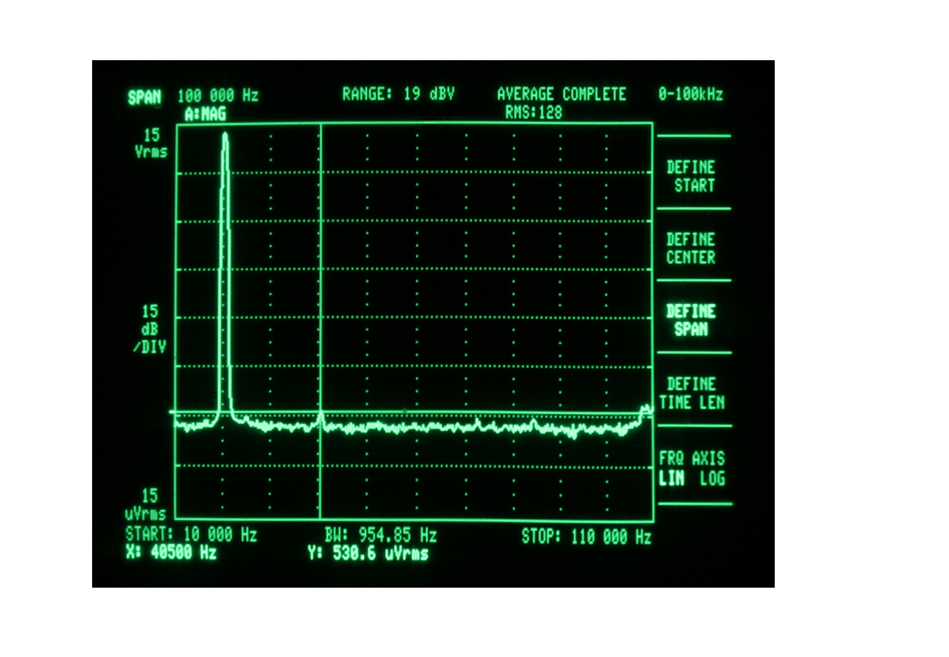

I swapped the heatsinks over. The transistors were not MJL3281A's as I thought but 2SC5200's. Similar performance, high frequency linear gain. I took no chances of oscillation and added the 100pF capacitors.
Screen shot of 20kHz at 10.3V rms- second harmonic distortion at 550uV. That's 0.005% pretty much in line with predictions.
But so similar to the 2kHz response I'm wondering if my oscillator distortion is a little high ...
A good job Prasi added the pot. as the quiescent current was slightly higher than the 2N3055's at 1.6A, creeping towards 1.7A. But did not seem to be problematic,stabilising, but will check again later.
