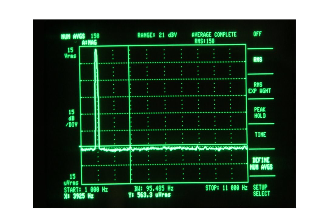

If I had an AP analyser I would also use 20kHz to measure the distortion. With the old analyser I have, I set it to 100kHz bandwidth. Which means I can measure up to 4th harmonic of 25kHz. That will be slightly more sensitive to distortion as the loop gain will be a little less than at 20kHz.
The bandwidth in the display is the narrow band used to measure individual frequency ranges between the set limits (here 10kHz-110kHz). I could get a finer frequency resolution using a narrower bandwidth but the measurement time would extend.
Regarding the "50kHz" image the timebase on the scope is 5us/div. That makes it about 62kHz.

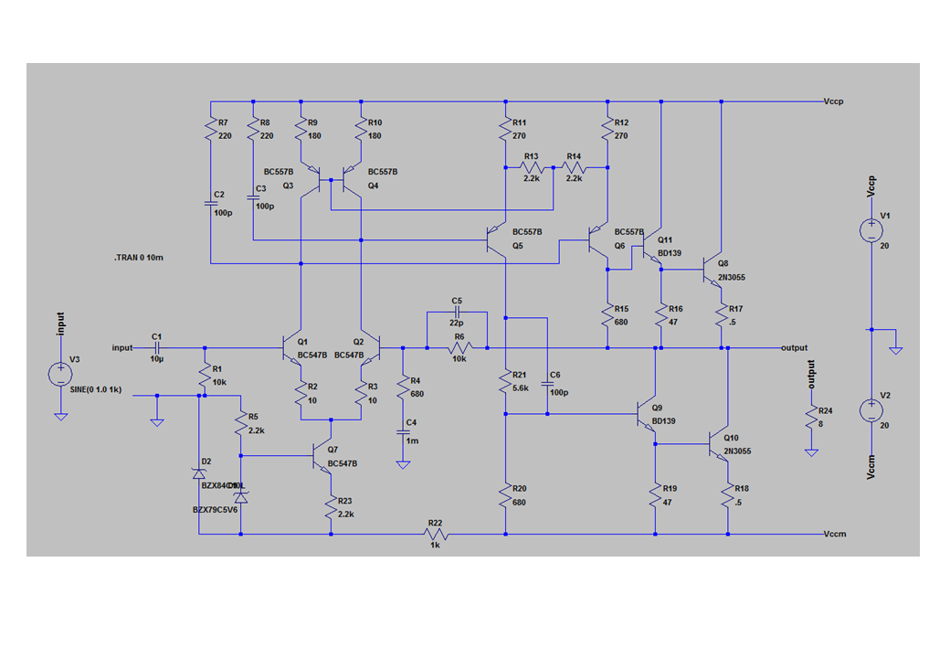

Have you tested the amplifier on square wave input at 10kHz with a low value capacitor in parallel with the load. I have updated my .asc file and the prediction with as little as 10n was not pretty.
...Where did I goof ?...
What "goof"?
Your sim makes perfect sense. Biased at 0.5A you can get near 1A 8V peak in class A, and push into class AB to about 20V 2.5A peak. With the large 0.5A idle current there will be little change in THD as you transition A to AB.
What "goof"?

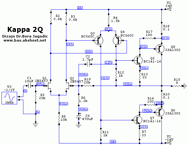

Thank you dear PRR. It will be a good candidate for assembly ! Shall wait for final tweaks from John !
mjona - I do not see instabilities in my simulations using 2SC5200 output transistors with 100nF capacitive load, but there is a slight overshoot on leading edge. I do see oscillations with TIP3055.
I'll measure the actual amplifier tomorrow.
The characteristics of the speaker cable are not included in the simulation. If you have a small overshoot it could be the simulation is wrong or the cable plays some part in the cause of stability. I did not see any output coil.
I persevered with the simulation re the residual overshoot. In this your input low pass filter does practically nothing to spoil the square wave shape. You could increase the value of the capacitor in the filter to see if you can get rid of the overshoot.
