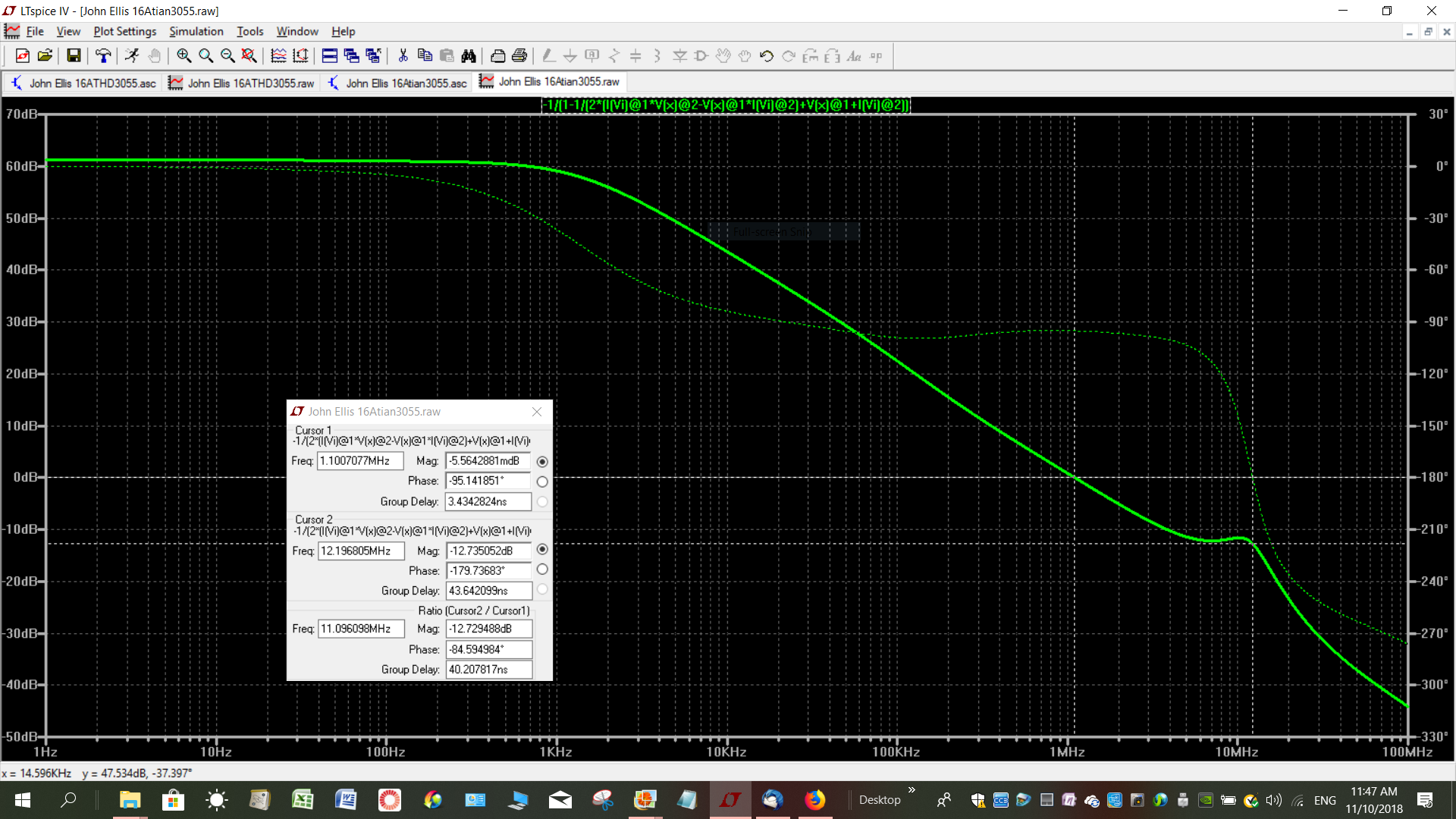

I can't quite tell how to interpret the frequency response plot in post #33.
It appears that the "gain" curve crosses below 0dB at 10 MHz; I hope I have that right.
Is "10 MHz" the raw amplifier circuit's open loop bandwidth from input to output, when the feedback divider network (R6-R4) is omitted?
Or is "10 MHz" the bandwidth of the amplifier AND feedback divider network (R6-R4), all around the loop? If so then the raw amplifier all by itself would have an open loop bandwidth 15.7X higher, namely 157 megahertz. That would be a remarkable achievement using 2N3055 devices.
(R6+R4)/R4 = 15.7

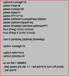

Would you mind checking my Tian Probe settings I am getting more extreme results than these - see attachments. The Tian Probe is with the to earth decoupling open circuit. The blip at the bottom is not present with the latter closed. My feedback resistor values are 12k and 270R. There are some departures from John Ellis circuit in mine.

Tian Plot for your early 16A circuit.
- Mark J I cannot check the data at present. mjona might be kind enough to publish his Tian plot.
The Tian plot of your circuit that I did had 4.7R stopper resistors in the bases of the BD139 transistors and 100p capacitors from collector to base. These were absent in the circuit in post 1 - I don't remember the how or why we can leave that for Mark J to look into. I did add a 0.22R to buffer the output where you might have used a coil.
The point at which the gain line crosses -180 degrees with both feedback elements in place is 30.96MHz.
I think you're fooling yourself quite dramatically. 160 MHz or now 486 MHz (31 MHz x 15.7) is simply not possible with a one-layer PCB using thru hole components which include the 2N3055.
Luckily you can measure the real-world bandwidth of the real amplifier sitting on your lab bench, quite easily. All you need to do is apply a fast risetime square wave and then measure the amplifier's output risetime. For single pole systems such as your amplifier, the Bandwidth - Risetime equivalency formula readily yields the desired result:
  • Bandwidth (in Hz) = 0.35 / (Rise time (in seconds))
As long as you apply an input square wave with a (10% to 90%) risetime of 5 nanoseconds or less, you'll get a trustworthy measurement of your amplifier's bandwidth. Not a simulation of its bandwidth, a measurement.
The measurement gives the closed loop bandwidth of the entire amplifier PCB, including feedback resistors, operating at a gain of 15.7X. Then we simply multiply by 15.7 to find the gain bandwidth product of the raw amplifier all by itself.
I recommend using an output amplitude of about 2 to 4 volts between min and max. Enough to get a decent swing but far, far away from clipping or slew rate limiting. At your amp's gain of 15.7X that's a square wave input amplitude of about 250 millivolts.
Wikipedia thoroughly discusses, and mathematically derives, the Risetime - Bandwidth equivalency here. Derivations and thorough discussions also appear in the old, pre-uA741 textbooks, such as the ones by Middlebrook, Choma, Searle, the AARL, and so on.
By the way if you want to "cheat" or "game the system", fiddle around with the output load while measuring risetime. You'll discover that the minimum risetime occurs at an Rload value which is NOT infinity: some load is better than no load. You'll also discover that the minimum risetime needs an Rload value greater than 4 ohms. At least that's my prediction.
Thanks for pointing this out Mark - looking at the Tian probe test I downloaded, the outputs were MOSFET's and the probe feed is into the voltage gain stages with an assumption the MOSFET gain and phase will hold up.
The figures of 10MHz have to relate to the voltage stages whereas the unity gain of 2N3055's is around 2-3MHz so the Tian probe in it's present form is of no use. I wonder how many others who borrowed this test for similar purposes have fallen into this trap.

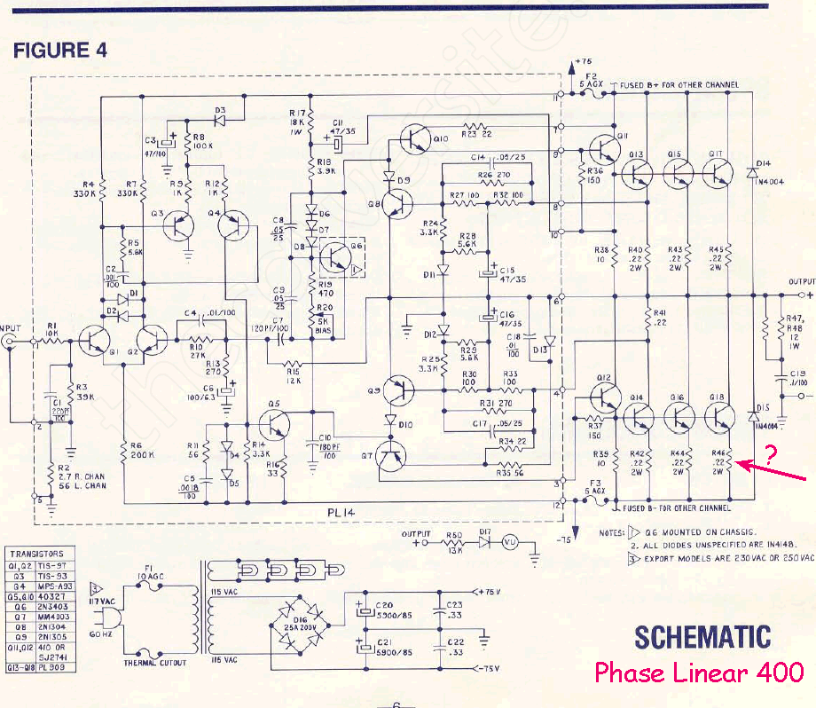

Phase Linear 400
I concede to your point however there are three power devices in parallel and the 0.22R emitter resistors are to share the load evenly. There is also a 0.22R resistor in common to the collectors of all of these R41 so you have 0.073R versus 0.22R which is more dominant.
😀The plot mjona showed a UGF of about 1MHz for the loop gain. I'm not sure why the plot I generated showed 10MHz, I agree this looks wrong. I'll look into this as soon as I can.
I'm not sure now whether mjona's plot is the same circuit or not, but 1MHz is more reasonable. I certainly would not claim anything like 100MHz+ for a 2N3055 (unless perhaps the input power was greater than the output and fed straight trhough with losses 😀 )...
