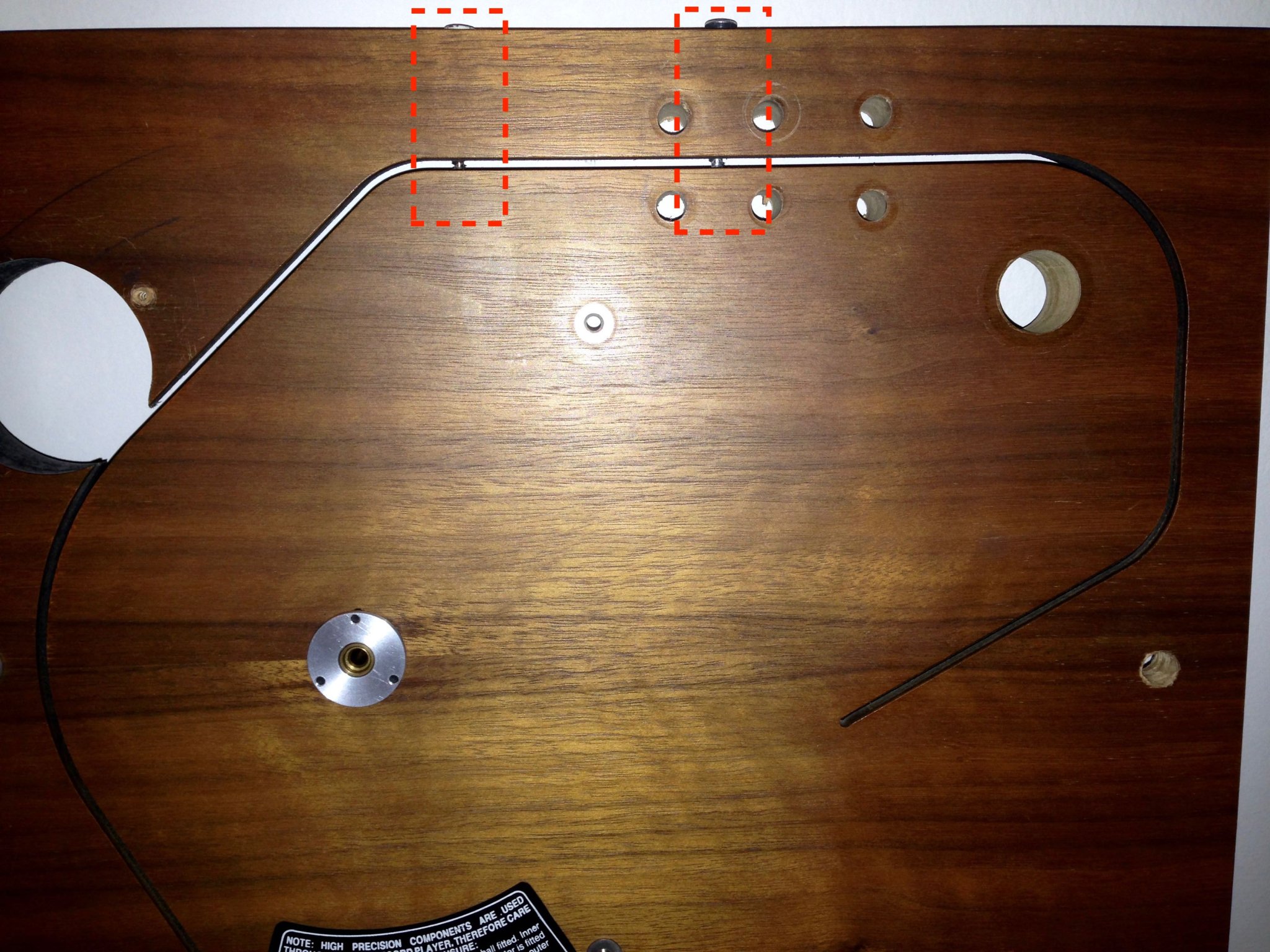

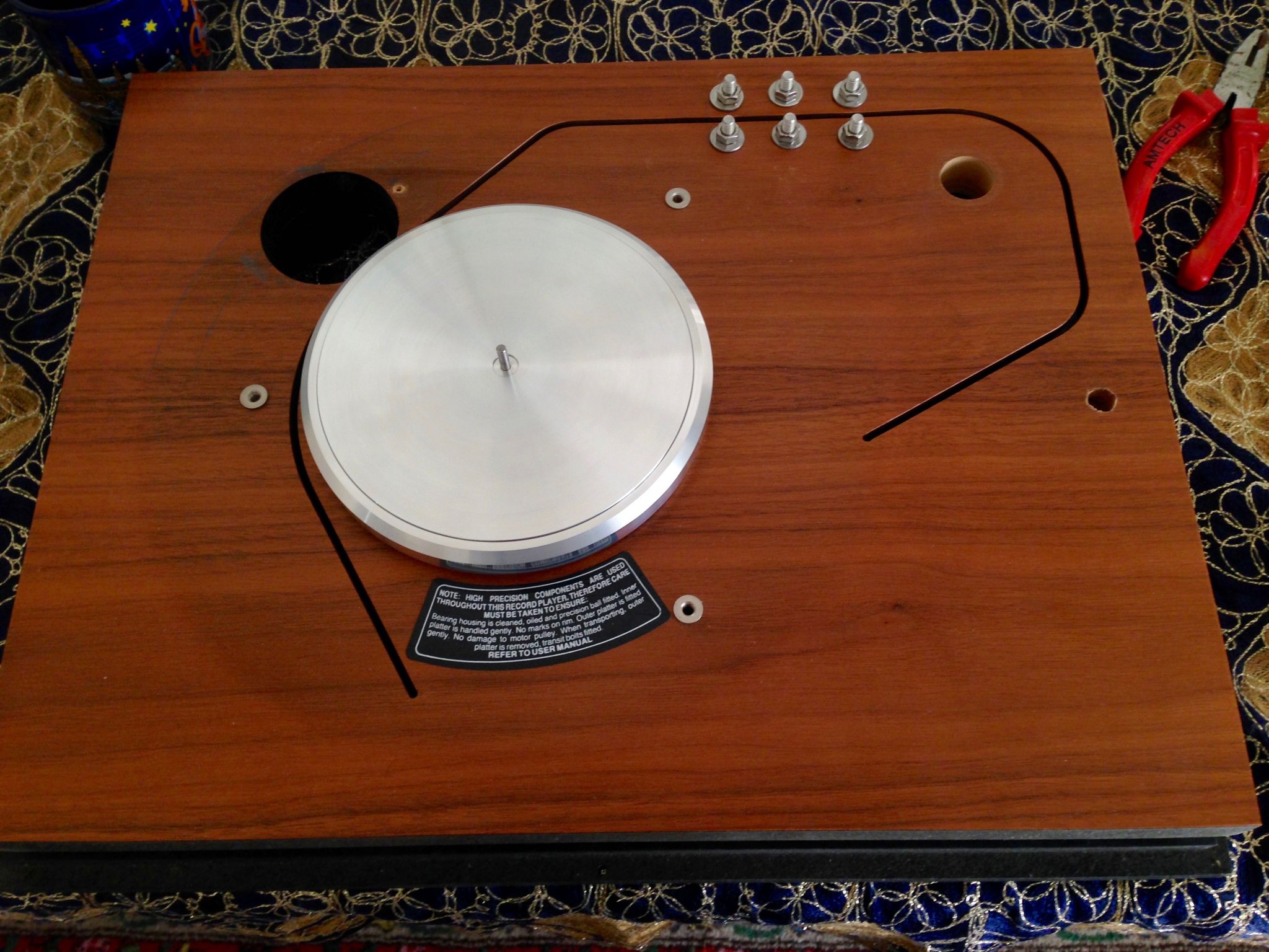

With respect to the Xerxes plinth sag, I also had made several attempts to cure it, before opting for a new plinth. Enclosed a photo, where two horizontal screws can be seen, connecting the two parts of the plinth, to keep them aligned.
With respect to the motor, Origin Live recommends to place it (screw it) on the top plate of the plinth. I have tried it and found that the best approach is to keep it completely detached from either plinth plate.

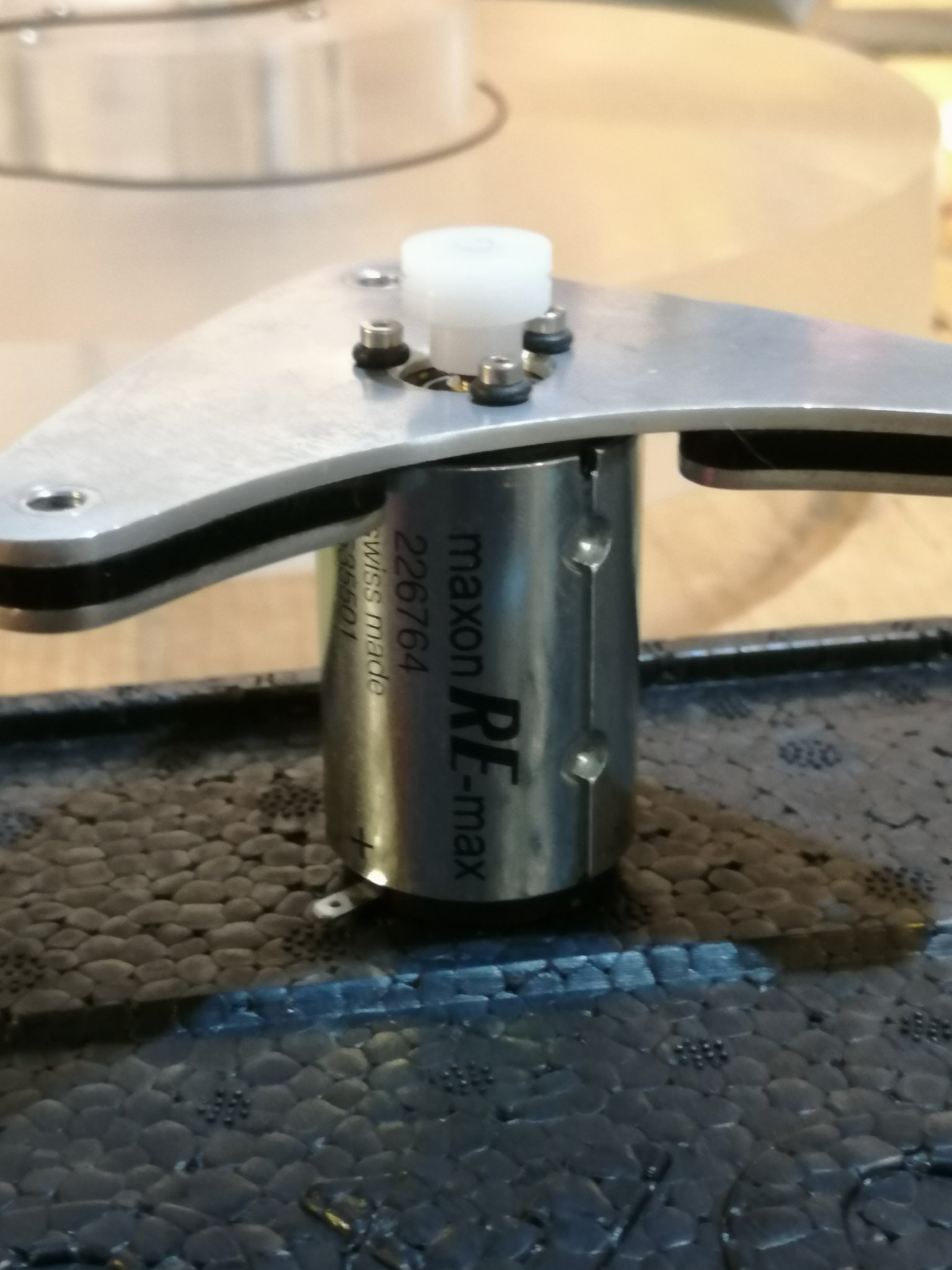

Hi everyone,
My Maxon motor has finally arrived.
The packaging quality was exquisite and completely over the top.
Fitted to motor plate with new pulley attached.
The improvements this motor has wrought are much greater than I had expected or even hoped for.
The most obvious difference is in tonal colour, rich and fully saturated. Top to bottom. The Premotec sounds a bit thin in comparison. It really brings out vocals superbly.
Image width hasn't changed much, a tiny bit wider. Image depth is much improved, deeper and better layered. Separation has improved as a result. A more natural soundstage.
Microdynamics and nuance of individual instruments really brings the character out. Sounds even more like real instruments.
Bass seems to go deeper and is better textured, more detailed.
Doesn't seem to have improved the leading edge of notes but definitely has the body and decay.
I listened to the motor directly with a mechanics stethoscope. It's a little quieter than the Premotec at 33 1/3rpm. The Premotec has quietened a lot since it was new, hopefully the Maxon will too. The noise of the Maxon is higher in frequency and more consistent, less variable.
The noise level increases less going from 33 1/3 to 45rpm than it does with the Premotec.
Overall it has lead to a more musically engaging sound. Very happy so far.
I've only had it up and running for about 3hrs so far, I suspect that it still has quite a lot of break-in too go.
I'm going to get in contact with Origin Live tomorrow to arrange for an Ultra controller as part of their upgrade deal.
Niffy

Hi Panos,
To press fit the pulley I used my drill press. I faced an M10 bolt which I secured in the chuck. I placed a set of small kitchen scales on the table. This allows me to apply the force directly inline with the motors axis. The scales allowed me to monitor the amount of force applied.
I am using the Origin Live advance controller with the Maxon motor.
I haven't tested with a volt-meter. I selected the motor so that, with sub-platter and pulley, the controller output voltage will be around 5volts. The motor speed is about 300rpm.
I hope it does improve with break in. The Premotec did.
Good luck with the DCX22. As it's a stock item it should be quicker to turn up.
Niffy
