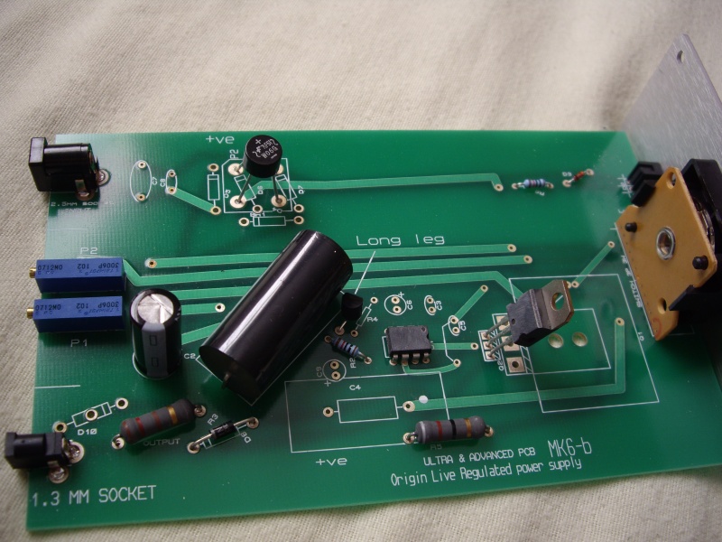

and this is the mk6 version of the OL pcb. I don't really understand if this PCB is matched to the Terminal resistance of the used motors or not?
Before the Mk12 it was a simple cuircut on the LM317 voltage regulator

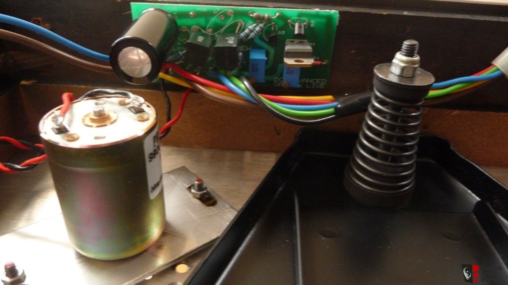

The current ol web site shows a photo of the dc100 sat next to the dc200. I haven't shown this photo in case it infringes copyright. The two motors are definitely different models and neither are the same as mine. Looks like Mark changes motors quite often.

That looks like the motor I have. I purchased my motor kit 5-6 years ago.

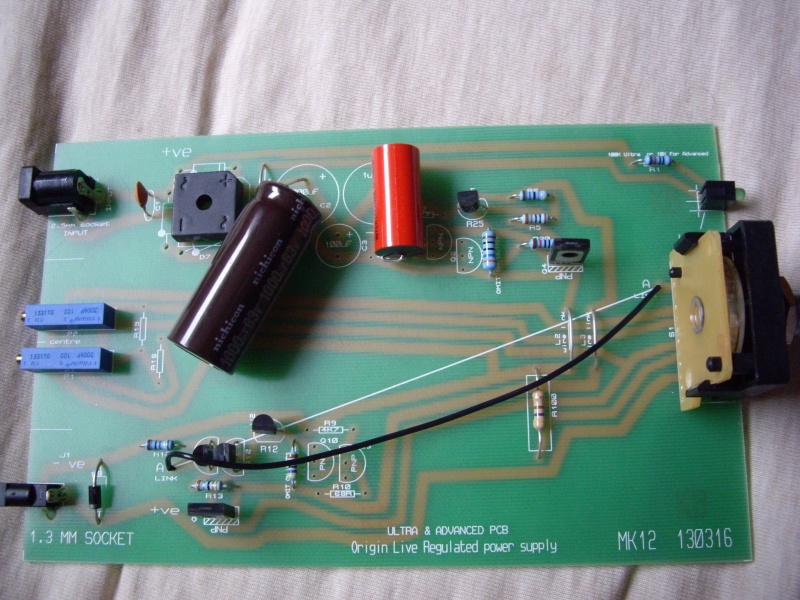

Looking at the PCB picture, it seems the same PCB is used for the Advanced and Ultra controllers. Has anyone performed a DIY upgrade to the Advanced controller?
I have the advanced motor controller and have investigated DIY upgrading it to ultra specs. Unfortunately Mark scrubs the identification markings off critical components making it impossible for a casual tweeker to upgrade. Can't say I blame him for that.
It appears pretty straightforward. If someone posts or sends me pics of the pcb top/bottom l'll try and draw a circuit.
