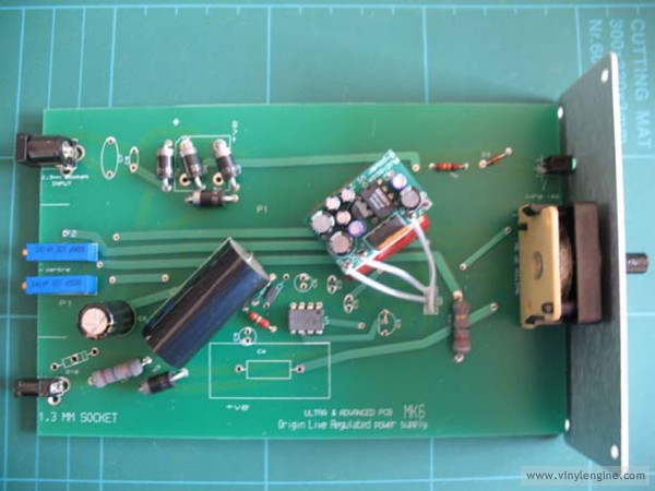

There is a blog on another web site that outlines upgrading the O/L motor controlling. However as I am a total novice I do not understand it. But here are two pictures of before & after
O/L Controller Upgrade
This is the description that came with it
''The difference between the advanced and ultra, 2 cheap resistors, 2 transistors, a couple of caps and four 50p diodes''
''Below is my initial upgrade to the O/L control PCB now neater with tidy soldering, heat sink on the voltage regulator from copper pipe better heat conductor than aluminum, 2 x 10000 uf caps to halve ESR, 4 x 5 amp Schottky 5B5100diodes replacing the monolith rectifier also I have now replaced the single diode bottom right with another 5B5100 , Wima 5% 0.1uf + 0.5uf metal film caps above and below PCB on the input prior to the rectifier. the goop under the caps is silicone to hold them in place as the PCB is inverted in it's case. ''
Cheers
Cheers

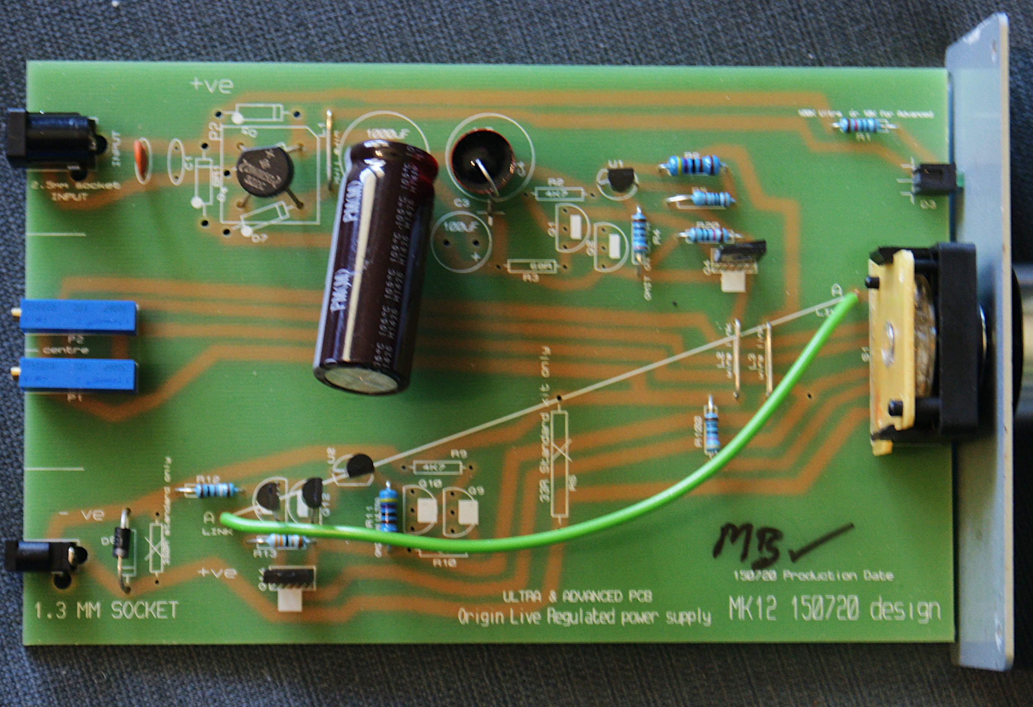

Hi, Sorry no, it is well covered over by the way Google handles O/L motor upgrade kits searches. I stumbled upon it by chance, it was mainly talking about using the O/L kit to upgrade the Linn T/T's.

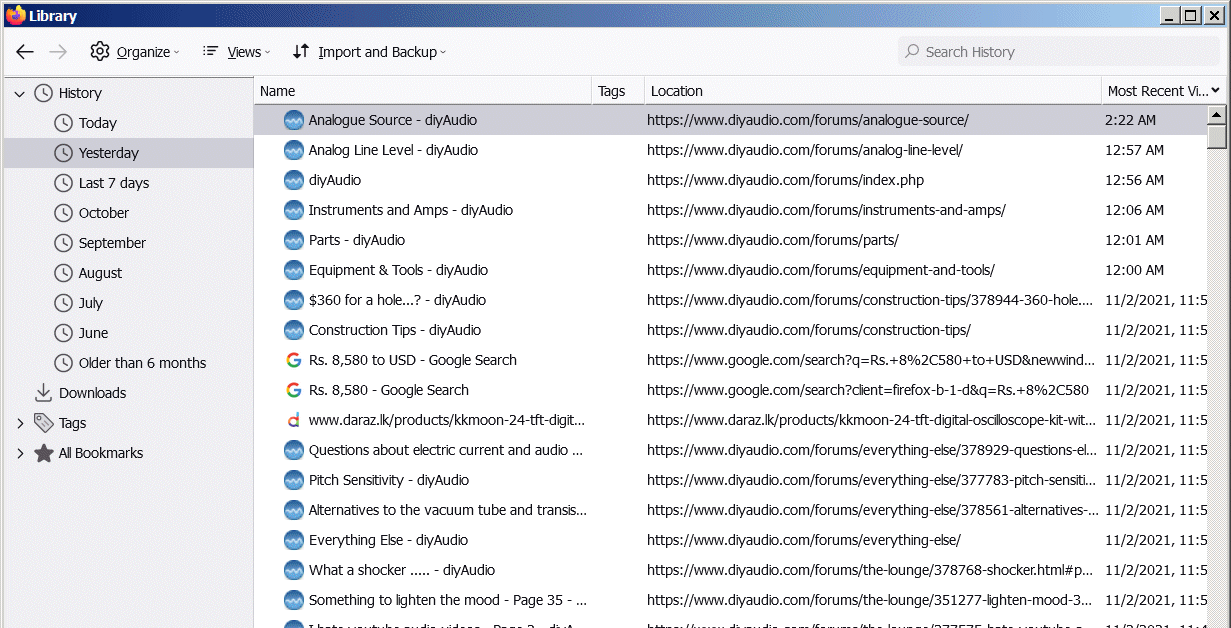

Took the screen shots & info as show closed my computer for the night & then could not find it again.
however there is a little info on the same, on V/E
Cheers
Cheers
Inexpensive alternative to Origin Live PS190 upgrade PSU- Vinyl Engine
(By searching for the text you quoted; an image is there also.)
(Another path is your browser's History, if you have not been dumping it to hide where you been, and if you can remember approximate time and date. See image.)

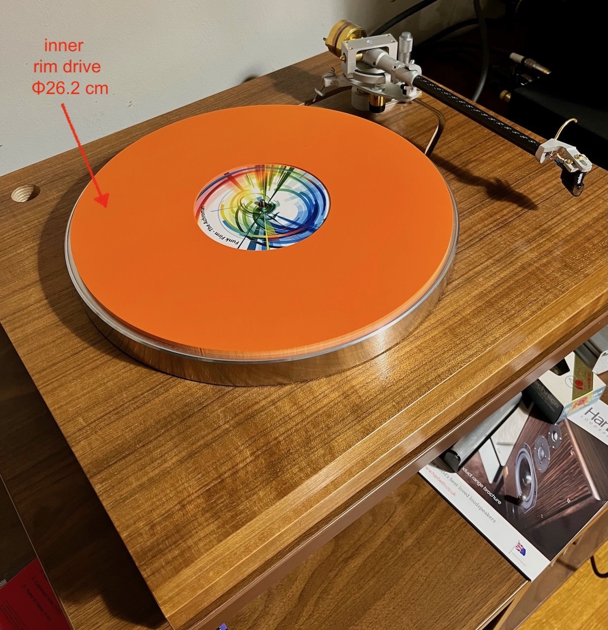

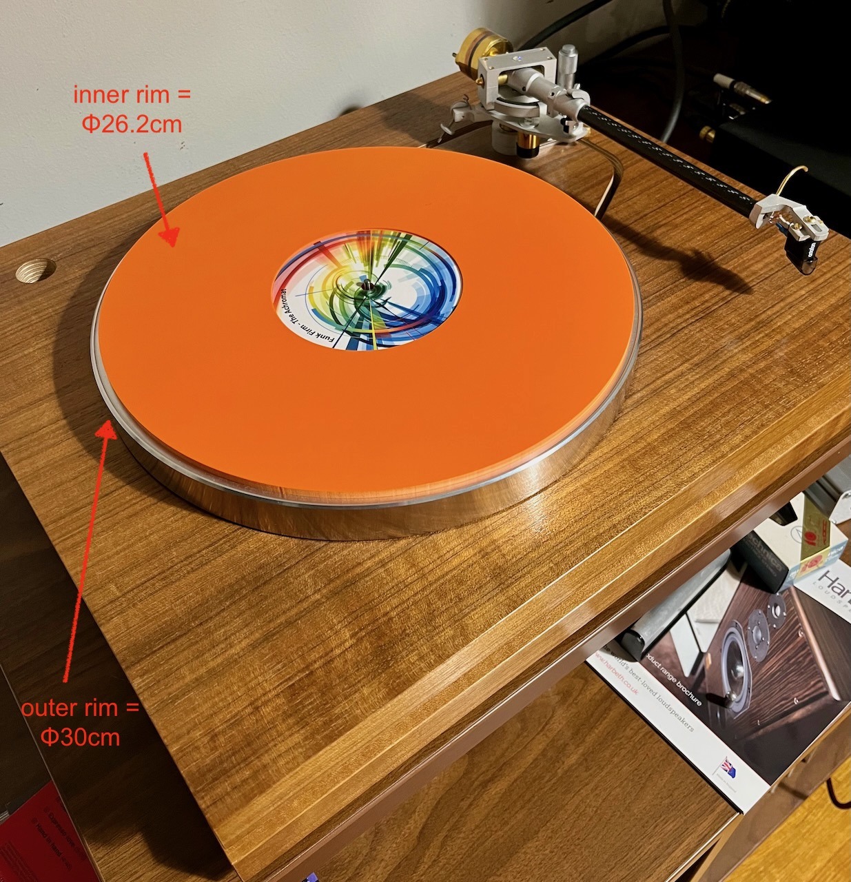

I also have an Origin Live motor kit (Premotec motor 18105 and Advanced controller) driving my Roksan Xerxes original turntable. I am not happy with the overall speed stability, so I am considering of changing the motor to something better. But this means that I will have to find the appropriate controller, too.
The cherry on the cake is that I am considering of eliminating the belt altogether and converting to a rim drive, either at the outer or the inner circumference of the platter. I guess a high-torque DC motor would be preferable.
Thoughts, please?
Thanks in advance,
Panos.
Athens, Greece
Thoughts, please?
Thanks in advance,
Panos.
Athens, Greece

Niffy,
thanks very much for your detailed response. I am very interested in your impressions, when you receive the new Maxon motor. Based on its specs it definitely provides much higher torque than the Premotec motor (actually 2.7x). This of course does not say anything about the vibrations that the motor produces, and more importantly whether it has any cogging.

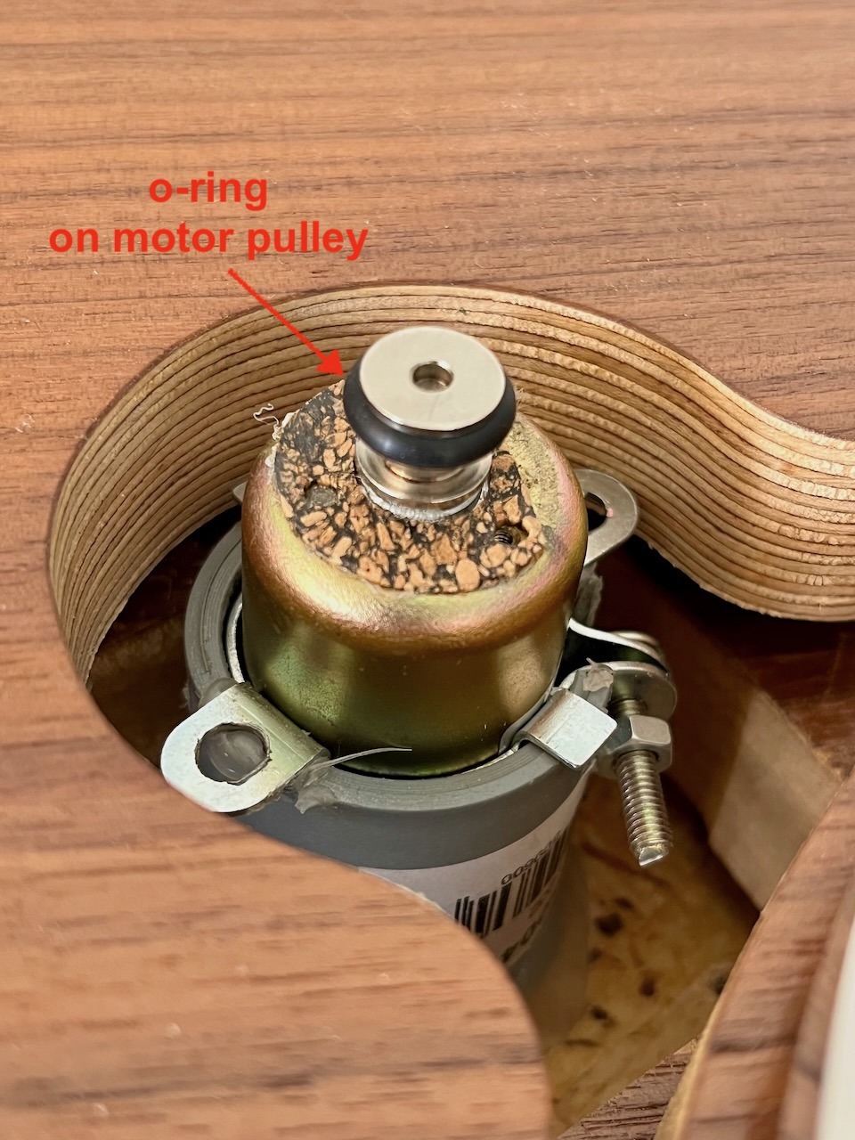

Earlier today, I managed to try something that I have been thinking lately, namely to remove the belt and convert my Roksan Xerxes to a belt drive. I placed an o-ring on the Premotec's pulley (see enclosed photo) and then placed the motor below the platter, so that the o-ring drives the inner rim of the platter. The concept seems to be working fine, at least functionally, because I have not had the time to do any auditioning yet. A first finding is that if I slow down the platter with my hand, the resistance I feel with the rim drive is noticeably greater than with the belt drive (with the same Premotec motor of course).
I've left the motor running for an hour and measured the speed. It seems quite stable, at least not less stable than with the belt. So, what's next? First of all an audition is needed. I must experience how this rim-drive sounds. If it is even marginally better than the belt-drive, then I will pursue it further. More specifically:
1) I will explore a new motor with higher torque, probably the Maxon RE-226764 or even one of Maxon's DCX line. Hopefully, if those motors are not compatible with the OL advanced controller (how can I find out, really?), I will fall back to the Premotec 16703 motor, which has similar characteristics with my existing Premotec 18105 motor, but with higher torque (22mNm instead of 10mNm).
2) I will place a second o-ring at the bottom part of the pulley
3) I will create a 'real' motor pod (what I have now is a joke, not a pod)
4) I will investigate whether a linear power supply can further improve on the motor's performance, having the sonic performance as the ultimate goal.
So, quite a few things to play with.
Any ideas/suggestions are of course welcome.
Panos

Hi Niffy,
thanks for the insightful feedback.
So, I understand that I do not have to stick to 12V motors only, since that's simply a nominal value.
At the same time, the lower the operating speed of the motor, the better in terms of vibrations, provided we do not face any speed instability issues. But, if -for a moment- we take motor vibrations out of the equation, how does motor speed affect motor torque? For a given power, the motor torque and speed and inversely proportional. This means that if the motor is operating at a low speed, it should also have high torque available to overcome resistance (e.g. stylus drag). Can you please confirm?
With respect to the Maxon DCX range, the famous Kronos Sparta turntable uses such motors (as showcased on the Maxon website https://www.maxongroup.com/maxon/view/application/TURNTABLE-AB). I will have a look whether a motor from that range might be appropriate for my rim drive application.
Last, can you please let me know the exact model of the Maxon motor you are expecting? Are you sure it's the 226764? I could only find the 226774, but that's 24V. I must be missing something.
P.
P.

Hi deano1712,
thanks for the info.
I've just sent an email to Maxon, stating my use case and asking their recommendation for one of their motors.
Based on my calculations for my rim-drive use case, I would like to have a motor speed that should range between 130-727rpm (at approx. 5V), depending on the pulley diameter that I will place on the motor shaft (the 6.5cm diameter of a typical Lenco idler wheel will require the motor to run at approx. 134rpm, while a pulley of 1.2cm diameter will require a speed of approx. 727rpm). I guess torque should be in the range 20-50 mNm (the more the better).
I am going to connect the motor to the Origin Live controller that I already have for the Premotec motor and see if I get any better results in terms of speed reliability and torque (because I cannot complain about too high vibrations from the Premotec motor).
So, the question is whether I should look at the DCX range or at any of the other lines they have (RE, etc.). Hmm.
Panos
Panos
Hi Panos,
By increasing the ratio between the size of the pulley and platter and also increasing motor speed to match the maximum torque available at the platter will also be increased.
The big question is "what benefits are there to having greater torque?"
The motor has to supply enough torque to overcome bearing friction, belt/idler hysteresis and stylus drag. If it supplies more torque than this the platter will accelerate which is not what we want. In most decks a tiny motor would be able to deliver enough torque. It is not the motor that has to adjust to accommodate momentary variations in friction due to drag ect. This is the job of the controller. I don't think that higher torque motors sound better just because they have a higher torque ability. I think that higher quality motors work better largely because they have lower torque ripple. Higher torque motors are often higher quality.
It is possible that higher torque is beneficial in the same way that higher power in amplifiers "can" be beneficial. Though this analogy would seem to fit with the controller more than the motor.
The motor I have on order is the Re-Max 226764. It has a speed constant of just 56.8rpm/volt. I do not think that this motor would be suitable for your deck unless you increase the size of the idler wheel. Your current idler appears to be around 10mm in diameter. With this idler the controller would need to output around 15v, more for 45rpm. I'm not sure if the OL can quite manage this. Select a motor of around 160-180rpm/volt.
Interesting info on the Sparta. Thanks for pointing that out.
Niffy
Niffy
Hi Dean,
Do you know what sort of speed the DCX22 were running at when they suffered speed stability issues and do you recall the specific model?
Niffy
Niffy
One extra point when selecting a motor. Avoid the ones with ball bearings as these will very likely be much noisier than those with sleeve bearings.
I’m not sure of exact speed but I have the dcx22s 24v motor and drive it around 1.5 volts. Pulley is around 16mm. Precious metal brushes is supposed to be quieter but they can suffer stability issues at very slow speed.Hi Dean,
Niffy
I drive mine with a voltage DAC, negative terminal resistance and closed loop control. Speed accuracy can be very good. The best I have seen on my setup is plus minus 0.02%.
