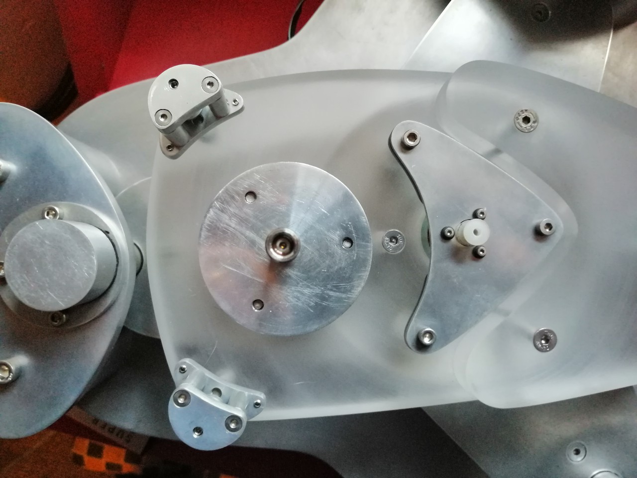

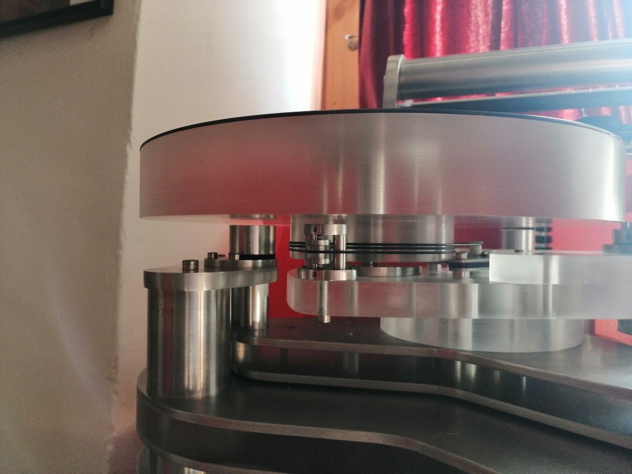

My deck has a pretty unique drive and bearing configuration that uses three round belts. Unfortunately mylar would not work on my deck. I am using a nitrile rubber that is very low stretch. IMG_20190227_120124-1280x960.jpg
This is with the Origin Live pulley still fitted.

this is indeed a quite original, unique bearing and drive type. Would be kind enough to post more pictures? It seems that you have a rather long belt (o-ring type), going around a 2-3 times around the subplatter. It appears to ensure good friction with the platter, but I wonder whether it requires a stronger motor than the ones used in simpler belt-drives.

Hi Panos,
I'm actually a proponent of short low-stretch belts.
I have three short belts, one motor and two idler wheels.
One belt goes around the motor and the sub-platter in a conventional way. The other two belts each go around an idler wheel and the sub-platter. The tension of the individual belts balance the side forces on the main bearing, which is inverted. It does this to such an extent that it completely eliminates these side forces. As there are no side forces acting on the bearing sleeve it is no longer required and has been eliminated from the design. I have what is in essence a unipivot main bearing.
In a typical conventional sleeved bearing over 95% of frictional torque is due to the sleeve. Likewise the vast majority of variation in torque is due to the sleeve. With my design the load is significantly reduced. My main bearing dissipates less than 2 milliwatts. Many bearings are dissipating well over 200 mW. This will heat the bearing causing it to change its performance as it warms and cools. The friction and noise of the idler bearings are much lower than that of the sleeve and, like the motor, are isolated from the platter by the belts. By using three separate belts, rather than a single that goes around both idlers and motor, runout of the platter is almost entirely eliminated. In combination with my clamping system the amount of vertical movement of the cartridge is lower than that seen with most decks.
I don't think that the main advantage of my bearing system is the reduction in bearing friction, reduction in variation of friction and reduction of bearing noise. These are very low anyway with most well engineered bearings, though further reduction is still a good thing.
I think the main advantage is in the way the bearing constrains the platter. The best analogy I have is the Chladni plate. When unconstrained the sand forms the simplest pattern. As soon as any constraint is applied the pattern becomes more complex. With a platter the sleeve of the bearing acts as a constraint.
The best way I can describe it sonically is that removing the sleeve seems to open the sound up giving a greater sense of space and transparency.
