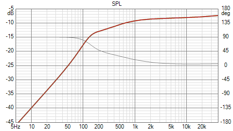

For active setup guess if you remove measured frd file from 10F and turn off woofer then XSim default to the flat response so from now on response chart will present the exactly filter gain based on used component plus the real impedance that still should be loaded using a zma file for enclosure situation.
Should look close to below, now export that as frd file and load it into Rephase or REW and use whatever EQ numbers to flat it out will give the EQ numbers to set in a DSP unit as a copy of the passive filter gain.
