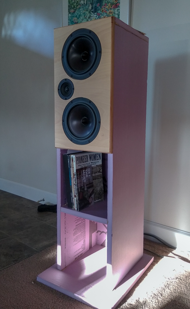

Covering up the XPS might make your wife more agreeable. Wallpaper, vinyl wrap, primer/paint, veneer would all be possibilities. Even my incredibly patient and supportive wife would balk at having to look at pink construction insulation foam panels for very long in the family room. Her only stipulation to my getting into the hobby many moons ago was that the speakers had to look like furniture or sculpture.

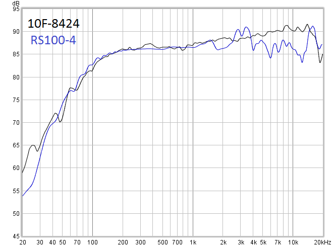

I’m working on a budget version of this using the Dayton RS100-4 and I’ll report back once complete......BUT.....I’ve been doing comparative listening of the RS100 vs the 10F on an open 12x12 baffle for a few weeks now.....no filters and here’s my dilemma
With all things be equal including volume compensation, the RS100 exceeds the much more expensive 10F on detail and overall clarity. Pushed loud, the 10F holds up a tiny bit better but I would never listen at these volumes anyway and without the help of woofer, I’m not sure this comparison has any value.

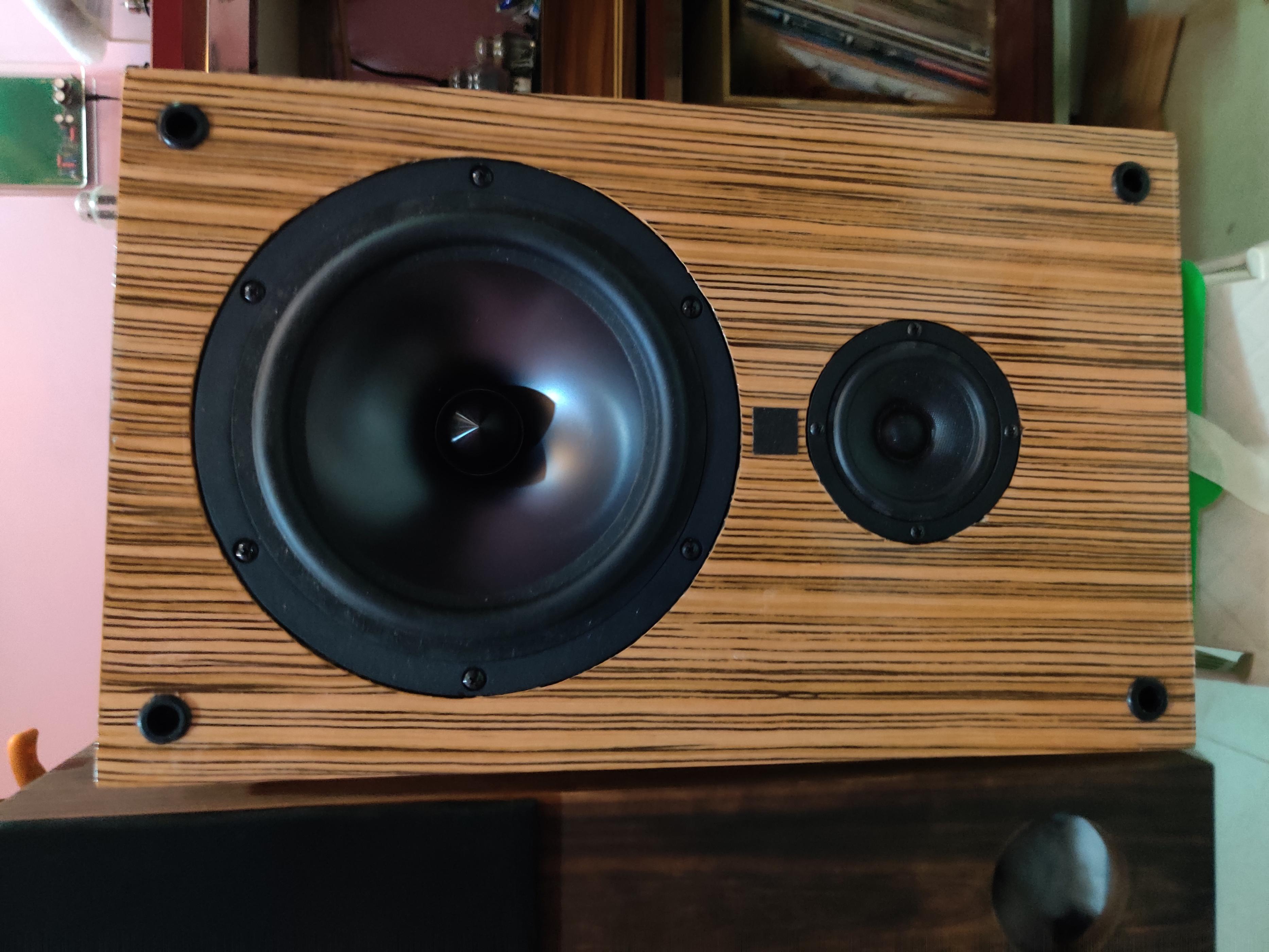

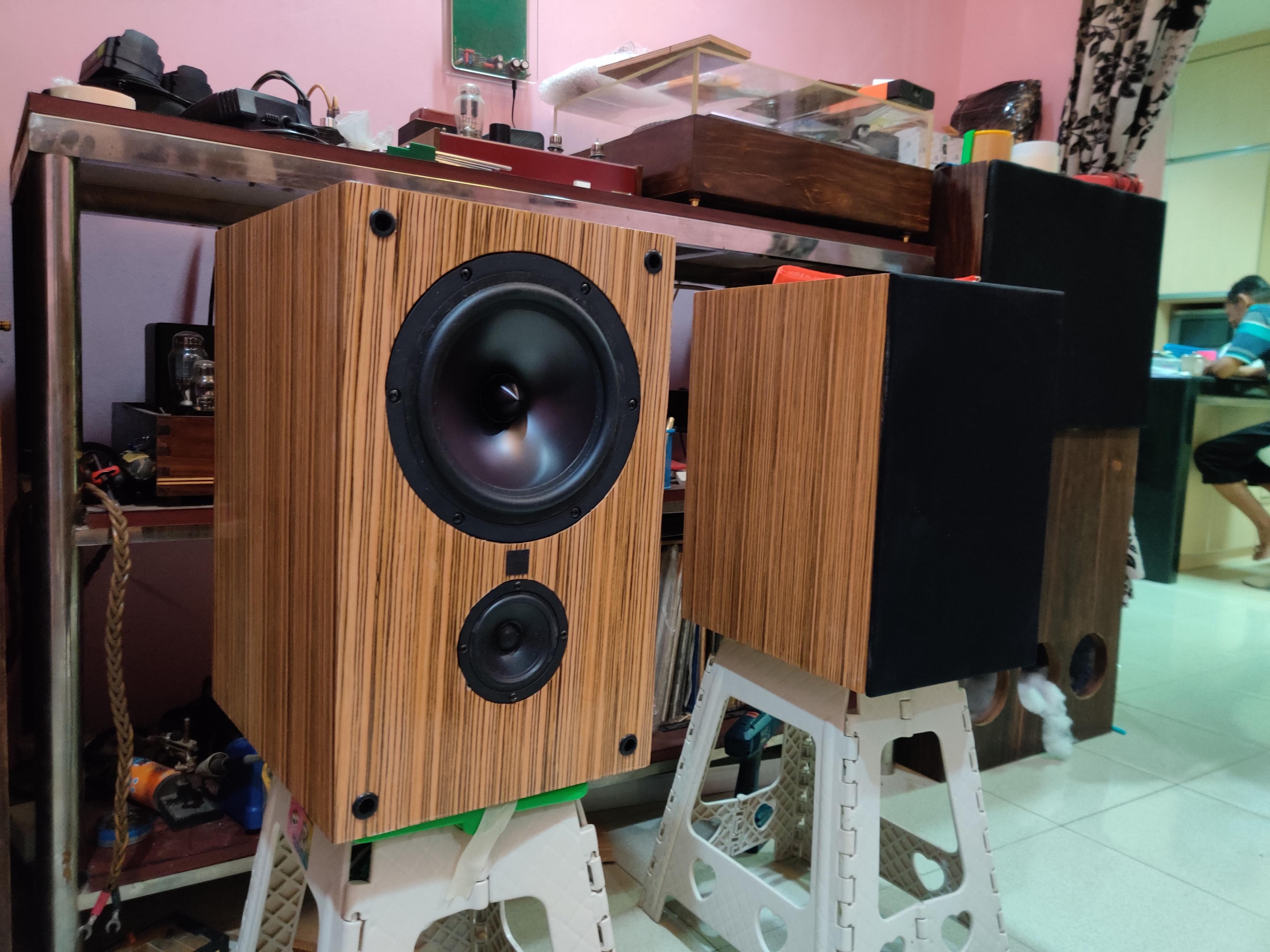

MasPenk,
Looking very nice! Is that zebra wood?
Yes.. I found a local seller got a zebra wood veneer and brush it with PU...
Looks spectacular, MasPenk, I'm very envious. My cabinets are unfinshed after a year of use. Then, I always liked the look of birchply, and I have zero experience veneering.

This is is DIY after all - and half the fun is tweaking and experimenting. But it’s is important to know why we are changing something and how much has it changed. Having measurement capability is not expensive as mic’s are $40 to $110 for a decent one. Software is free. I use the UMIK-1 USB mic calibrated by third party Cross-spectrum Labs. I think you could get 48v based mic from Dayton for $40 if you hare a mic preamp with ADC already (like a Behringer or Focus Solo etc).
Dayton Audio EMM-6 Electret Measurement Microphone
Behringer UM2 U-Phoria Audiophile 2 x 2 USB Audio with XENYX Preamplifier
So for $80, you can have a measurement solution that lets you design speakers and crossover quantitatively.
If you look at the measured and predicted frequency response and phase from this speaker and crossover, you will see that it is tough to beat a neutral flat response. There is a slight downward tilt from the lows to the highs which many people say gives a more pleasing balanced sound.
