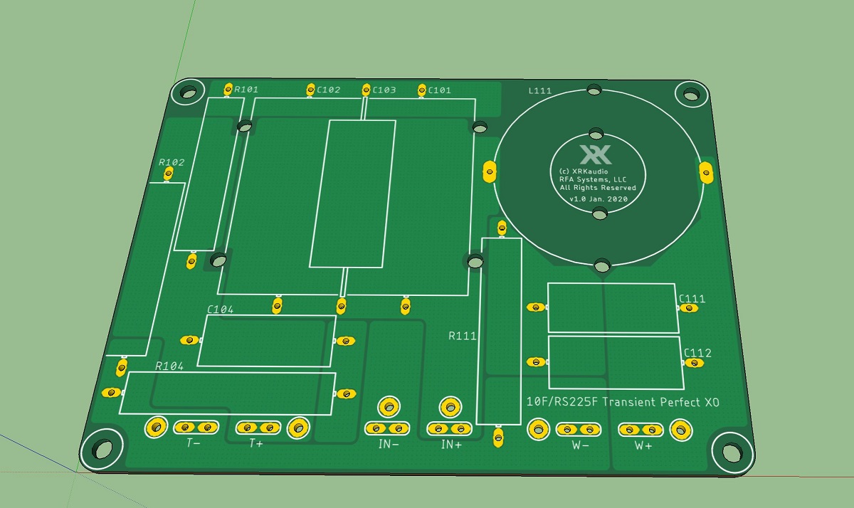

Board Gerber files are now done.
attachment.php
I can offer these as a Group Buy - will create a new thread in the GB forum for folks to signup if interested.

Will you be starting a GB for the XO PCB? (Looks like you beat me to it, X! Thank you!)

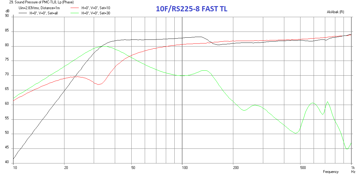

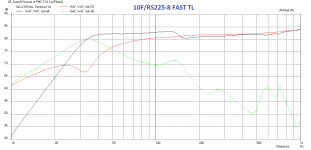

Vunce was asking me if this speaker could be made into a floorstander. And I thought as long as we are doing that, why not design a tapered TL (PMC style) that will give deeper bass that is still tight and not flappy like a bass reflex. Doodling around on Akabak seems to indicate that we can still get the same sensitivity and achieve -3dB at 32Hz. That's a huge difference from the 50Hz of the sealed cabinet. But this comes at the price of a larger and more complex cabinet.
Here is the predicted freuency response of the RS225 at 1m and 2.83v (4pi space) so far:
attachment.php
Hello XRK,
This is excellent. There should be a floor stander TL version always. I remember one member doing so. If you can fine tune this, it will be a nice addition to already good speaker. I am trying to do something similar for some time but cant seem to get to it.

Hi X,

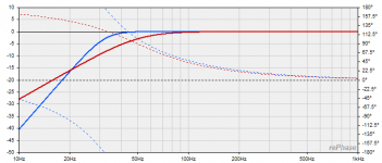

Would you share impedance curve for that 32Hz tapered TL simulation, you know one get curious on details of differences in objective data when sound performance is reported to be improved relative to ordinary bass reflex : )

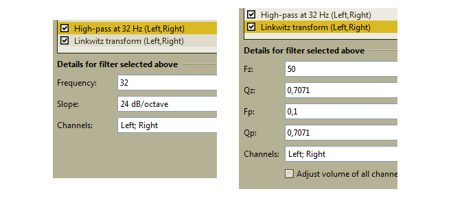

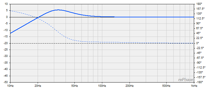

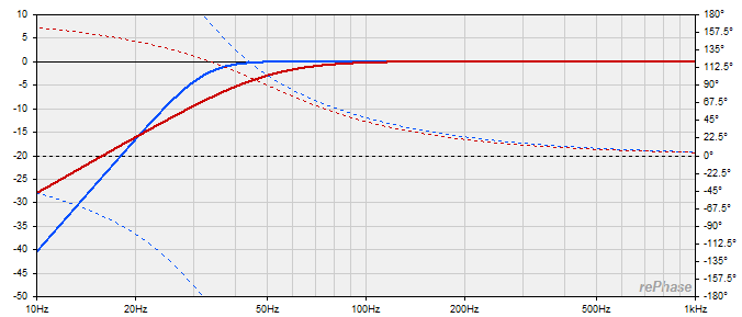

BTW except for bragging rights or outdoor use not shure a lower roll frq number is always to the better in a real world room that normal have some real time pressurization gain plus up to six times reinforcement boundarys that could come more or less late and also include inteference nulls. That said you should be able to get a feel simulate sound at a carefull bit lower acoustic SPL those roll off differences in your own lab room using the sealed enclosures and set below cascaded filters in Jriver to transfer 2nd order @50Hz to 4th order @32.
attachment.php
attachment.php
attachment.php
