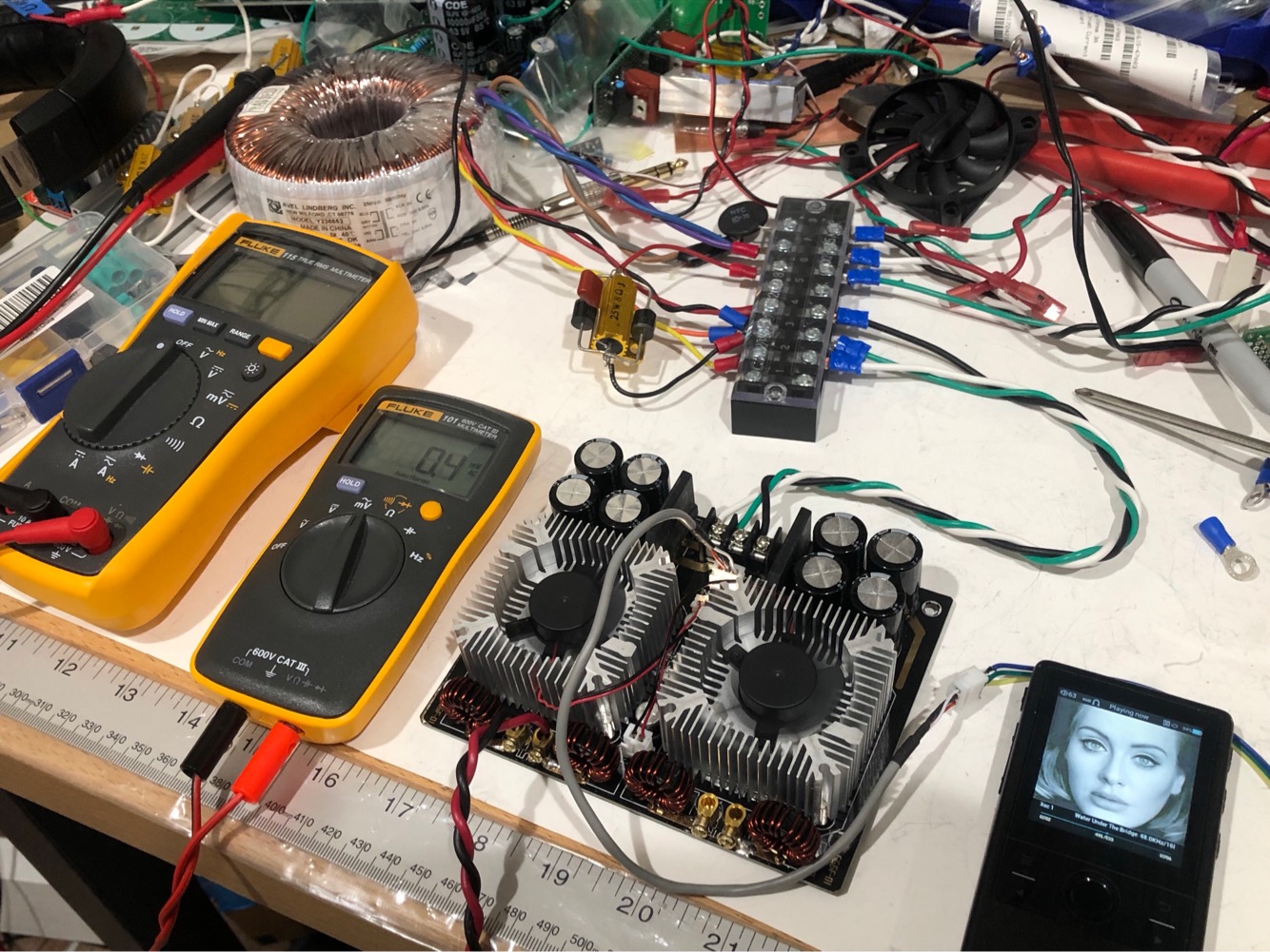

Here was my quick test of the 8954 on the 10F FAST:
TDA8954TH - XH-M252 board - anyone?
I measured 200uV to 400uV rms of noise with input source off - that's a very decent noise figure actually. Sound had good spatial imaging and excellent bass.

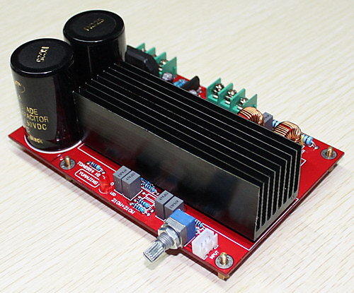

Hello X,
I see here they have both models you pointed to, plus this one, that has 2 huge electrolytic caps for linear current.
Do you think it might be better?
Here's the blurb from the website:
nUse original TDA8954TH
nMain electrolytic capacitors using gold NOVER brand, capacity 10000uf / 50V , 10A, and using the above flat bridge rectifier to ensure strong support for a steady stream of power.
nThe resistor uses a five-ring metal resistor, and the main circuit uses a five-ring metal film resistor with an accuracy of ±1% to ensure a good signal-to-noise ratio.
nThe PCB adopts 1.6mm thick double-sided sheet, 2.0 oz copper thickness, and the whole process of tin-spraying ensures the good passing performance of the current. First-class PCB quality.
nThe output uses a red ring high current inductor to ensure that the sound is crisp and powerful.
It’s hard to say if it’s better. It appears to be a single amp in BTL (bridge tied load) vs the one I tested which uses two amp chips, each in PBTL (parallel bridge tied load) and each has its own bridge rectifier and power supply cap. The PBTL can handle double the current so probably can drive 2ohm loads even. Not that I ever use 2ohm speakers. The red Yuan Jing model you posted is about $38 and probably fine for most applications with a FR driver.
I also like it’s passive heatsink vs fans.
This one looks nice too and also has an output relay. It turns out that when you want a high wattage amp, a linear power trafo is a more economical way to get power. These use linear PSU vs a SMPS. When you need 48Vdc to 53vdc - dual rail SMPS are very expensive and quite noisy. Whereas a 25v 300VA toroid is about $30.

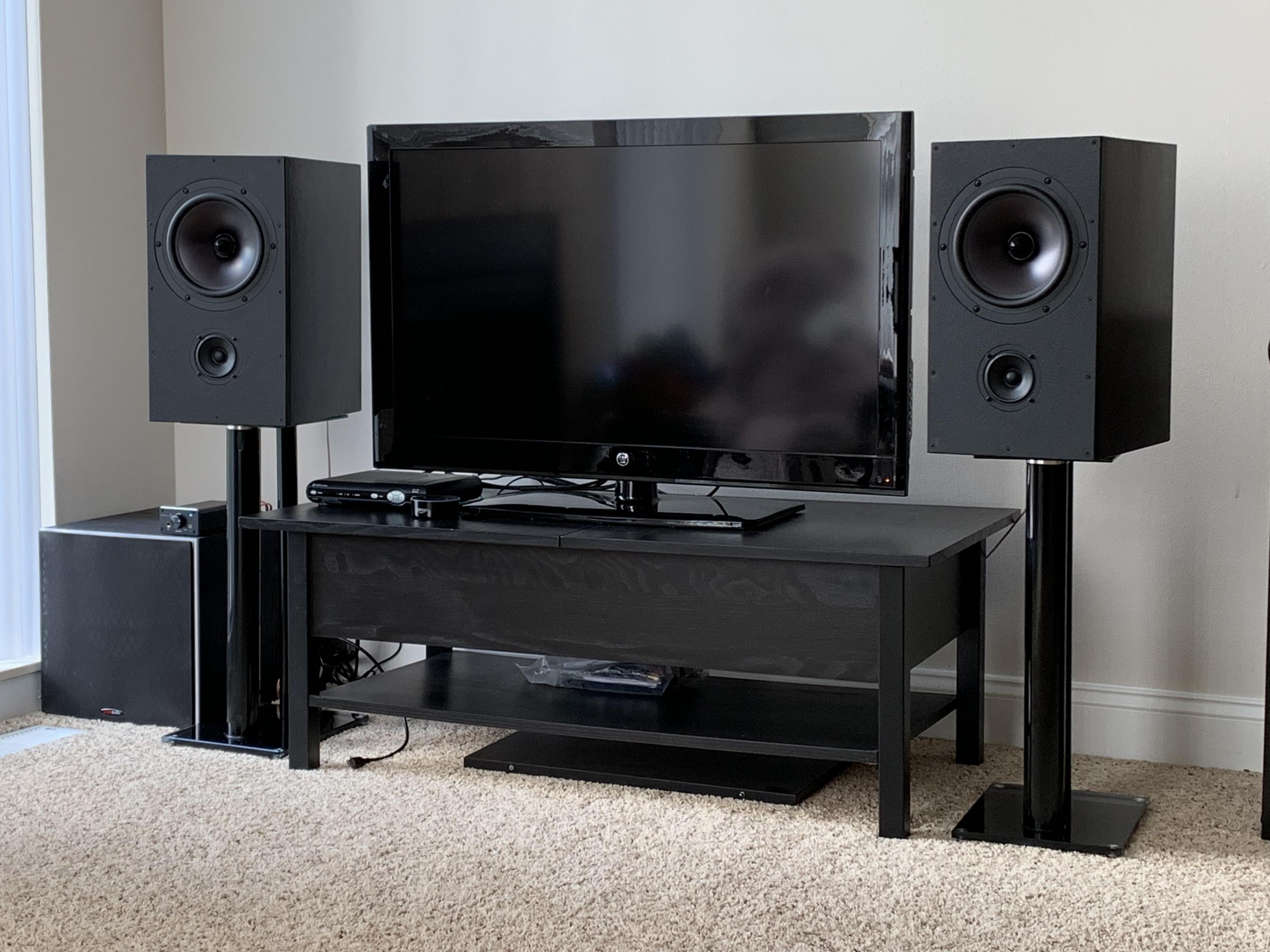

I family acquaintance who is an audio enthusiast came by my apartment in Michigan last week to listen to the FAST speaker. This one is my wife’s setup and only powered with a Dayton DT-120 blue tooth amp. Also has a Polk Audio PSW10 subwoofer handling content below 60Hz. We had a good time and he has B&W 800D speakers and SS Macintosh amps in his home system. Despite only Class D amp and BT streaming from Amazon Prime on my phone, he liked it enough to listen for over an hour and was very impressed with the clarity, sound stage and imaging. I am pretty sure these speakers can hold their own with many commercial offerings costing a lot more.
Here is a photo of the system we listened to:
