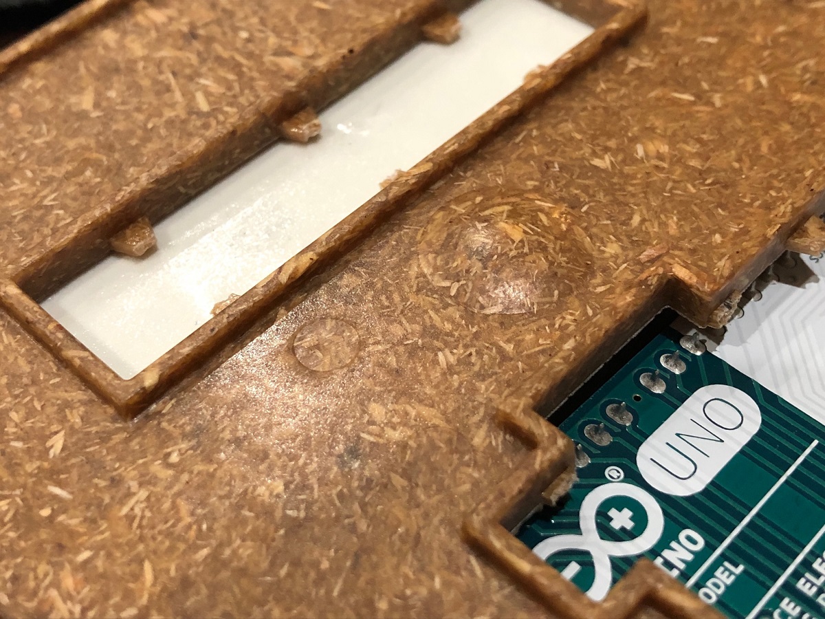

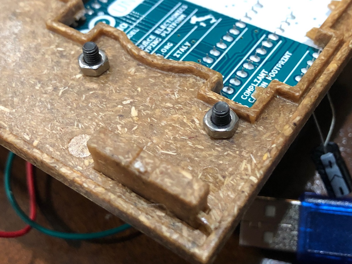

It is interesting that they use recycled materials, but this product would be almost impossible to recycle again, with the wood chips glued to the plastic.
Here are some closeup photos so that you can see the fine molded details and it looks like particle board but feels smooth. It feels warmer and more sound absorptive than plain plastic. Arduino genuine stuff is made in Italy and they use nice components. It's good to give back to the arduino .org as they are providing a great service with their free and open platform.
