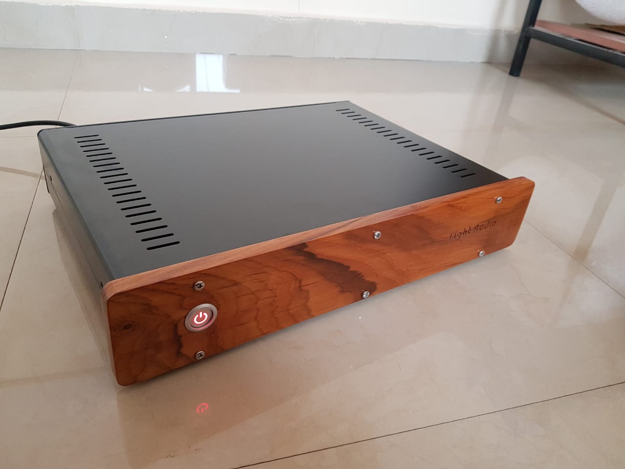

Finally, your 10F/RS225 build deserve better amps than those little D amp boards.
The little D amps are cute and good enough for a boombox at the beach, but they lack a lot in detail and imaging. For something as detailed as the 10F, get yourself nicer amps to drive them.

totally agree.
i dont like A->D stage of dsp. I am only going to use dsp to get the xover points correct. once its finalized, i will try to implement the same in piano dac. Piano dac with volumio plays songs from Tidal.
also i presently have two 85W class AB amps for biamping. Later i plan to switch to allo's tpa3118 amp for full range ps95 as my impression about this amp has been good. i have used this amp with MA alpair 10.2 and the detailing was excellent. maybe class A/AB will sound better.
i also have plans to try out class A (5W amp camp amp or 8W jean hiraga for full range).
