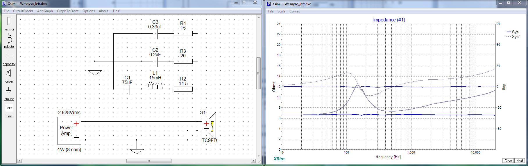

That’s impressive Byrrt, looks like a impedance of a planar ribbon!
Happy new year!
BYRTT: that is indeed inpressive correction! So if I understand you correctly, the same could be achieved with speaker cables of half resistance? My current setup is like you're suggesting - one speaker has .7m cable, the other over 3m. I can't say I'm hearing any differences between them. Maybe the effect is too subtle for my ears.. I do however see the reason behind compensation networks, worthy experiment if one has adequate impedance measurement capability!
Agree its mostly a subtle effect and especially the cable test can be subtle or non audioable, but if one seek a bit less distortion here and there in diy adventure it can be one of them. In one case its also a visual improvement, that is if one linearize resonance of a real woofer although it takes some huge values for components, then one can see with eyes that on some old tracks where there can sometimes be much low rumble or DC thump interference that make woofer visual occilate, but when linearized it get steady as a rock. In guitar world there is another funny related effect to low verse high impedance cases, guitar pickups are mostly of relative high impedance and same is amp input that can be huge so with high gain settings to get distorted sound one can hop upon cable and hear how cable R/L/C effects pops out of system because its so undamped and sensitive to cable R/L/C changes.

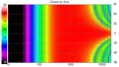

Below polar is theoretical half space beaming for 68mm driver and high passed LR 4th order at 350Hz.

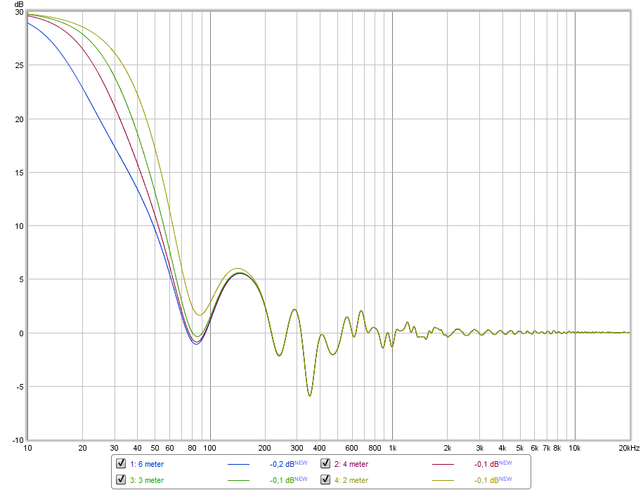

Below REW overlay is room gains for a speaker placed at a random position inside a room with longest room dimensions of 2/3/4/6 meters (see legend for colours), moving position of speaker around in room will change distances to boundarys and so will change curves too, smaller room in general increase pressurization as seen there and in head phones can go up to 2-3kHz area predicted my study is done right.
Hard sound for TG9 i cant think of except as said if you have to big interference problems where stuff cansel out with out knowing, else can think of sound can be hard if room gain example below conflict with speaker resonse down there say 200Hz and below because then low end timing comes too early and rhytm in music plus natural foot tapping is lost, and if that is the case try add some reverse EQ of your room curve down there to relax the too fast and hot amplitude bass area.

Ha ha perceval you think it gets expensive no start maybe with what you have and make some trials, myself ordered a big box well sixty or something different inductors from RS Components cost was something as 50-80€ and it makes me do whatever research on dayly basis to make objetive data curves and get a grib or feel on subjective conclusions, now its not the heavy inductors that can take hundreds of watts forever as those wesayso got for his final build but where mine is bit too small to keep cost down but they are fine for shorter time of full SPL stroke and no problem for normal SPL then one can always buy the expensive ones if build gets the approved stamp to stay for longer time. Subjective the resonance linearization for a sealed box running the woofer band can actual be a night and day experience but thats up to you to try and don't worry for the huge capacitors simply wire two electrolytic back to back and remeasure linearization or capacitor value after say 2-3 years if they keep doing their job. And why shouln't you have a couple boxes laying around with inductors and capacitors when you have tons of different drivers laying around
That said now don't kill me i could be wrong but myself been thinking about you had for a time come into a period of your audio life where simple as possible seems to rule or rock and thats fine and think can follow how it can sound interesting and kind of alive but then stuff as above is not forward but backwards in subjective system can get alot more clinic compared to simple as possible, but down the road for me and also learned from wesayso endless research (Thanks) such clues as clinic has often lead to one can find other misconfigurations and when they solved bit for bit then closer to the dream sound show up.
So in general don't spend 95$ in parts per driver bandpass at least not before outcome is stamped as improvement.
