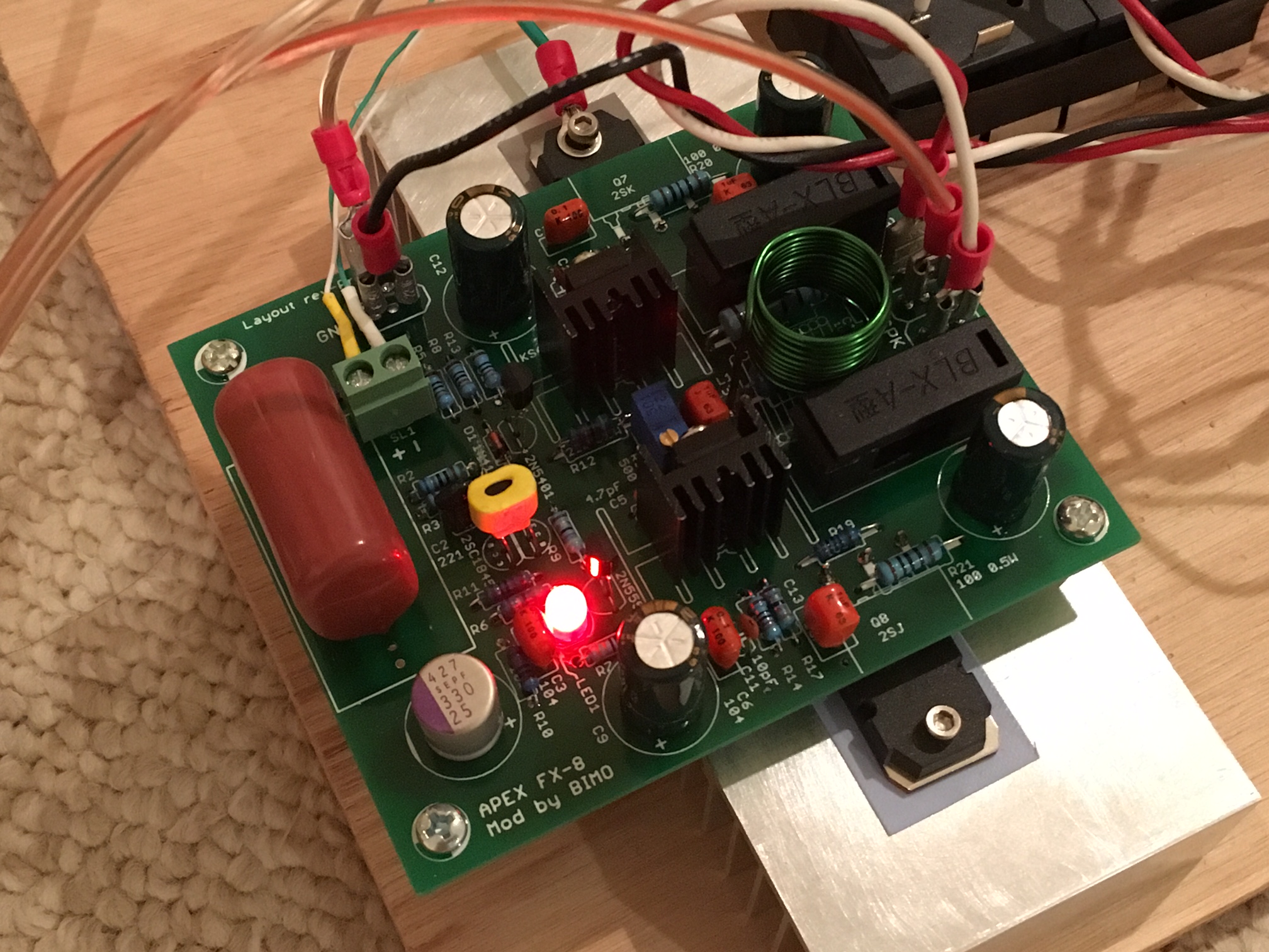

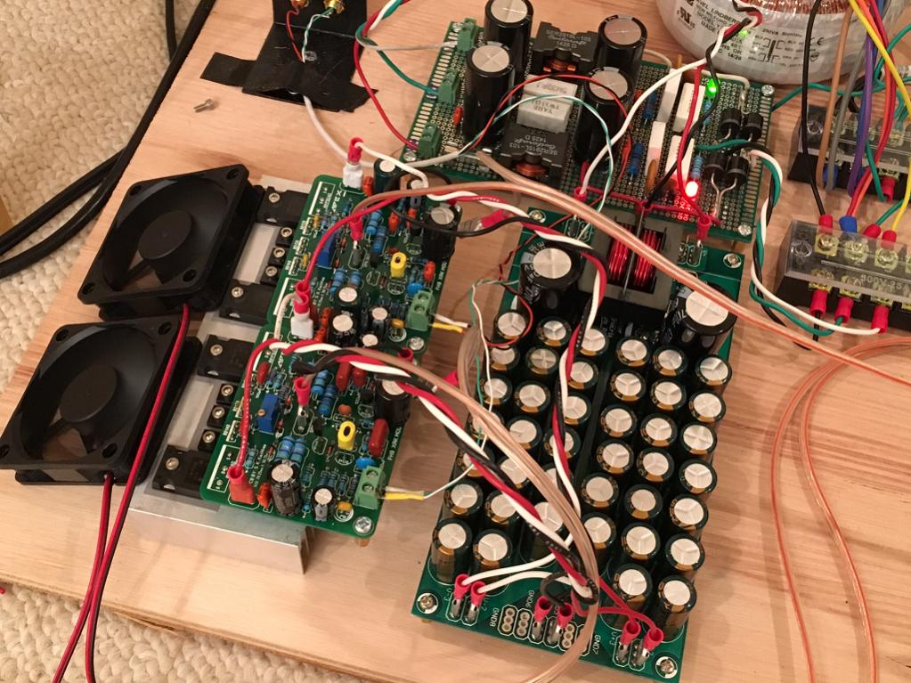

Here is closeup of FX8 amp:
This is actually a very easy and cost effective amp to make (ca. $50 not including PSU) and about 4hrs of soldering.
Here is setup with power supply:

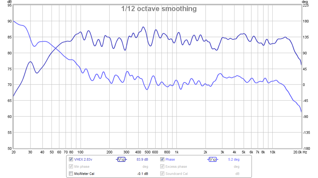

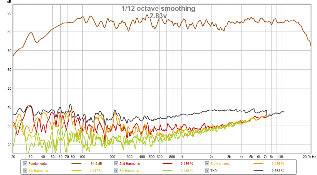

Newly measured frequency and phase response all looks good (this is incredibly flat frequency response for such a simple passive xo - indicative of the great natively smooth performance of these drivers):

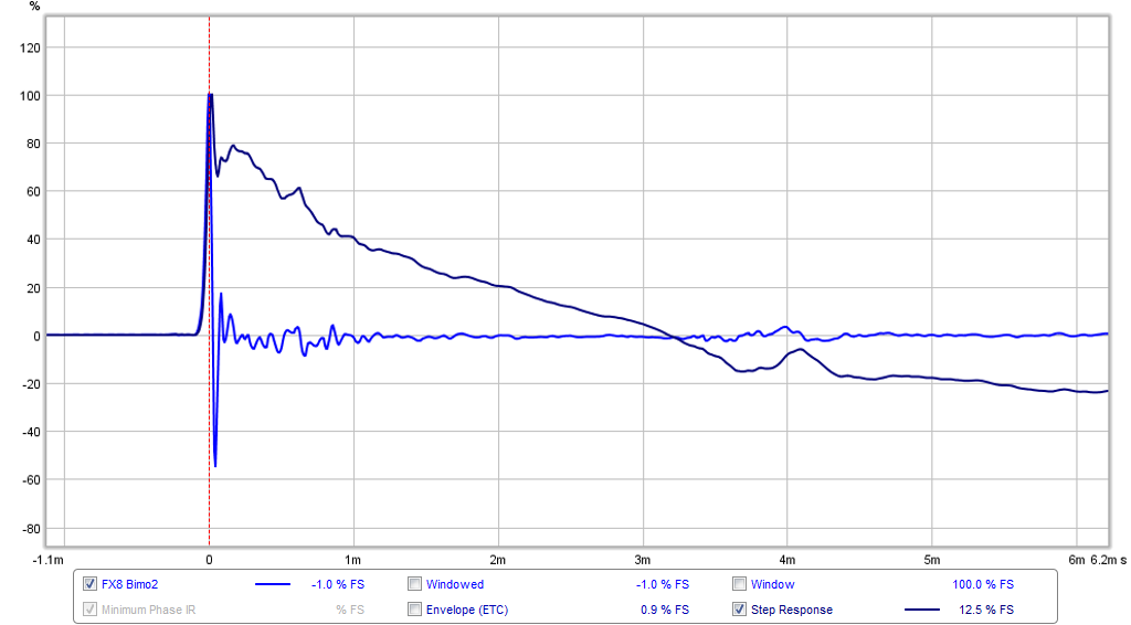

Measured impulse and step response:

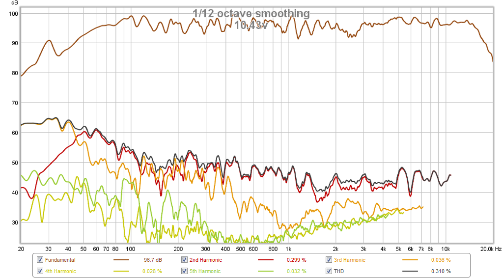

Measured HD spectrum (this is at 0.5m so equivalent SPL at 1m is about 84dB - same as listening level SPL) - any speaker with -50dB HD spectrum is just a joy to hear as it is so clean and clear:
This amp is capable of about 50w into 8ohms and a good match for this speaker. I have been listening to several albums and they sound superb: Melody Gardot "Currency of Man" and Dave Brubeck's "In Their Own Sweet Way". The pianos on Brubeck are so clear with no audible HD and being transient perfect, are very realistic. The smooth mids give Gardot's voice a great rendition that is natural and clear. Deep bass lines are captured authoritatively with the amps powerful ability to push current into the woofer. Again, transient perfect behavior makes for great drums.

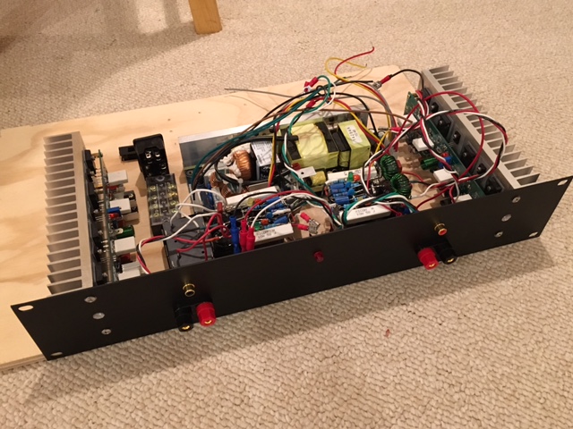

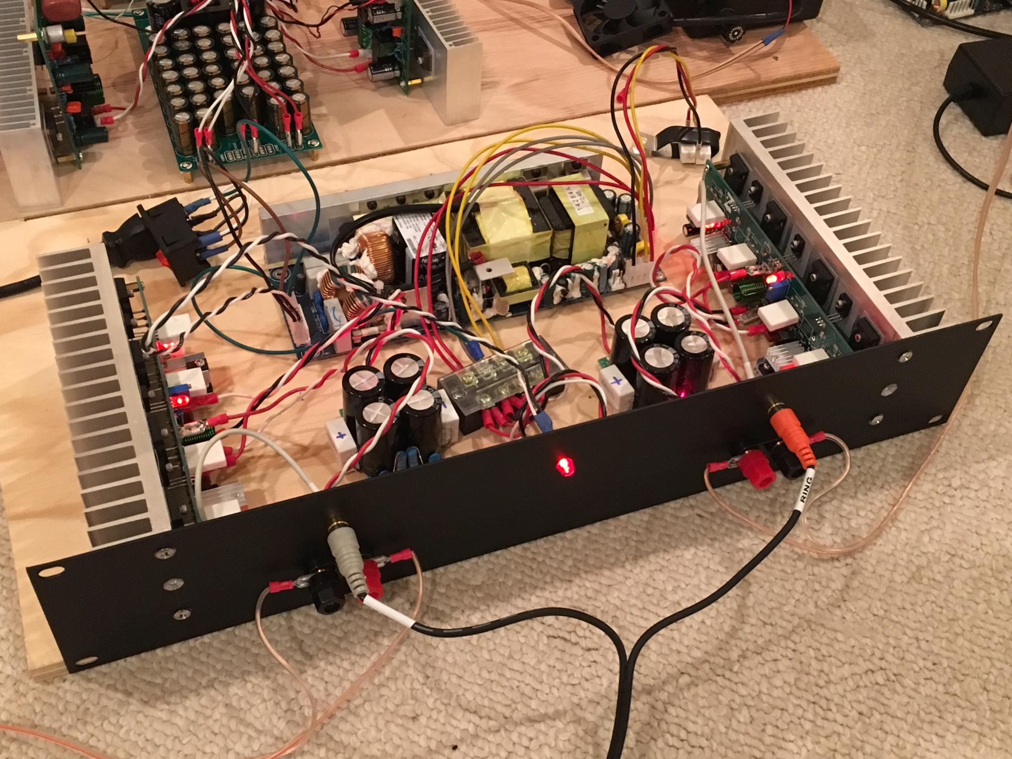

The "Un-Case" a users' amp case with all connections in front panel for easy access - uses an $8 2U rack mount front panel and self-heatsinks as side walls, plywood board base, open top ventilation, simple to make.
I am building a new CRC filter to go between the SMPS and amp. Using 4700uF 5R 4700uF arrangement on each rail. With 330pF 2kV to 4.7R RF snubber on input, 100nF 100v C0G bypass caps on outputs. With this connected to Abletec and Vhex+ I am measuring 1mV ripple at amp input and 0.1mV ripple on amp output with audio inputs grounded. Very quiet.
Will make two of these CRC filters for a quasi dual monoblock (as SMPS is shared).
The Abletec appears to have no issue with turn on transient to charge up qnty 4 x 4700uF caps in the filters. The CRC should help de-couple the amp from the SMPS to reduce PSU rail "pumping" under heavy loads and give more isolation between two amp channels for better stereo imaging and sound stage.

The "Un-Case" amp enclosure works. I am listening to the Vhex+ amps in their new home. The soundstage is very wide with the dual CRC PSU's even though fed by a single SMPS. I still need to cut the plywood base plate out and mount the PSU's onto the plywood.

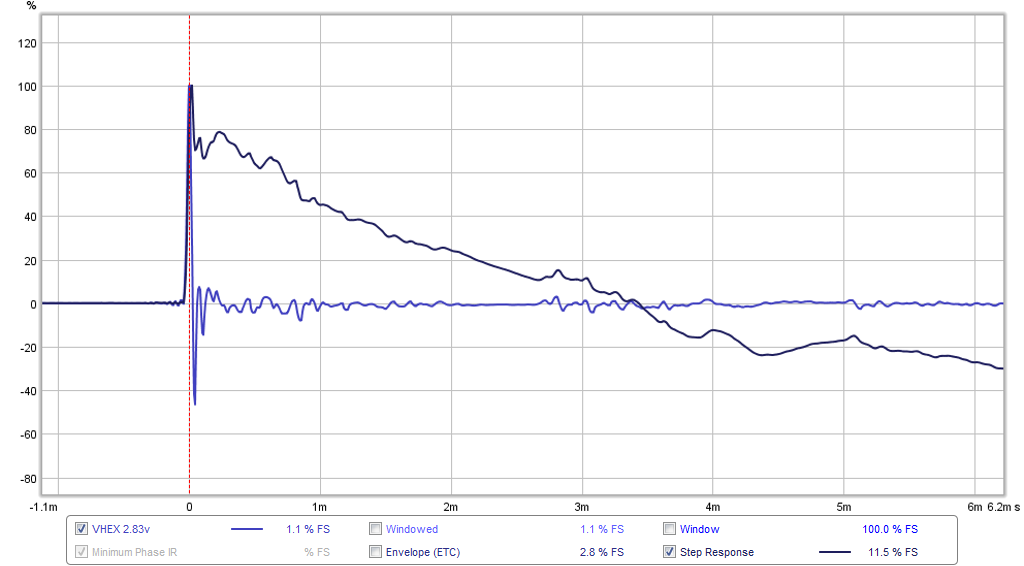

This amp and speaker combo work well together. The dynamics are outstanding - at averaging listening levels (which happen to be around 2.83v or 1 watt) the harmonic distortion is very low. Even stressed to 10.43v (13.6w) which is very loud, the distortion is quite acceptable. The impulse and step are near ideal as is the flat phase response. Overall, a nicely balanced and superb transient perfect setup.

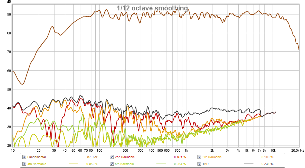

Harmonic Distortion at 2.83v (0.5m):
Harmonic Distortion at 10.43v (the 10F is superb here - very clean):

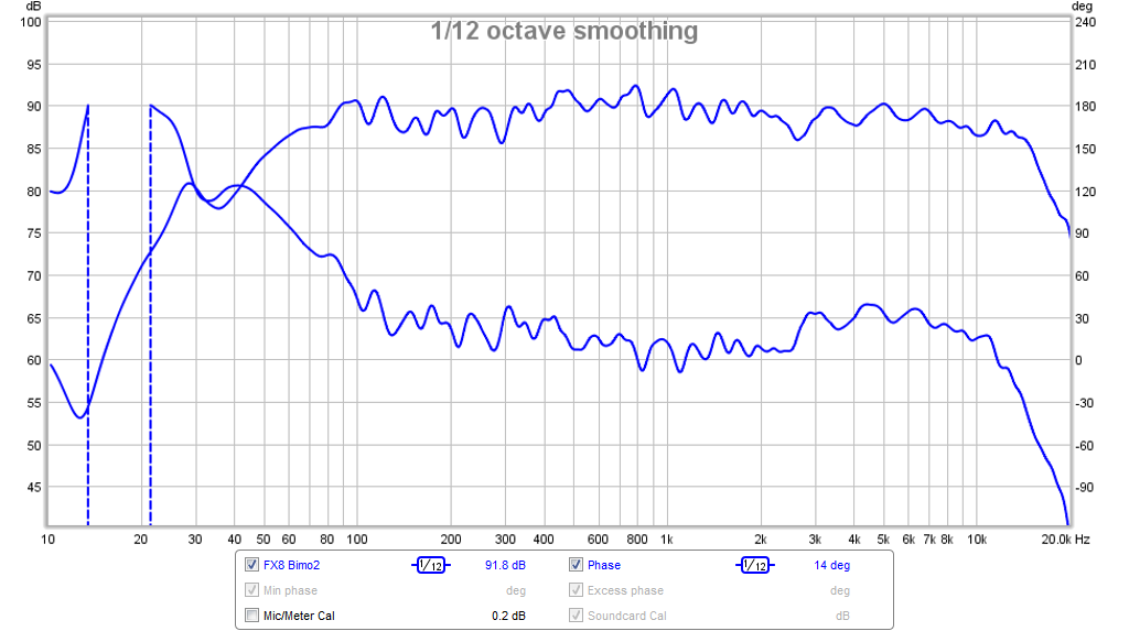

Impulse Step Response:
Measured Phase:

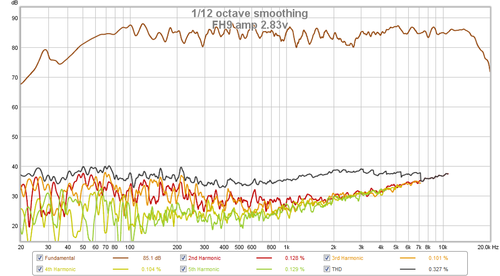

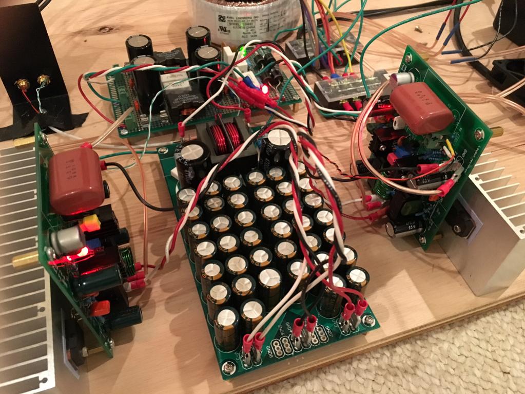

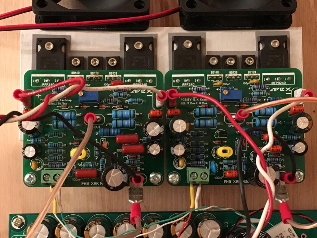

FH9 MOSFET amp
Ok next amp up is one of my own design. The FH9 based on the Apex FX8. Mine uses low cost vertical hex FETs. I source from Aliexpress for $6 for 5 pairs of IRFP240/9240. They are not fakes and look and work very well. Anyhow this amp has some deep deep bass. Great mids and clear highs. No sibillance. No harshness.
Here is is with 35v rail linear supply and big fat cap bank. I am using a tiny undersized heatsink hence the fans. The fans are silent by the way. Just use a 100ohm 2w resistor between 12v supply and it slows down to inaudible but still provides cooling. Currently running 80mA bias. Output DC offset is 2mV via well matched input transistors.
Measurement with 2.83v drive into 10F/RS225:
