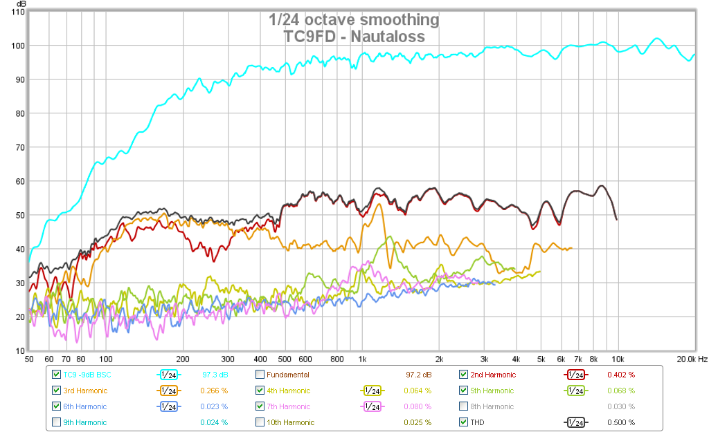

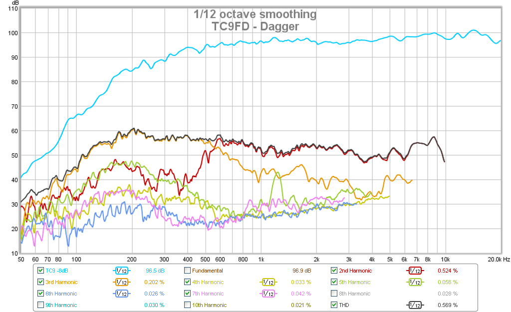

Personally, I would just make it as shown at 1.1L. The benefit is perhaps a bit lower harmonic distortion (maybe -5dB) but it is so low already you won't notice it. The main effect is if you need a lower XO point. But if you stick with 350Hz or higher the 1.1L is fine. So stay the course.
Here is HD at reference level of 96dB at 0.5m for TC9FD in 1.1L Dagger:
Here is HD in a >5L Nautaloss:
