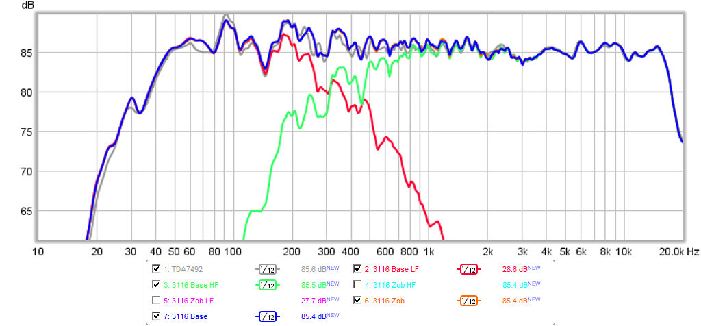

Sound Clips Comparing TPA3116D2 amp with TDA7492 Amp
Sound clips and measurements of the sound quality from a TPA3116 amp wit and without the new LC-filter Zobel mod, and TDA7492 amp (which has the built in Zobel circuit) as suggested by StanleyBurbick.

Blue is the TPA3116 and grey is the TDA7492:
Here is the ne so-called LC filter Zobel mod (tiny SMT 10R and 0.1uF in series connecting the two legs of the input pins to the inductors):

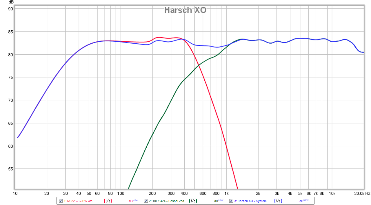

Since I had the FRD and ZMA files from my 10F/RS225 monitor already (SATX pulled them from manufacturer website for RS225 and from my measurement for 10F), I was able to put this into Jeff Bagby's excellent simulator program (Passive Crossover Designer or PCD) to test out the Samuel Harsch XO concept. I decided to use an electrical XO frequency fc=400Hz (requires a delay of 1.25ms on tweeter). I had to apply a few very minor PEQ's to flatten things (shown below), but the overall sim looks very promising.
Here are the PEQ's used:
Code:
Woofer: -2.5dB @300Hz, Q=1
Mid/Tweeter: -1dB @1000Hz, Q=1, -1.8dB @10kHz, Q=1  and overall padding of -6.0dB
Crossover filter settings per Harsch recommendation:
Woofer is Low Pass Butterworth 4th order at 400Hz
Mid/Tweeter is High Pass Bessel 2nd order at 400Hz with 1.25ms delay relative to woofer.
Here is the resulting modeled XO response:
494976d1437582087-10f-8424-rs225-8-fast-ref-monitor-harsch-400hz-10f-rs225-xo-pcd-sim.png

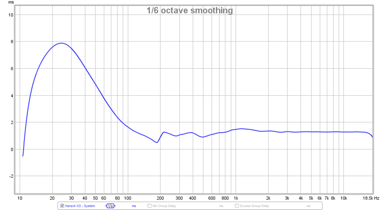

Here is the predicted group delay (notice the relatively flat GD through the XO region):
494977d1437582087-10f-8424-rs225-8-fast-ref-monitor-harsch-400hz-10f-rs225-gd-pcd-sim.png

Although electrical xo freq was 400Hz, the acoustical xo appears to be about 550Hz. So the natural response of the speakers may call for asymmetric xo frequencies. This may help reduce the dip at the xo region because it is too wide now.

That's pretty cool. I tend to like asymmetrical crossovers for pro type speakers or wherever a steeper slop is required, and often suspected they could be "quasi optimal" transient pretty good if done well, based on what i heard. Nice to see some more extensive data.
One thing that always gets me is that the textbook slopes of these more esoteric XO's are generally hard to achieve in reality as the response of the driver, the enclosure, etc modify it. So just picking an electrical 4th order Butterworth for example, is only half the story. Generally, I have a hard time achieving true 6dB/oct fall off for a 1st order. Until the acoustic (measured) XO slopes match the textbook example, the sim will be off and you get a different behavior. Then you have to try to use some mile PEQ'ing to shape the response to the textbook shape.
