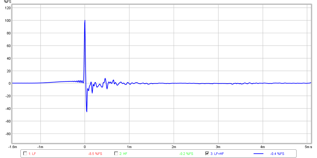

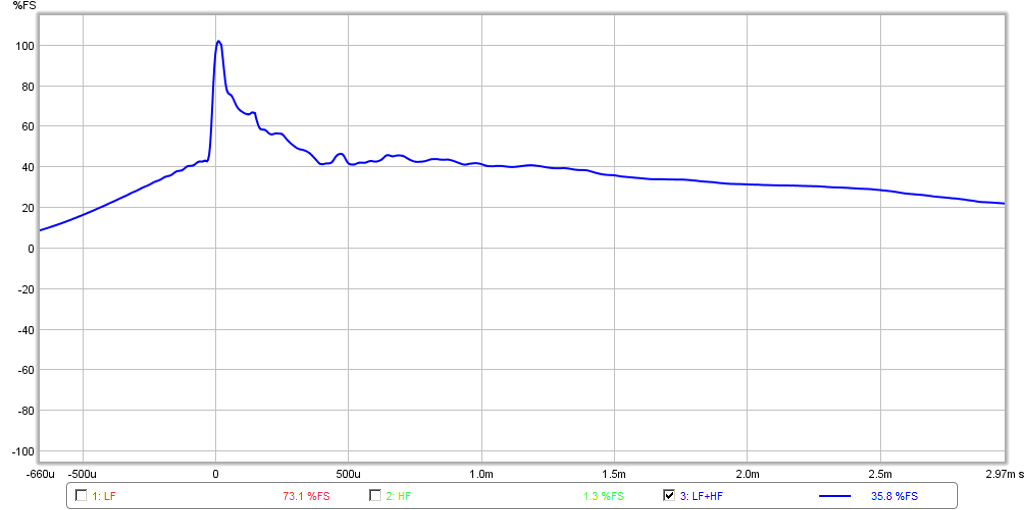

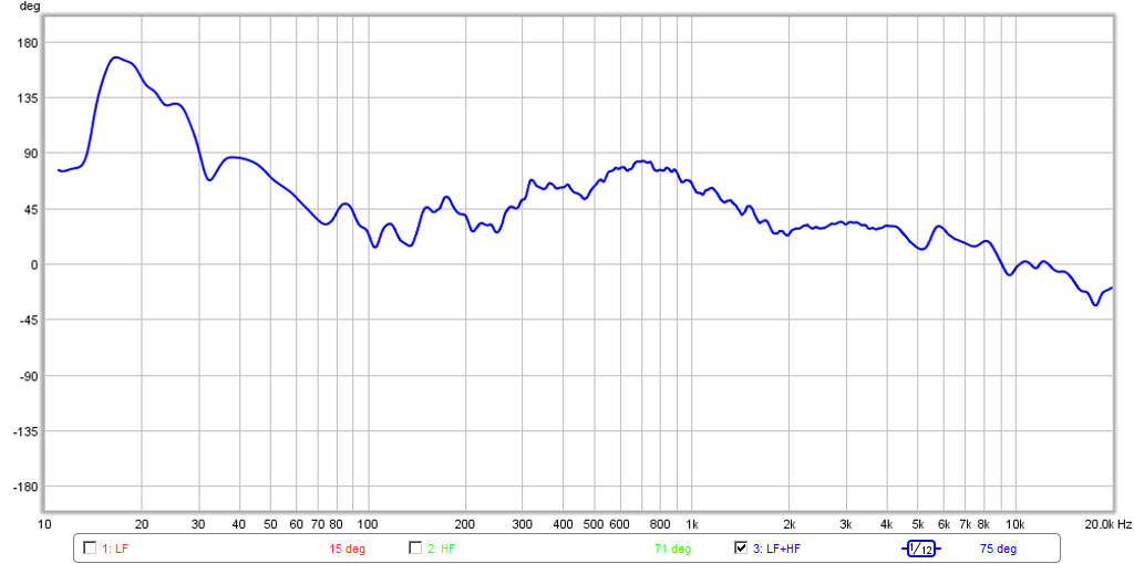

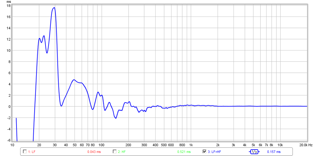

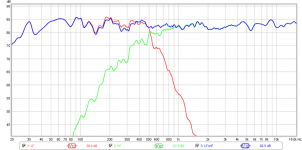

First trial test of Harsch XO with 10F/RS225
After applying the settings in miniDSP exactly like what I posted earlier, the measured response was a little off since the acoustic centers of the drivers was not taken into account during the sim.

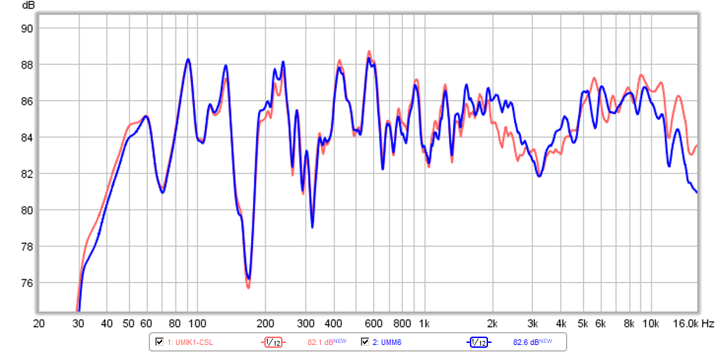

I got a new measurement mic (UMIK-1) and bought it calibrated by a third party, Cross Spectrum Labs. My old UMM-6 compares pretty well. I am only going to 16kHz because past 16kHz, the calibration on the UMIK-1 starts to get really steep and I don't want to it to increase the confidence of the measurement. Here is how the new Cross Spectrum Labs calibrated UMM-6 compares to the mew UMIK-1. They are within 2dB at the worst spots and otherwise fairly close.
So in summary:
- 4th order Butterworth at fc on woofer
- 2nd order Bessel at fc on mid/tweeter
- Set delay to 1/2 of 1/fc as start and adjust to account for acoustic centers - xo dip will fill in with correct delay
- Use some mild EQ to flatten response
Measured acoustic XO:
Measured Phase:
Measured Impulse Response:
Measured Step Response - sort of works:

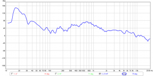

Measured Group Delay (1/3rd octave smoothing) - under 5ms at 50Hz, very similar to the simulation, and under 2ms at 100Hz, and not crazy through the XO region:

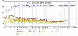

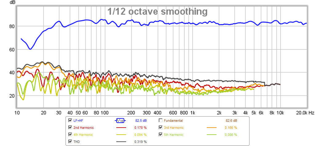

Measured distortion at moderate listening levels:
I really like the sound. Very natural and easy. The 4th order filter took care of any aluminum cone resonance I had before with a 2nd order filter. So it sounds very clean. The live sound signature of percussion is sort of there, the step response sort of takes a rise first from the woofer. I am listening more and will report back later. So far so good though.

An acoustic 1st order XO is only possible if the drivers are flat for at least two octaves into the stop band. I have been able to do 2nd order with four parts. At least I get the 12dB roll-off for a while before the drivers start to roll off and the XO becomes 3rd order.
Bob
Bob
Bob
I think that is sort of what I am getting with the 10F, 2nd order (12dB/oct for an octave and a half, then 3rd order). The woofer low pass appears to be a clean solid 4th order all the way thru though.
The verdict is in: this is the BEST crossover so far on these 10F/RS225 Ref Monitors. I have been listening all day with all sorts of test tracks and different genres. What is clear is that the woofer is now well controlled in that there are no nasties higher up to muddy the 10F's beautiful voice. It sounds sweet and clear and open. Like the voice of an angel. But the RS225 backs up that clarity with well timed punch and precision for great dynamics which synchronize the sharp percussive sounds provided by the 10F in perfect handoff to the RS225. This is evident in the phase plot, the group delay plot, as well as how uniform the distortion is through the XO range.
Congratulation X sounds as you find a very good IRR XO solution that is within scope of miniDSP and just fill in the flaws previous pointed out by 5th element and satx for RS225-8 alu cone, based your subjective experience description must sound awesome, enjoy 😀.
Going these steeper slopes when needed and at same have it as a hardware based solution (with out a computer) to repair their XO phase distortions seems you gotta tell loud and clear to family a miniSharck is a wish under the Christmas tree, then the LR4/8 and that style as shown by Barleywater is no problem 😛.

Regarding UMIK-1 verse UMM-6 looks like IR at post 641 is with new UMIK-1 and show same scheme as mine those two same mics do. UMIK-1 seems speedier to take off from zero line and shaper to get back again from 100% than UMM-6, is that correct observed.

Byrtt,
Yes, the UMIK seems to have a faster slew rate and also less self noise and harmonic distortion. If you look at the HD plot, the usual "trees in a forest" spikes of HD at the bottom that I had with my UMM-6 measurements are not present. The speaker is actually cleaner sounding than I had previously measured. I am running into a sensitivity issue with UMIK though - it says in REW that max signal before clipping is 96dB. Is that a setup error and are you experiencing that as well?

I haven't noticed any sensitivity issues with UMIK-1, mayby in reality i haven't the skills to see the problem can you hint me what to look for to help. But noticed in Microsoft sound system when found new hardware that mixer input level set it self to a very low into level for that USB device UMIK-1 represent for windows, and in that REW tap on MS sound system not supporting ASIO or WASAPI that setting would mean be very important to be correct and don't know if you have touched that one or need to. One thing i noticed thru time is even one have 4 or 6 USB physical ports to connect to it is not bad to always connect to the same physical port if one would like windows to use and remember the settings personal set for samplerate/wordlenght/volume for the device.
Bought my UMIK-1 at a miniDSP dealer therefor my correction file is the original i can download by typing serial number at miniDSP website, now for yours I'm curious in you have it from a pro calibrating firm Cross Spectrum Labs, how do the original that belong to S/N compare to the pro one then, are they close or not.

So you are not hitting a 96dB ceiling on your mic? I must be doing something wrong. The CSL cal does not come with absolute cal - which is supplied by UMIK cal file. I use same port each time too and native Windows USB driver for mics. That is what miniDSP says to use as there are no drivers for the UMIK, just cal file. When I get chance I will show the miniDSP cal curve vs the CSL cal curve overlaid on same plot.

No haven't hit a clipping level even I'm sure sometimes had run power amps more hot than needed under measurement.
That would be nice see a overlaid curve those two, it could be a hint what precision we get and if ones ambition application level needs it or factory level is fine.
Could it give meaning as TMM said over the worlds best mid thread, have a known reference baffle/driver measured and saved together with system settings, then you have a UMIK-1 saved measurement that could be used to check for drifted precision in future. And by that i mean when planet10 starts worry about what can be compared you then have some reference from when mic was brand new to check confidence.

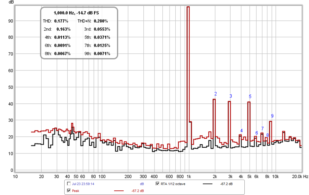

Here is my measured THD of the 5MR450 at 95dB: 0.06% THD!

It was good at 1kHz too (a bit higher at 0.177% THD with most of it as 2nd order at 0.163%). I am not sure why I only printed the RTA plot for 2k in the other thread. I dug through my data and found this - the SPL is closer to 100dB.
