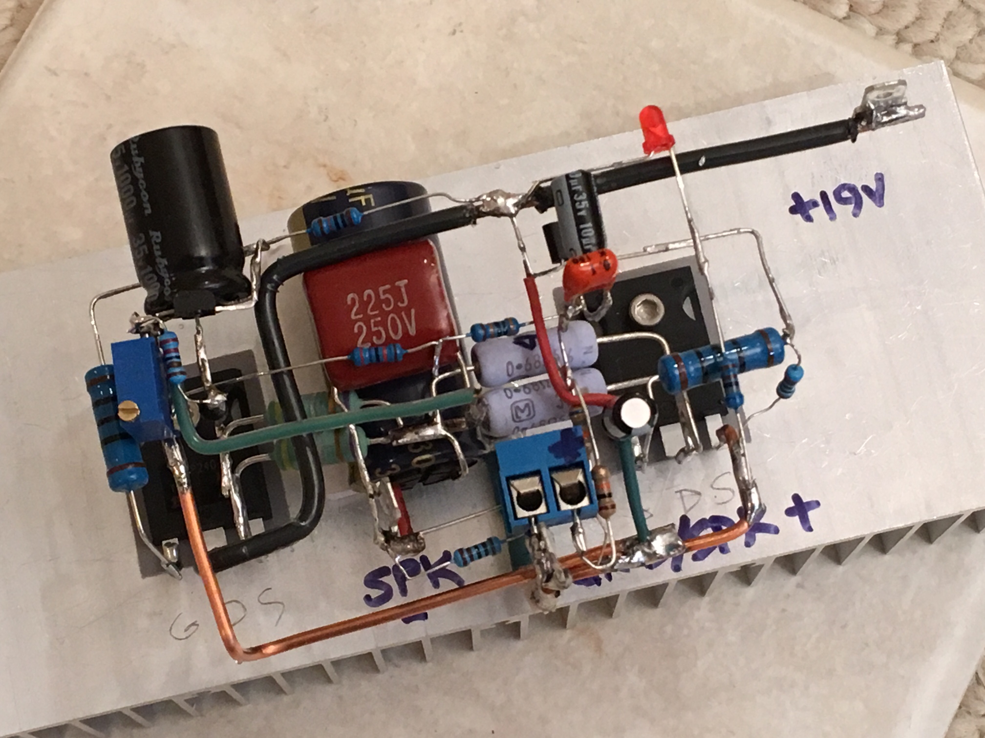

Here is my latest amp I am testing on this 10F/RS225 speaker: my dead bug Pass ACA class A amp. Running with a 19.5v laptop SMPS (22mV ripple) and sounds fine. Max volume is a bit limited (5w amp) but what you have sounds very nice. The bass is surprisingly deep as the amp impedance is very low (dual IRFP240 MOSFET's in a SE class A mode).
If you have a pair of IRFP240's, a 2SK170, and XTX450 on hand plus a handful of odds from your parts bin, you can make one in an hour no PCB needed.
Nice sounding amp.

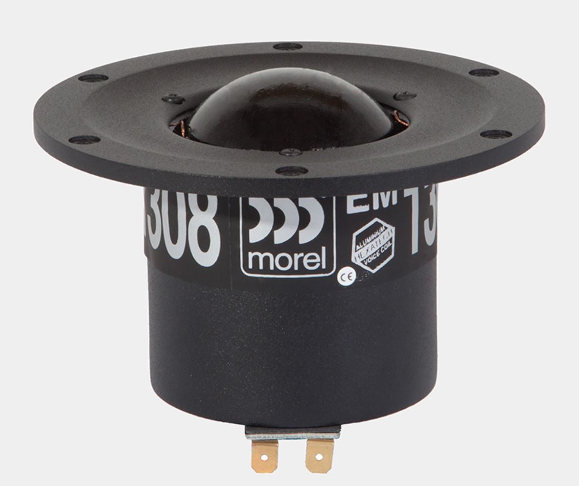

Lower cost, and, smaller faceplate/neo magnet so it can be more easily fit between woofer and tweeter allowing less problems with alignment when the listener moves around or is not in the sweet spot/standing up.
I'm not sure why Parts Express stopped selling the CAM-558 (version of the Morel MDM-55 with round faceplate). Though I did buy two pairs of them before they were discontinued. I also have a pair of the EM 1308 which I had meant to sell, but never actually got around to doing, perhaps because the price is a little too high for these.
