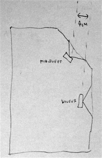

You can't make a passive Harsch crossover very easily because the requirement of a large delay equal to half the XO frequency period means large physical offsets and not possible to do with passive electronics.
ah, I see the challenge.
What about using fc at 800Hz the set-back would need to be 1 inch, but that's not awful. I was thinking of angling the mid-tweet to obtain the offset (see attached sketch)
Perhaps 800Hz is too high ? - but with the 4th order Butterworth the woofer should be OK with the higher fc.
Edit: oops, not 1 inch, but 8 inches :-(
