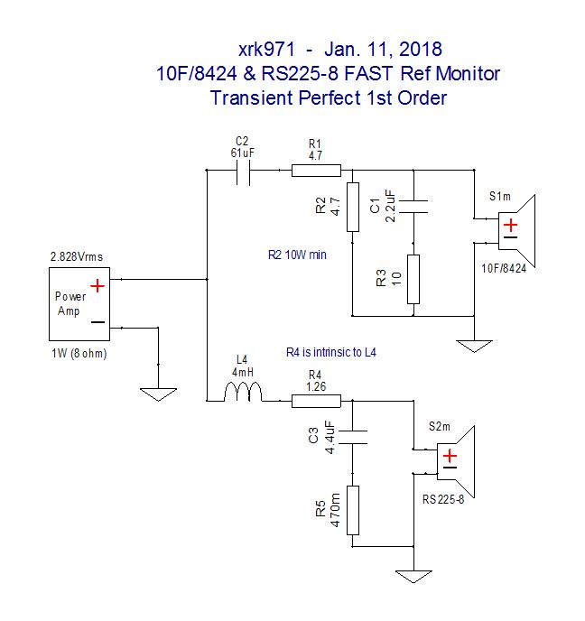

You can use almost any 3.5in to 4in fullrange driver that’s 8ohms in the basic crossover. Adjust R1 and R2 to get the right treble to bass balance. As it is voiced for a 10F which is 87dB, something less sensitive will require smaller R1 and larger R2. Nominally 4.7ohm and 4.7ohm. For less sensitive driver (or enhance treble) use R1=3.3ohm and R2=6.8ohm as a start.
Start with this schematic:

Thank you for the guidance! If I was to use the Pluvia I would also need to adjust the RC filter as well right? Is the purpose of that filter something to do with playing with impedance?You can use almost any 3.5in to 4in fullrange driver that’s 8ohms in the basic crossover.
