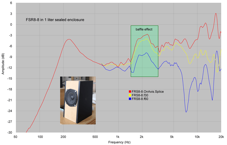

I have measured the visaton FRS8-8 myself and i also have measurement report by HOBBY HIFI (german magazine).Hi folks, Im seeing these two ~3" fullrange that has a decent frequency response for the $
Would you rate these better than the vifa tc9 fd $20 ?
while it is not bad, it has some resonances that show on the waterfall plot. I can post my measurement results later, if you are interested.

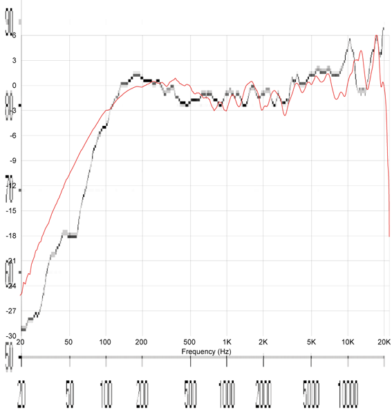

here is the frequency response for Visaton FRS8-8, on axis, 30° and 60 °, in a small box. low frequency was added as nearfield measurement and is not very accurate - resonance peak is probably too high. I was not fully aware of how difficult stitching measurements actually is, back at the time.I can post my measurement results later
note the peak around 2kHz is caused by the baffle, not the driver.
my driver is rather old (~15 years), also has a much higher Fs (176 Hz) than specified by visaton, so maybe they changed and eventually improved the specs in the meantime.
EDIT: added another graph with spec sheet frequency response (black) with added frequency response measured in a 100/50cm baffle, equalized for infinite baffle (red).

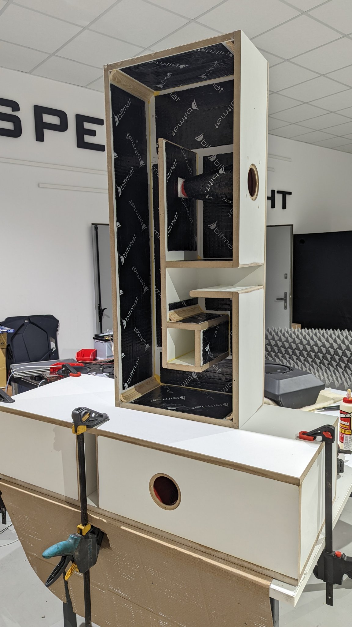

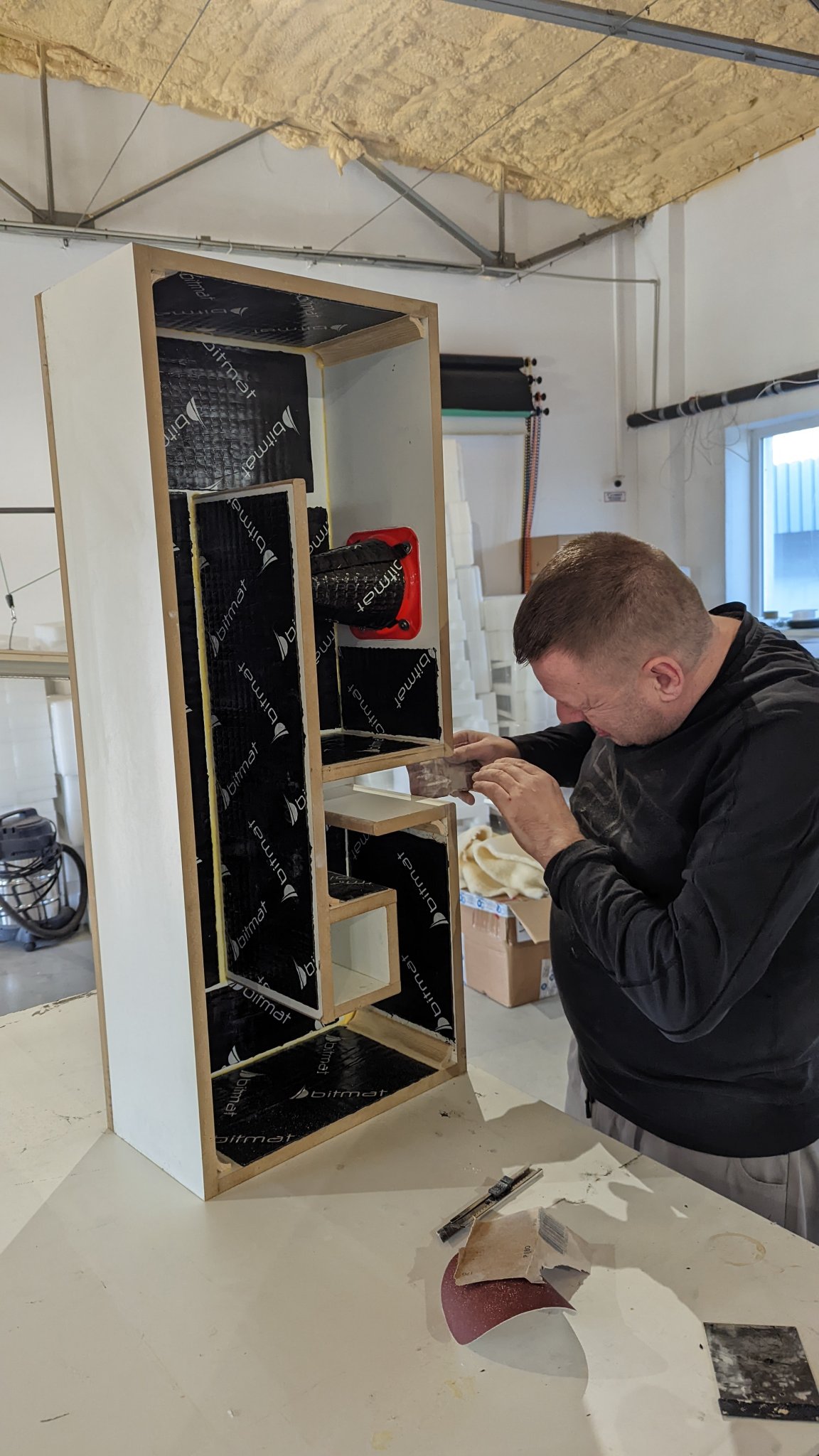

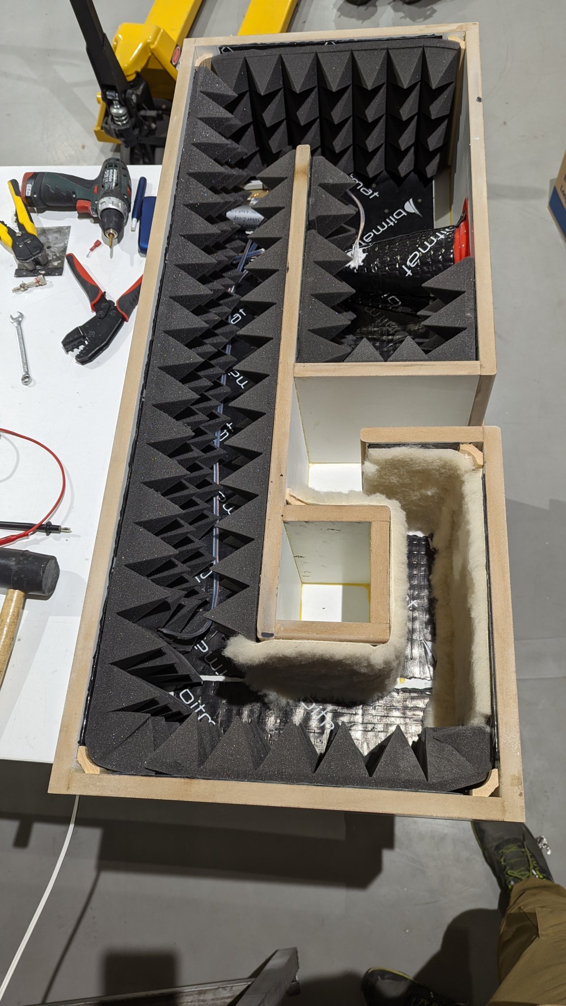

Hi. Greetings from Poland. I'm so happy that i found that project I'm was planning for so long time to build fast system.
Add some pictures from progress
Hi Rxr2,
Super work! Very cool to see another one of these TLs coming to life soon. You are using extra tall “eggcrate” (actually acoustic wall treatment) foam so I would be careful using double wall layer on the long stretch going from top to bottom. That might be too much constriction of the flow. I would remove one layer there to make sure you don’t block too much flow. Hope it’s not too late. Lower profile rounded eggcrate foam would be fine to use both layers. Good luck with building and first sound!

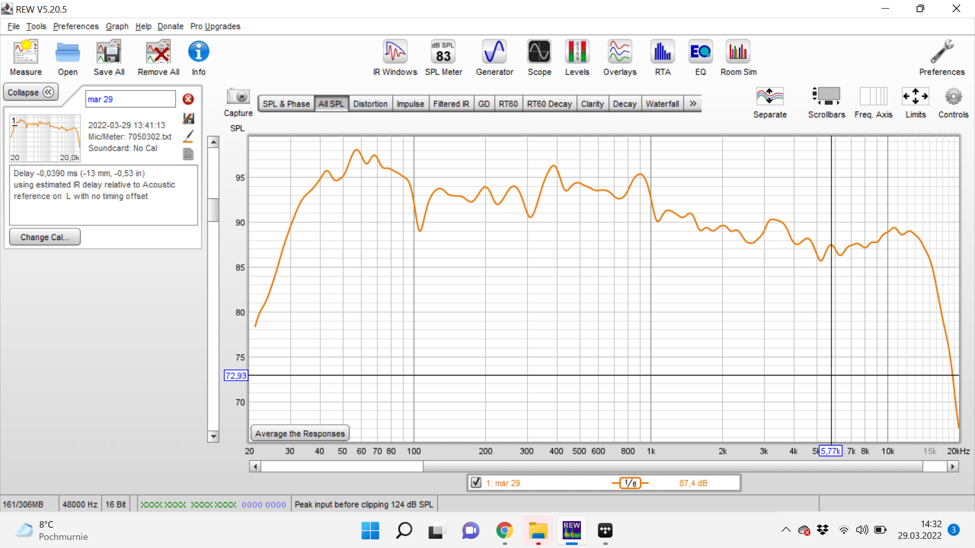

I have same doubts about to much dump on back side. So tomorrow I'll cut hole for main speaker and I'll remove rear form from inner section. That will solve problem. Any way I'll make measurements in Rew and share with you both solutionsHi Rxr2,

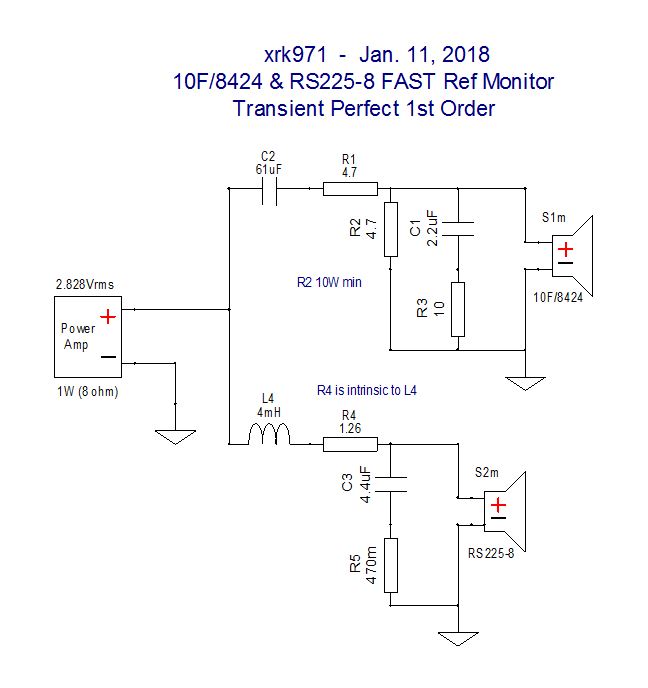

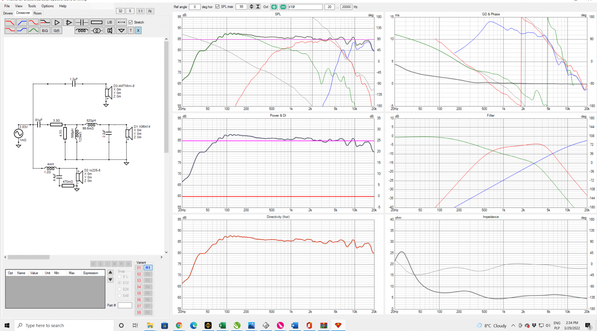

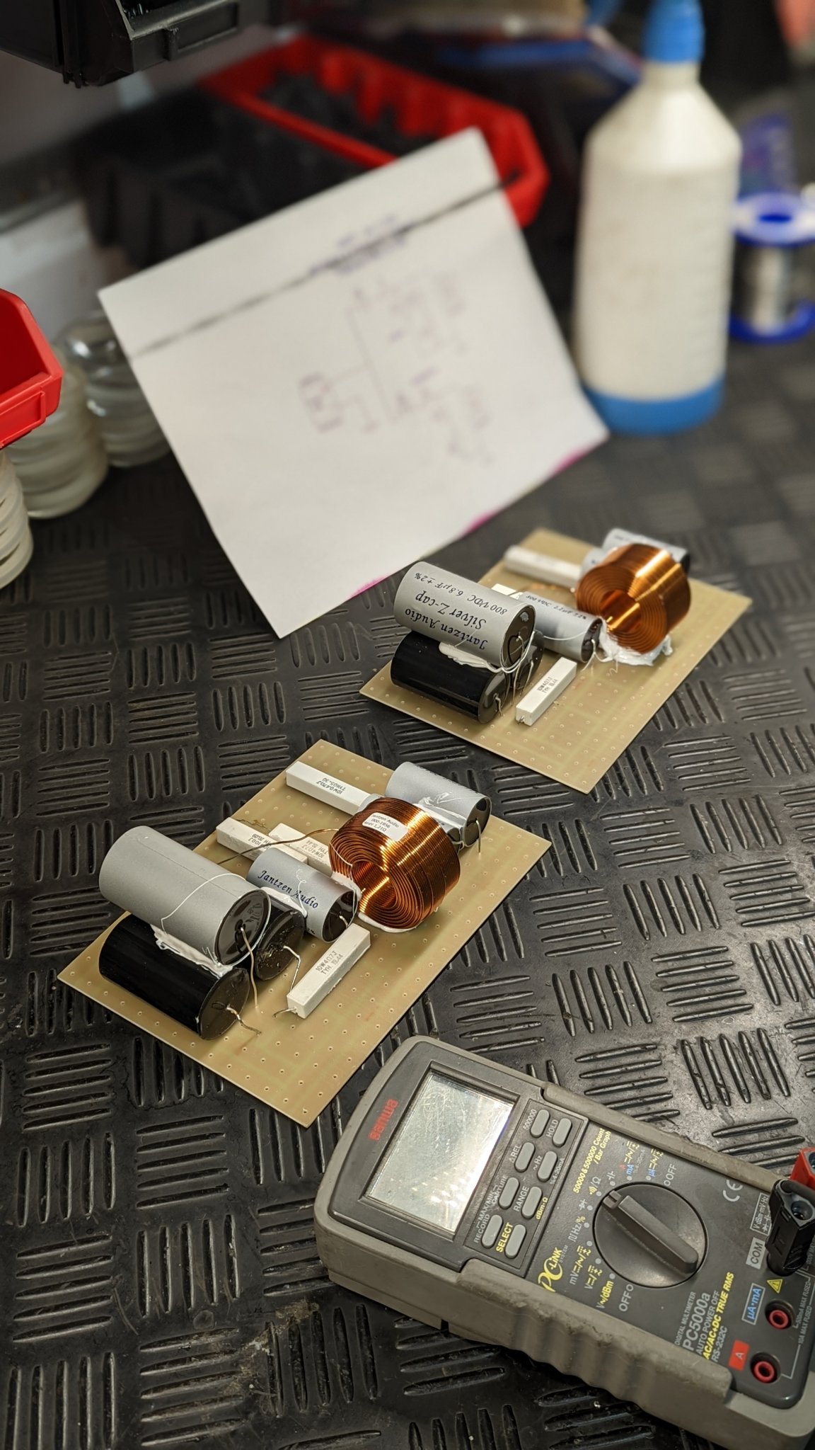

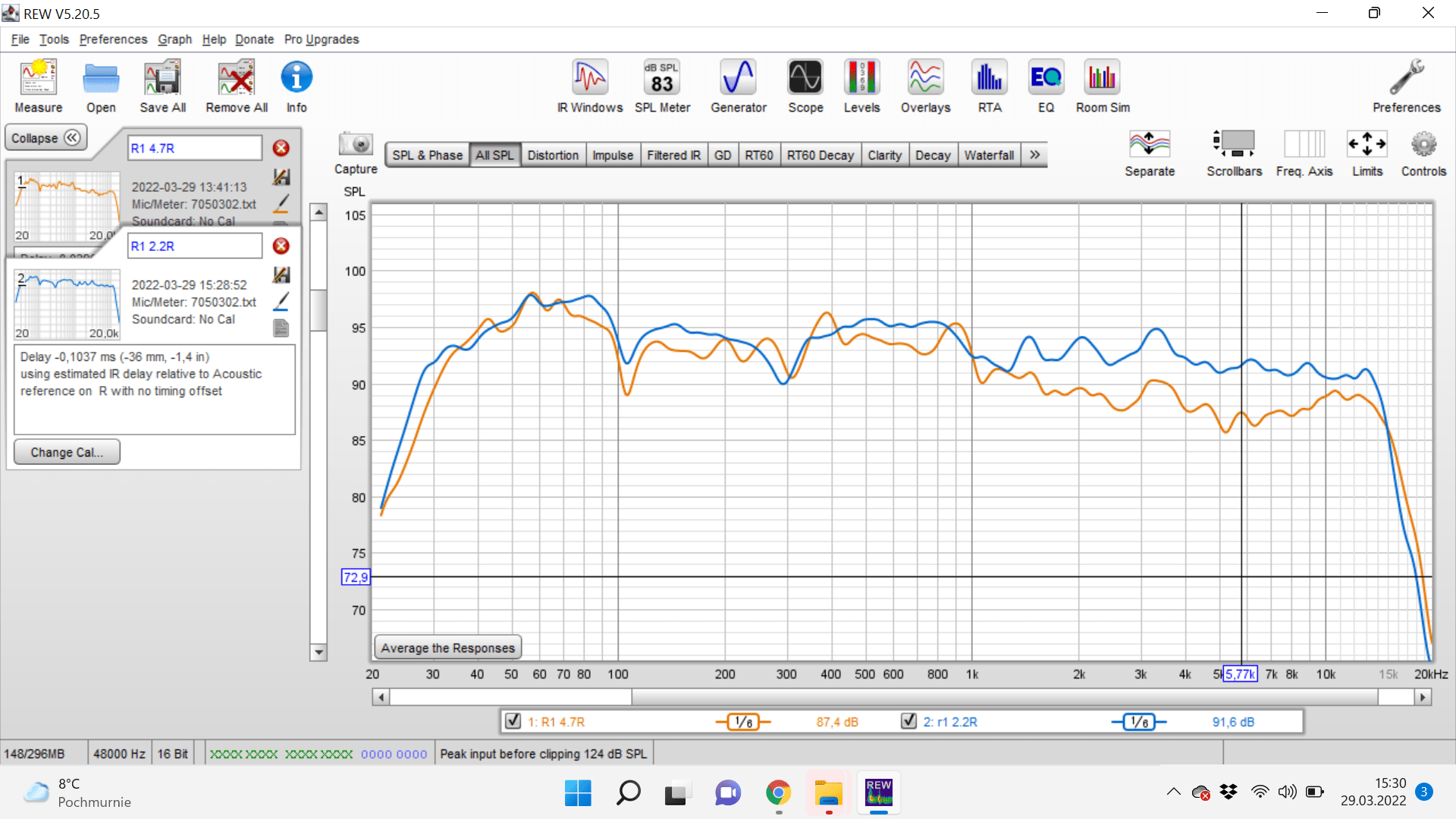

Eh... I made mistake and ordered the wrong speaker instead of 10f8424 I order 10f8414. Now I suffering from low trebles band.
So please advise me if you can, I see 3 options:
- Order correct speakers (10f8424)
- Mod XO r1 and boost fullrange band
- More crazy but make sense in my opinion add a small tweeter like AMT mini-8 and redesign XO (add my project XO)
Hi Rxr2,
10F/8414 is fine, it’s less sensitive than the 8424 so just adjust the resistor padding. Try R1 = 3.3R and R2 = 6.8R to bring up the treble. Or you may need more polyfill stuffing behind the woofer to reduce the bass. Do an impedance sweep to see what the peaks look like. I think adjust it until peaks are about 20 to 24 ohms and minimum saddle around 11 to 12ohms. Saddle minimum around 36Hz would indicate TL is working without air leaks.

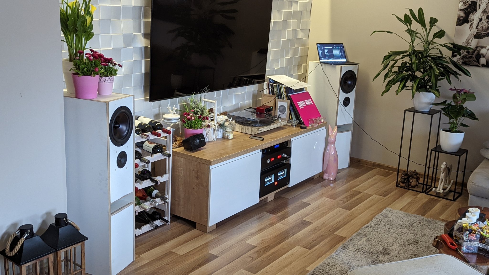

I have to say that it sounds terrific! I'm really enjoyed. After adding polyfill and adjust R1 and R2 on my hand made tube amplifier and DAC sound perfect.
If some one looking for very high end tube amplifier i can say only that one http://www.audiodesignguide.com/PP2011/PP2012.html
I made several tube amplifier in past base on kt88 and b300 but that one is different in best way.
Back to the topic. I'm impressed how that speakers are transparent and free from distortion. They are one my best for peace and calm music enjoying.

Hi Rxr2,
Congratulations on a super build and another TL is borne in the wild! It’s a special speaker and so glad you were able to adjust the resistor and polyfill to your liking.
Enjoy your creation and please report back with your listening impressions once you have more time to listen to your collection.
