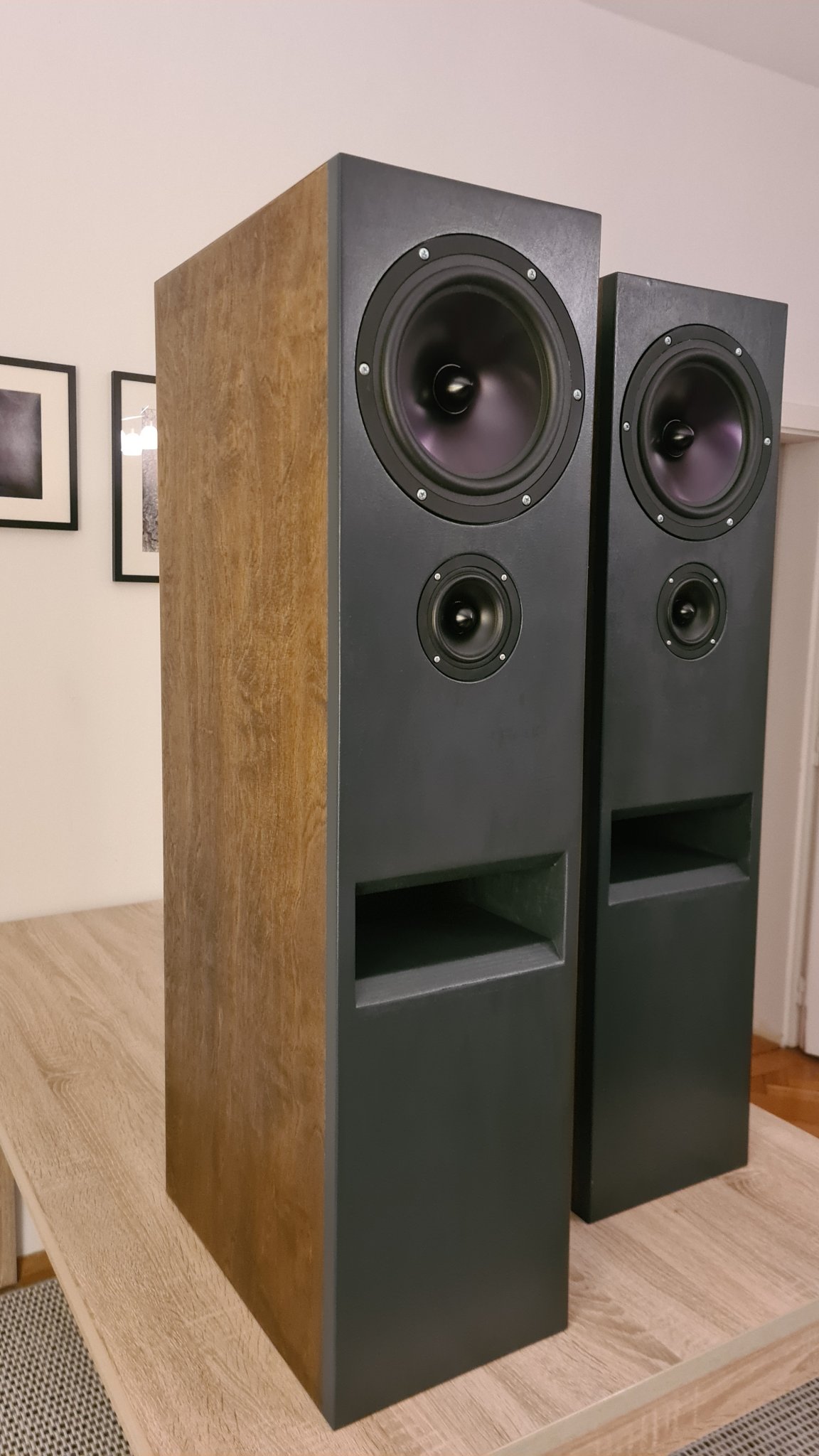

Just finished my TLs, after some recovery. I'm glad 🙂
- Full Range
- 10F/8424 & RS225-8 FAST / WAW Ref Monitor
