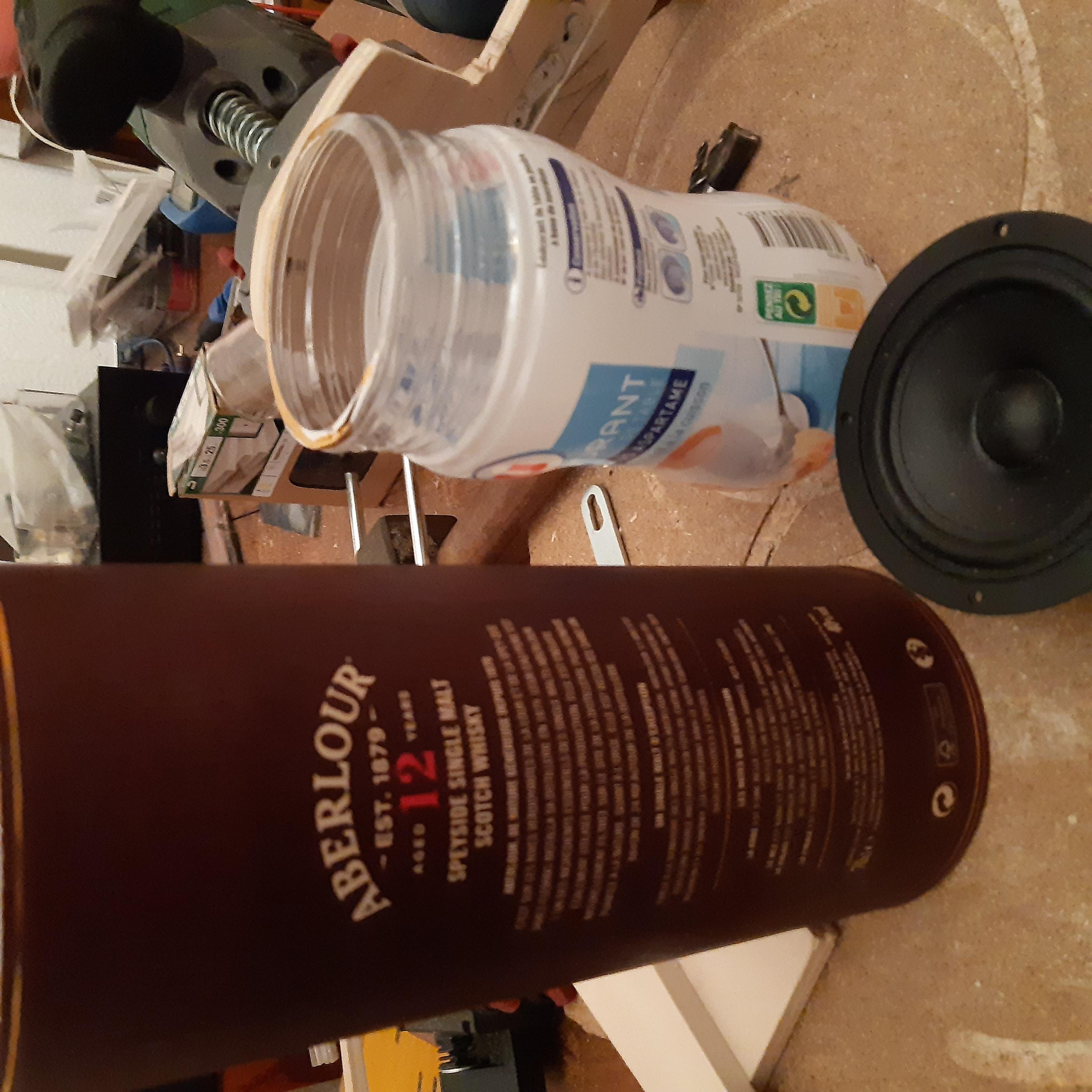

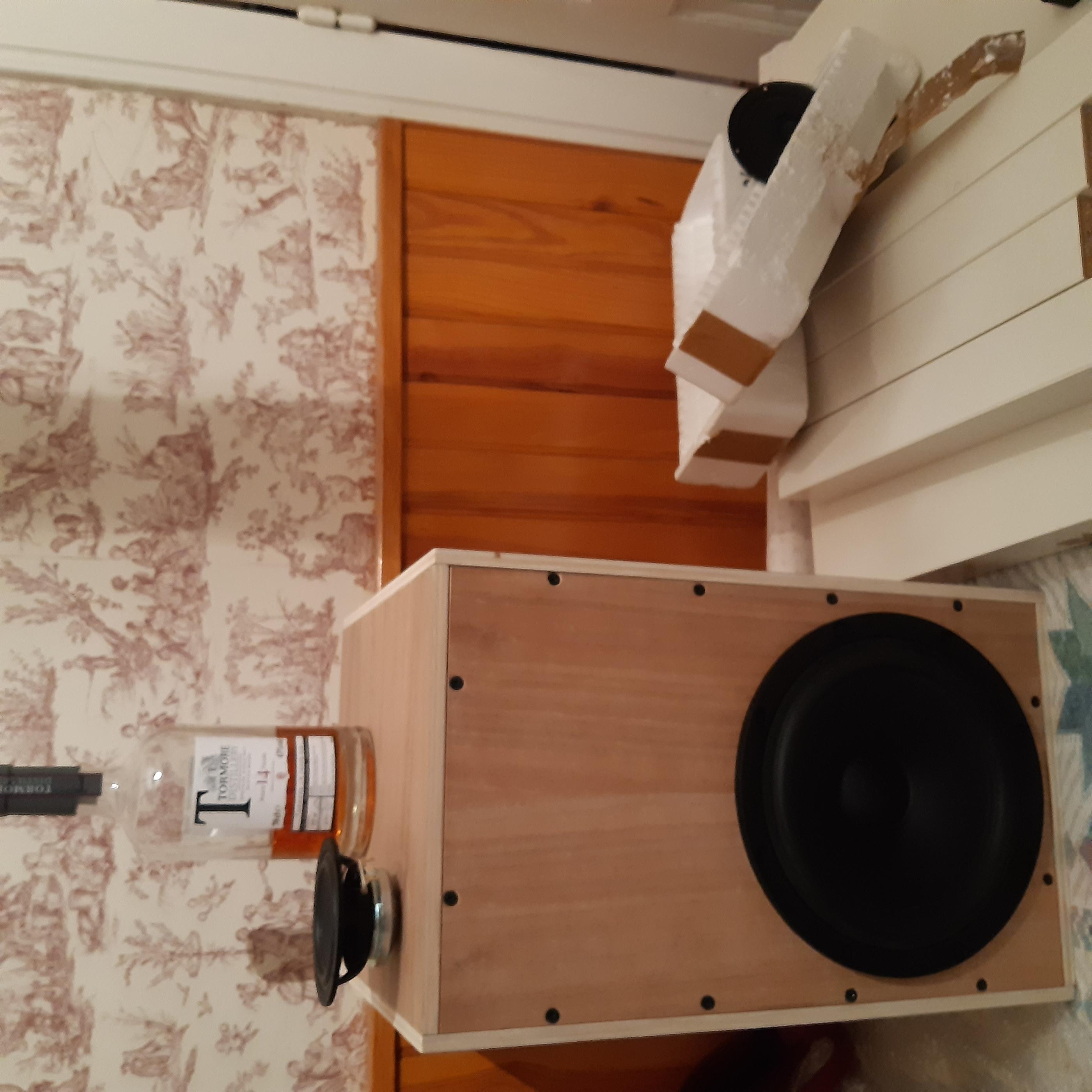

As it's a sort of Dayton, certainly close enough, my SB23NBAC-8 (aluminium cone too, the SB having a difficult 5° harmonic rise at around 1300/1500 hz that needs padding so an early enough XO) I will try the classic first slope. I'm passive so Harsch XO is not possible due to the long horizontal spacing needed there instead electronic delay -though one can certainly do it with serie inductors-
Instead the pyramid dagger I use Whiskey bottle can that gives a > 2liter load sealed which is near the ideal 0.55 Qtc when upgraded with wool stuffing.

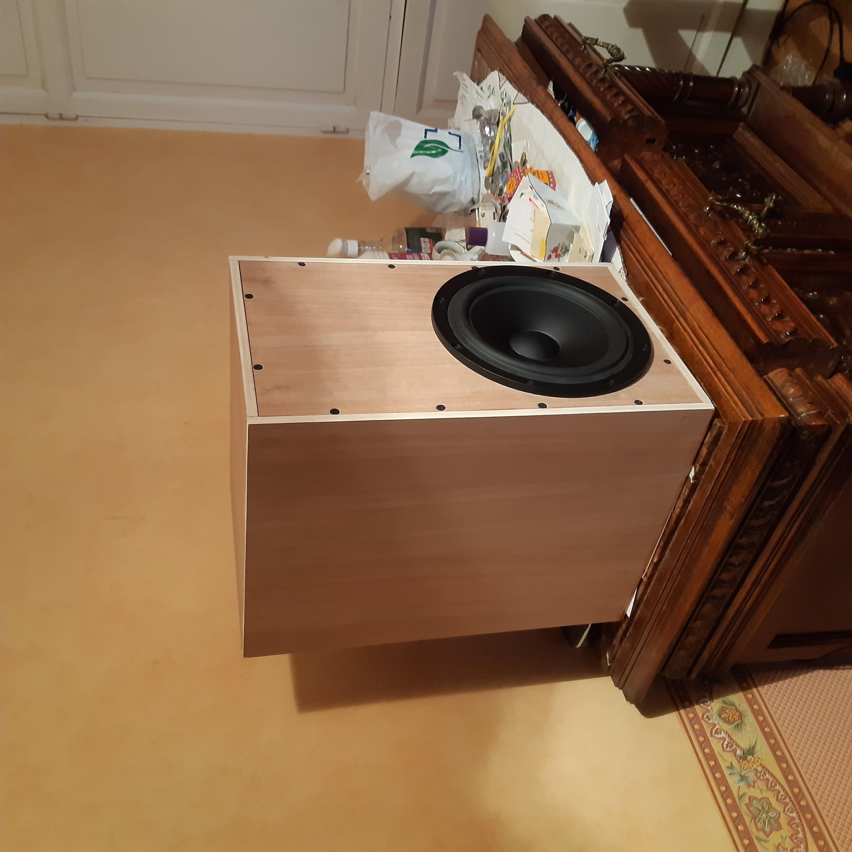

I wanted mine like an Harbeth construction style (BBC) I called it the Hard-bet due to my bad hand skills- for trying several drivers arrangements, so screwable fronts. the one with the 10F below for extra phase -as designed by Xrk971- delay as a classic offseted one or a 3 ways if needed with a different XO near transcient perfect : a JMLC third order or even a classic LR12. Of course I will testimony here only for the two ways with the 10F as FR.
Main enclosure is around 26 liters sealed. But as the back is screwed as well as the front, it's easy to change a panel for a vented port or an aperiodic port.
Notice on the top the little 10F near the bottle I of course only drunk for the outside can 10F load. - second bottle almost done- 😀

Whisky bottle! Love it - but beware of hard surface reflections. 11in soccer sports cone/pylon is easiest.
I like the look of the BBC style box with removable front inset baffle.

I use the bottle can -in brown on the picture- that is a little more than 10 cm diameter but easy to glue as it's hard board chip and I put inside a non symetric plastic bottle ( false sugar plastic can as per photograph, mineral water bottle can do it...and of course wool inside and between the main and second internal can too) to break the main symetric resonance... same goal than the non symetrical pyramid foam damper you use !
My skill are really bad, all of that begun with your 2.5" drivers tests. I bought the 10F I liked and recognized the SS sound from the poll competition you ruled (quite neutral this driver with a top end none can cop with as far FR is concerned) to build the foam horn I never succeed to make - God bless people with hand skills-.

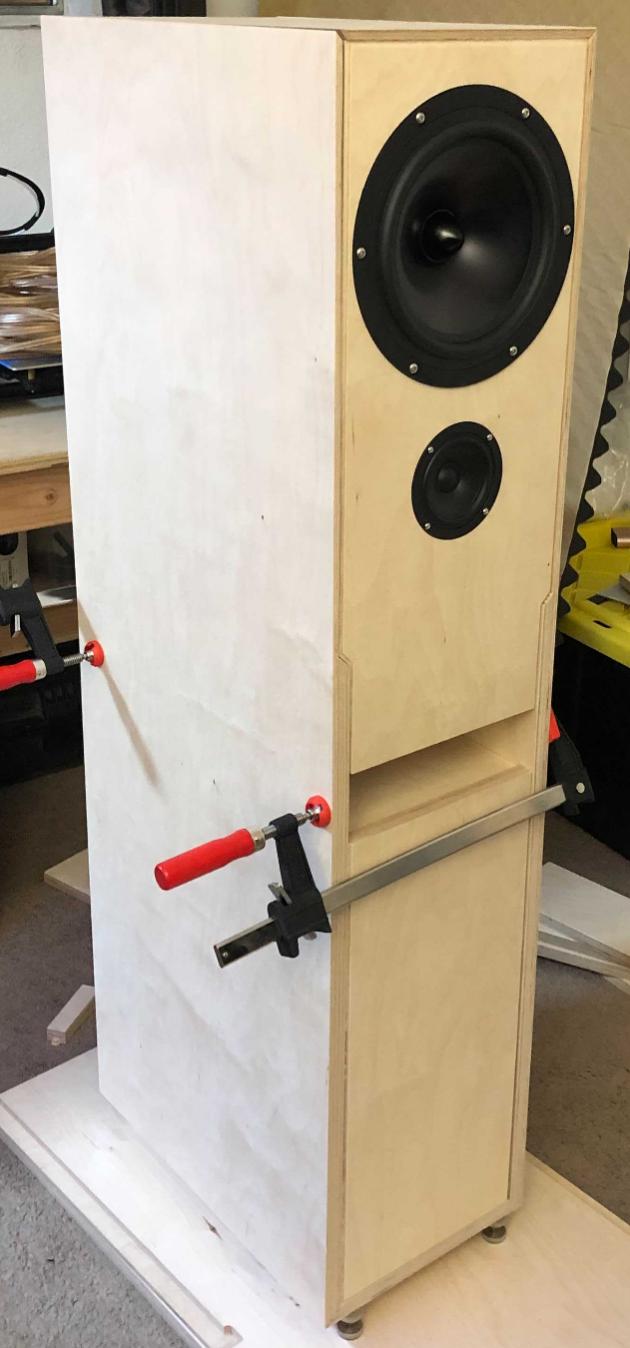

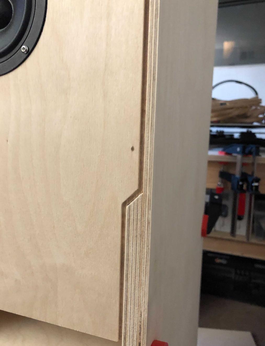

Small update, got all the CNC parts back and spent the day sanding parts down and verifying fit. The cabinet has a 3" spacer at the bottom as per some comments on page ~250 and a couple of smaller details were added. TL internal structure remains faithful to the original schematic. Hope to have them wrapped up within a few weeks if scheduling permits.

Hi AS8912,
Wow! Beautiful construction details like the little jink in the front baffle to have hidden end grain towards the top. 45deg bevel mitered corner joints. Superb. Maybe consider adding a round over or bevel to TL vent edges? I like the feet too.
Looking forward to your listening impressions.
X
