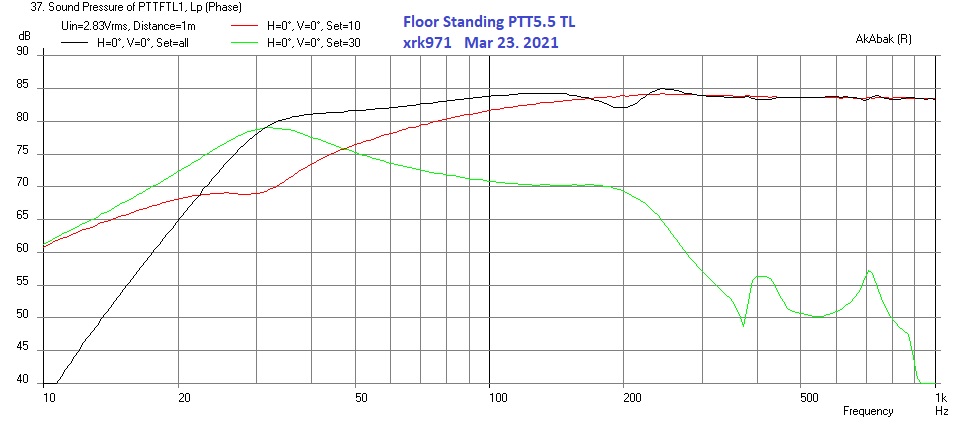

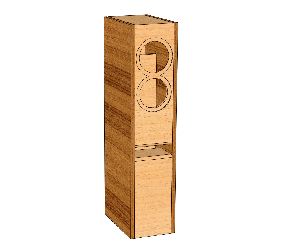

For fans of this style of TL, I have designed another one for the Purifi PTT6.5 driver to be used with an RST28F dome tweeter in a WG300 waveguide. It has a passive Harsch crossover that is quasi-transient perfect.
Simple Passive Harsch XO Using PTT6.5 and RS28F in a Waveguide
40in tall x 9in wide x 14.25in deep, all 3/4in BB ply construction. Woofer goes above tweeter.
The Purifi woofer is one of the lowest distortion and flattest response drivers ever made and it is operating almost like a full range with XO point at 3.5kHz.
84dB nominal sensitivity after baffle step loss in 4pi space. Bass extension is -3dB at 40Hz and -6dB at 29Hz. With room gain, response down to 30Hz should be nice. This 6.5in sounds like an 8in in terms of bass capability but at the same time can handle nuanced mids very well.
