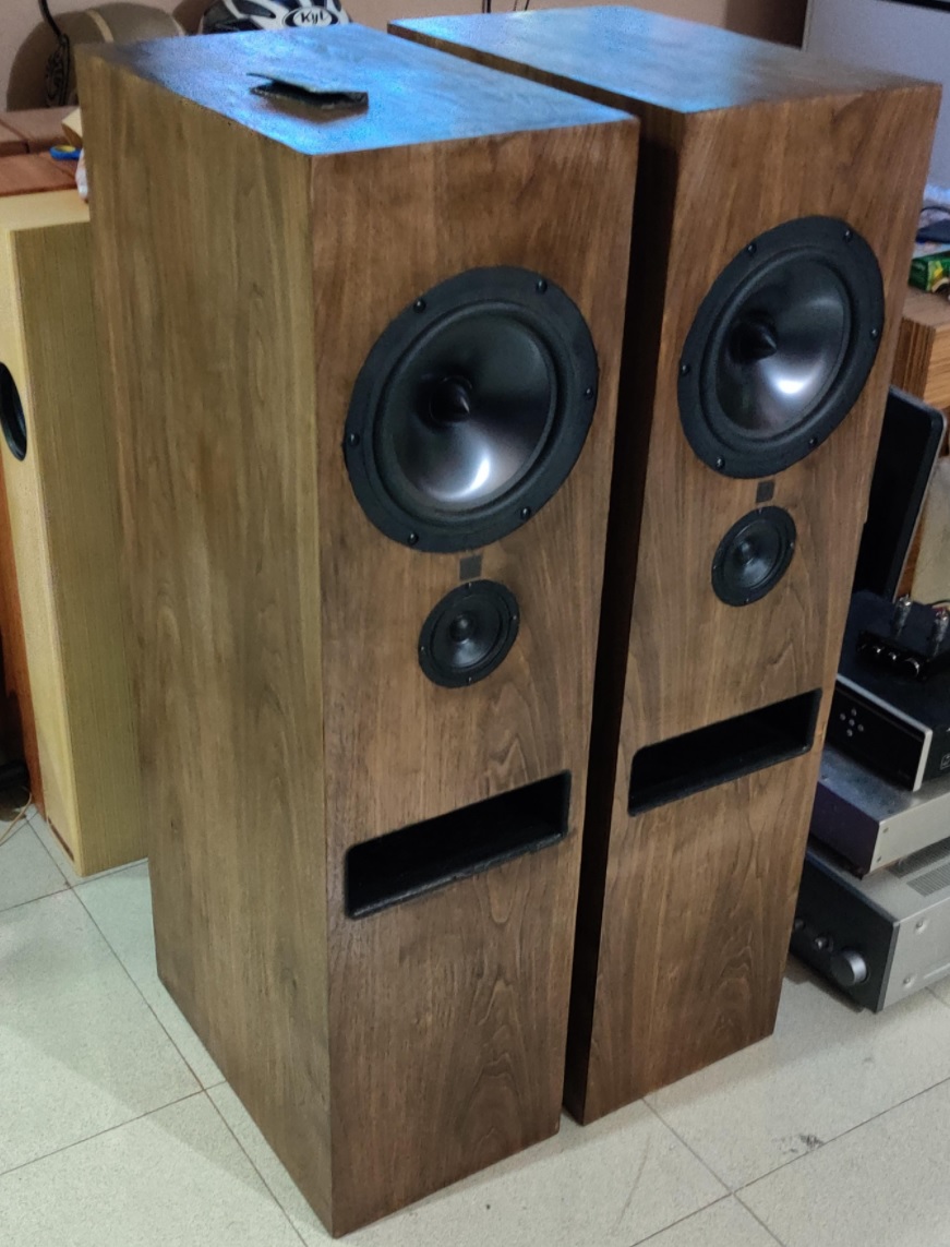

Hi X, and others who have built the floor standing TL. How does it fare with big orchestral music such as those from R. Strauss, Bruckner and Mahler?
You mean this? Very attractive driver and a good fill in for the long discontinued TG9FD-08.
Scanspeak Discovery 10F/8414-00 3.5" Full Range
$29 is a great price.
the Spec is way different than the expensive 8424. I Wonder how it's sound
Not sure for Orchestral Music, but I've listened to instrumental music like Kojiki Kitaro, It sounds wonderful, all the music is real, the music sounds real open and straight.
But one thing my friends hate about this speaker... I makes other speakers sounds bad. The sound difference between this speaker and commercial ones are clear once you listen to this speaker for 2 hours while chatting and having coffee 😀
Love that.😀
Thanks for the nice compliment of this speaker. I am glad you love the sound. I do have a hard time finding commercial speakers that sound as good. They set a high bar that’s for sure.
Your build is superb and I know you are getting some enjoyment from both the sound and how they look.
