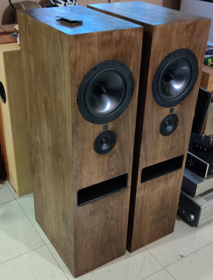

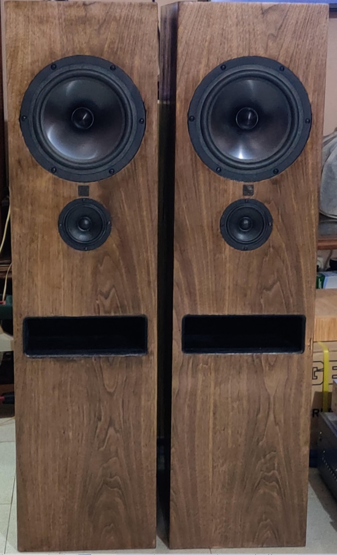

Finally, I have completed veneering with real rosewood veneers.
For the RS-225 I measure approx 350-400 gram of stuffing is really good to my living room. More than 400 I heard bas is heavier but sound so muddy. Putting 360 is the best bet where I got clean and punchy bass that I really like.
For the 10F I put 10-12grams. I tried 20 grams the mid-low is really nice (kind of mellow sound). I put 12 grams to get clean treble without sacrificing mid-low. All have trade off so we need to ensure adjustment is performed in actual position.
Finally, Thanks X for such an Incredible design. Now I can have a loud speaker with so much better performance than my bose.

Very nice work, Mas Penk! They look beautiful and so happy the sound is pleasing to you.
Thanks for the quantitative measures of stuffing. Very helpful.
Btw, your box is taller at the top above the woofer. Did you modify the design somehow?

I just re measured again, and yes aparently i misread the dimension from top top to center
I read the top to center of RS-225 8 inch where is supposed to be 6 inch...
is it really affected the sound? because What I heard so far is really nice...
No worries - it’s a very minor effect and has to do with trying to reduce the acoustic reflection of the TL terminus - but with all the bends and stuffing, it is not a big deal. Your driver height from ear level is maybe a bit lower but that might be good depending on your situation. As long as it sounds good it’s fine. It certainly looks great.

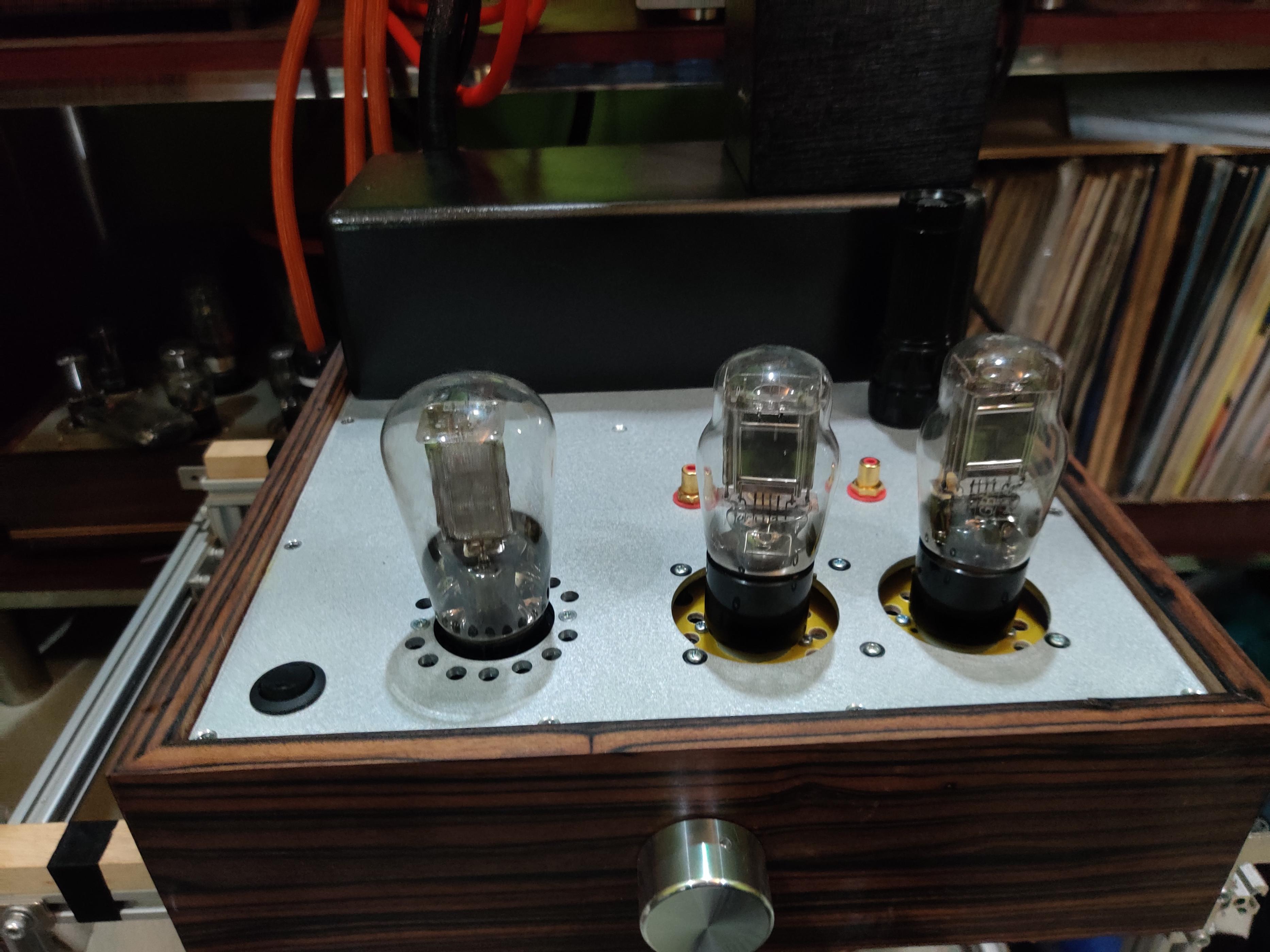

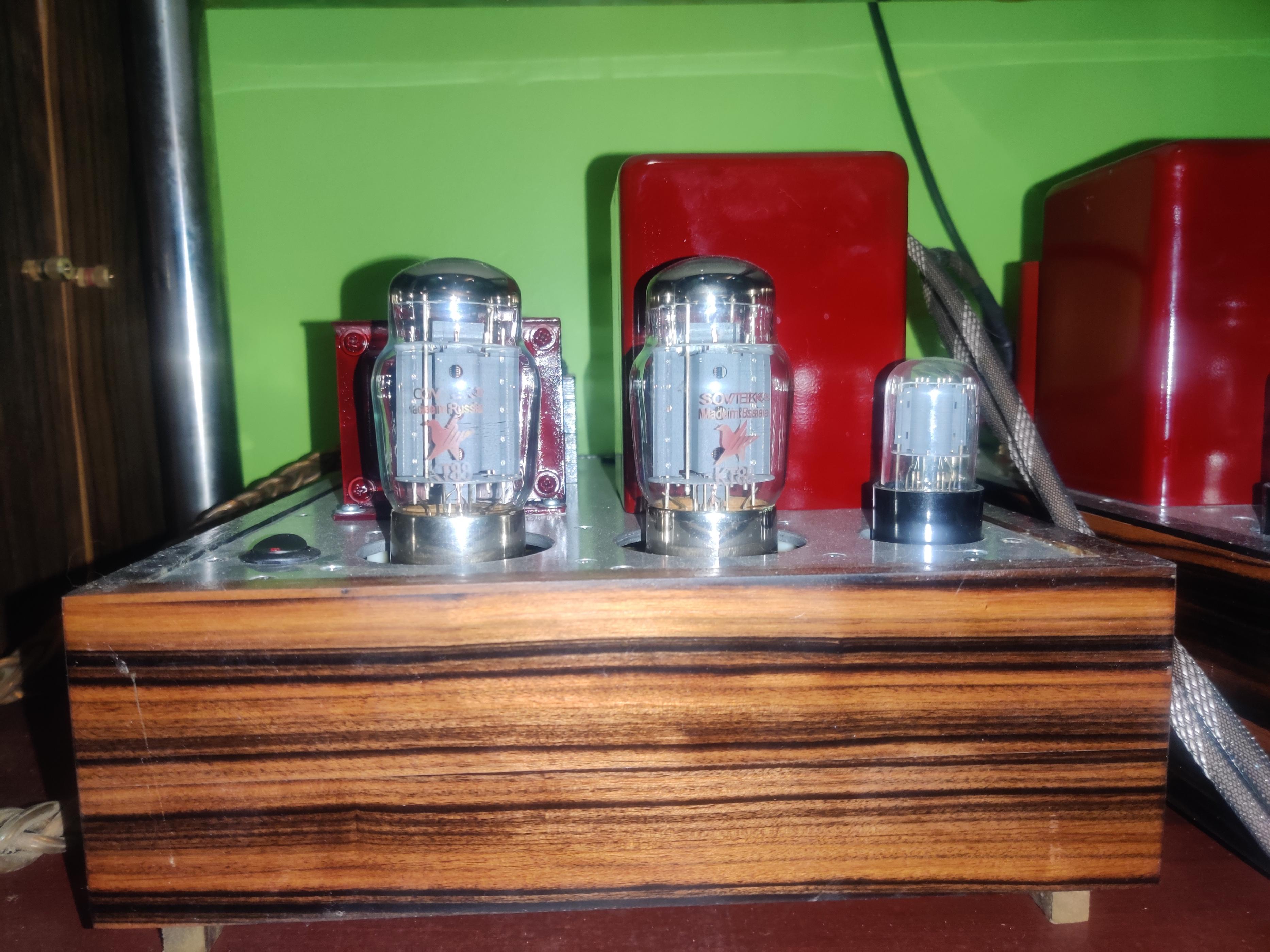

I tried several music from Alan Walker, Red Hot CHhilli Peppers, Sublime and secveral oldies song which I know they used Double bass. I also played with ladies singer (Susan Wong, Diana Krall and Jin Chi) to see is the voice is clear or muddy (this is where stuffing won 10F really plays)
I played with My own Preamp using tube CV-249 and gyrator.
For Amplifier, I tried with Odd Watt KT88 (OT James Transformer) and I compared the sound with NAD C372
