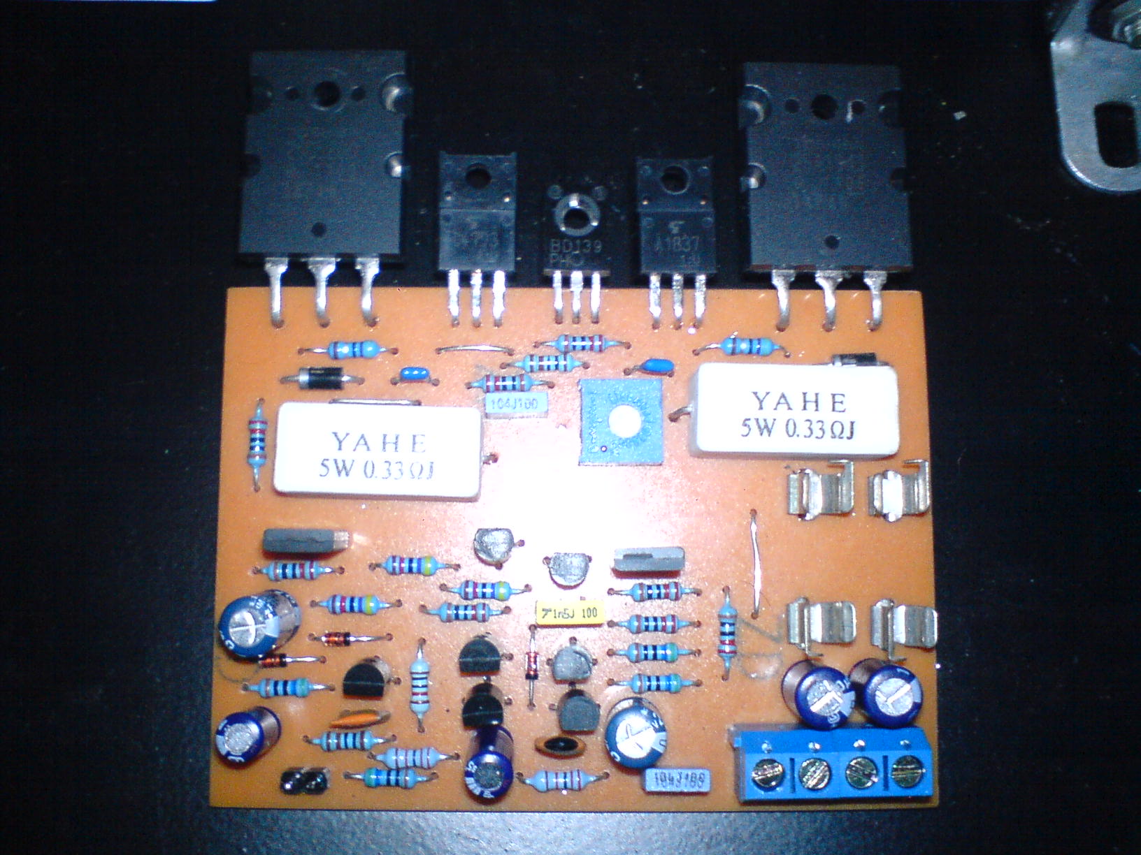

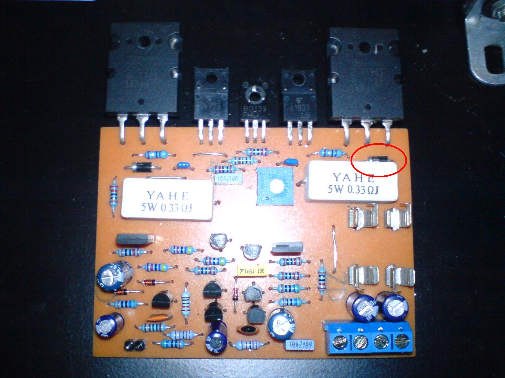

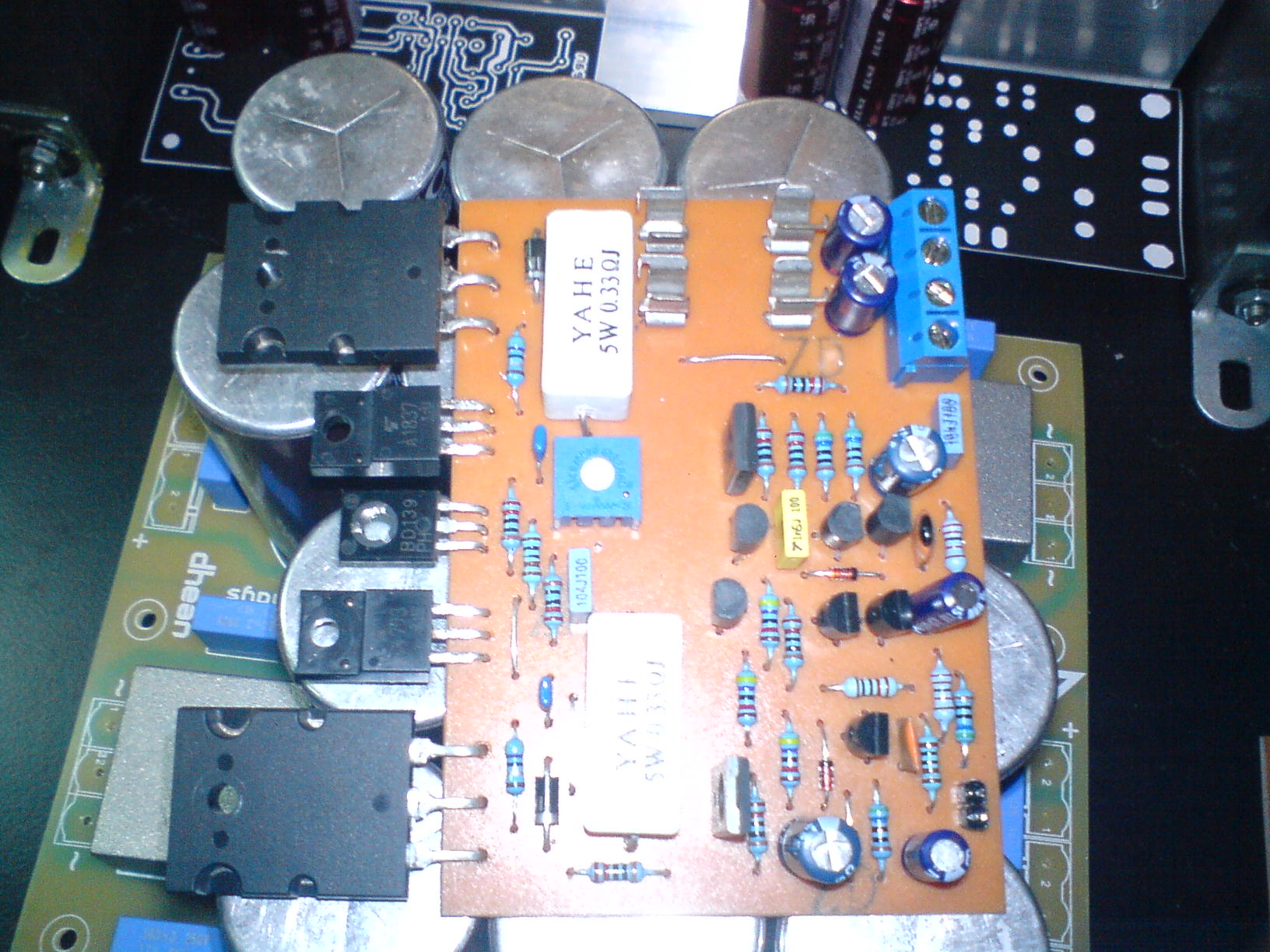

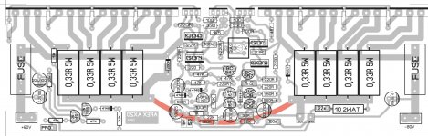

need help
Greetings all. please help what is wrong with this amp. when dc in connection directly fuse burning?
Thank you so much
is very fantastic

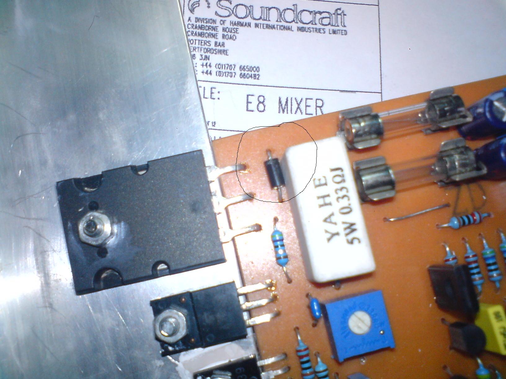

1N4007 wrong polarity.
Thank you for a very quick response, I already fixed the position of races. and the sound of this amp is very fantastic. . clear, deep bass,

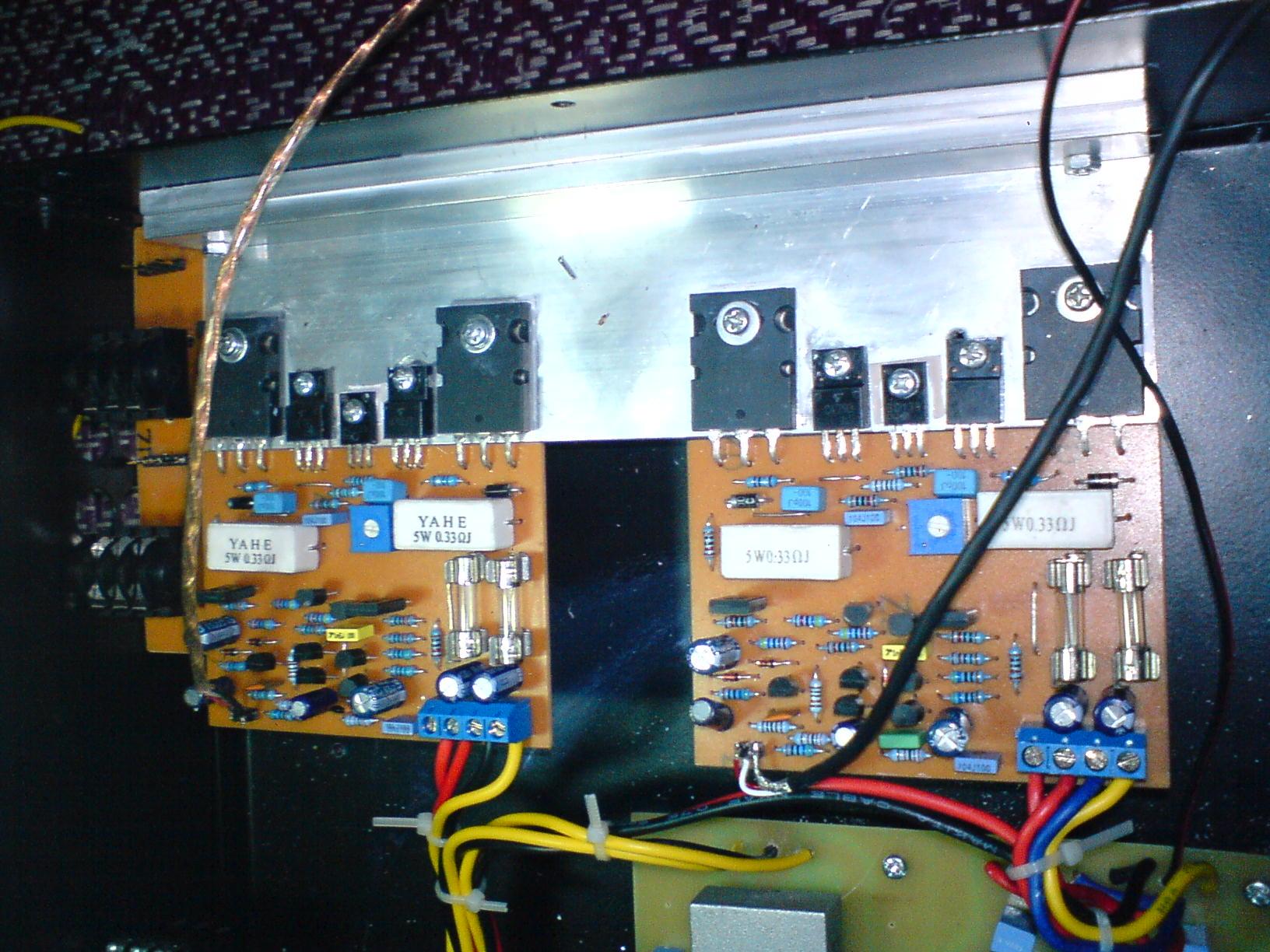

Greetings to all, thank you very much for the apex audio
