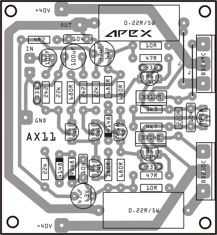

i am sorry too my friend 🙂Greetings. mine use this layout

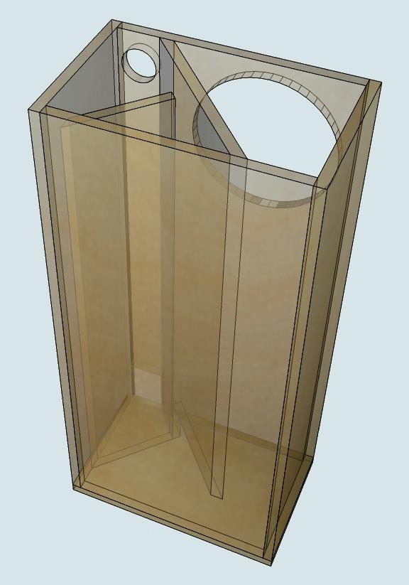

T Line for 8 inch driver, size 36x22x80cm
T Line in 3D

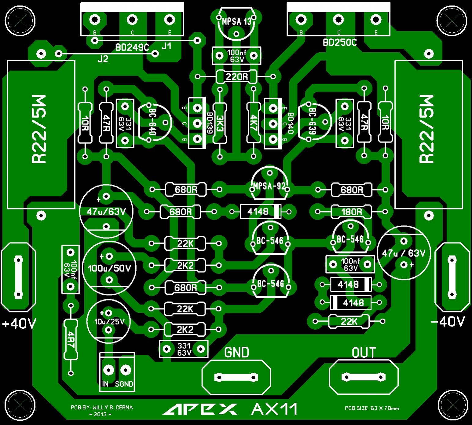

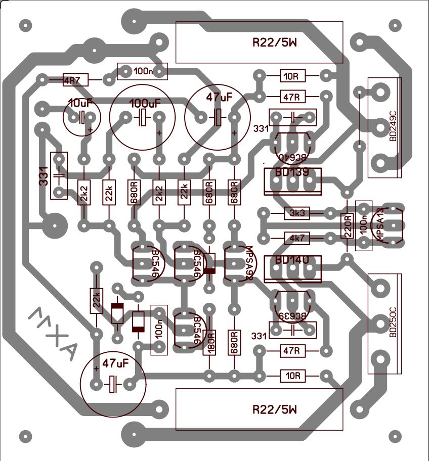

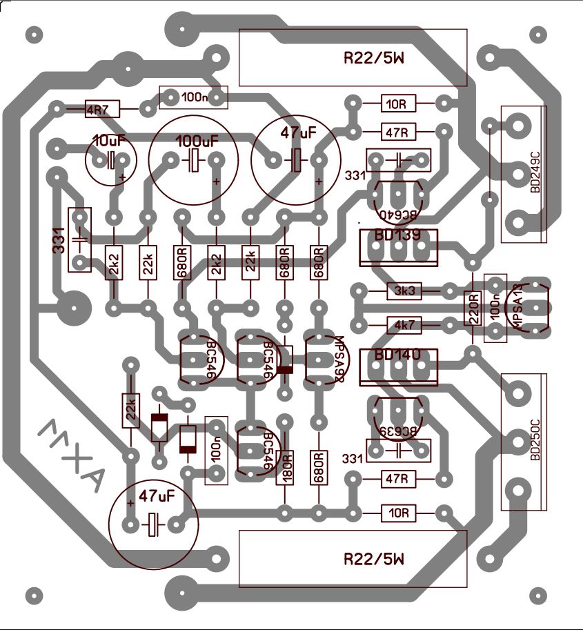

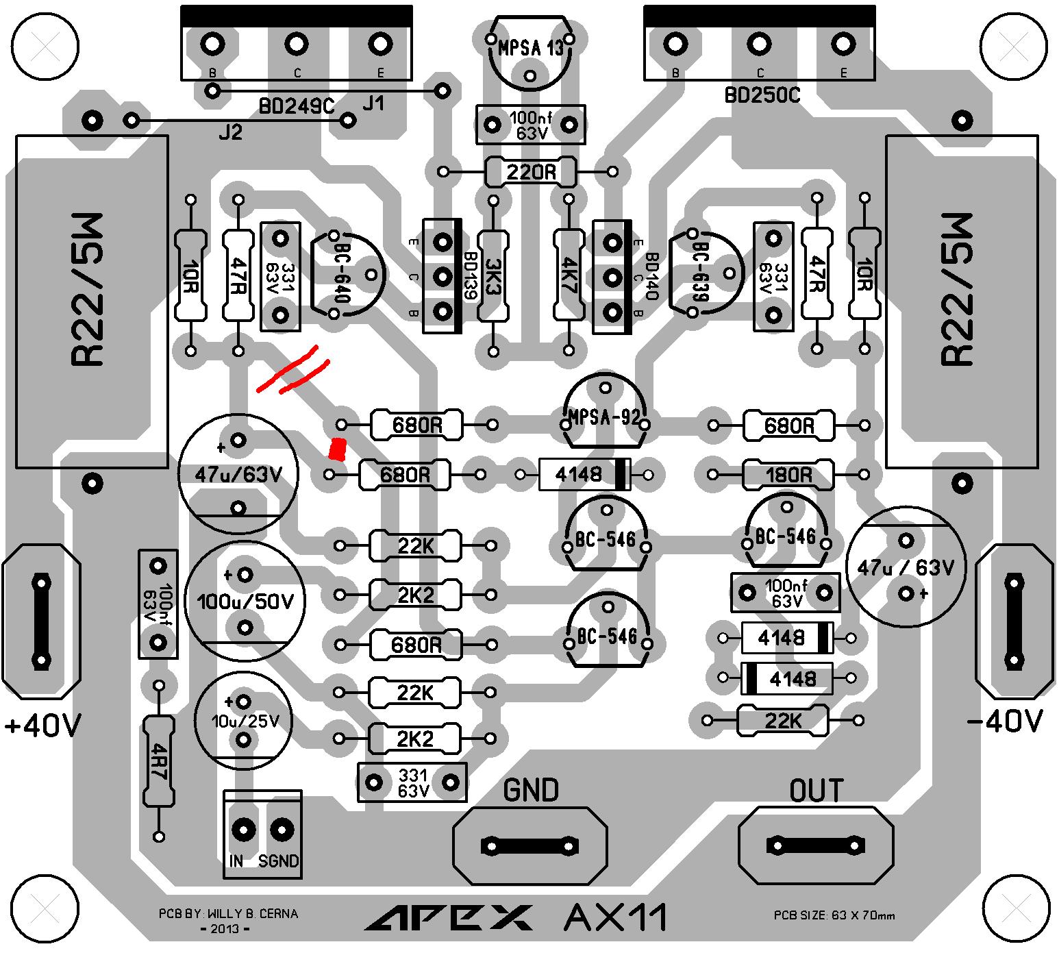

I made a small layout for AX11 to use components from the shelf for a test. Looks like a nice little simple amplifier for my kids. Hopefully I'll find time next weeks...

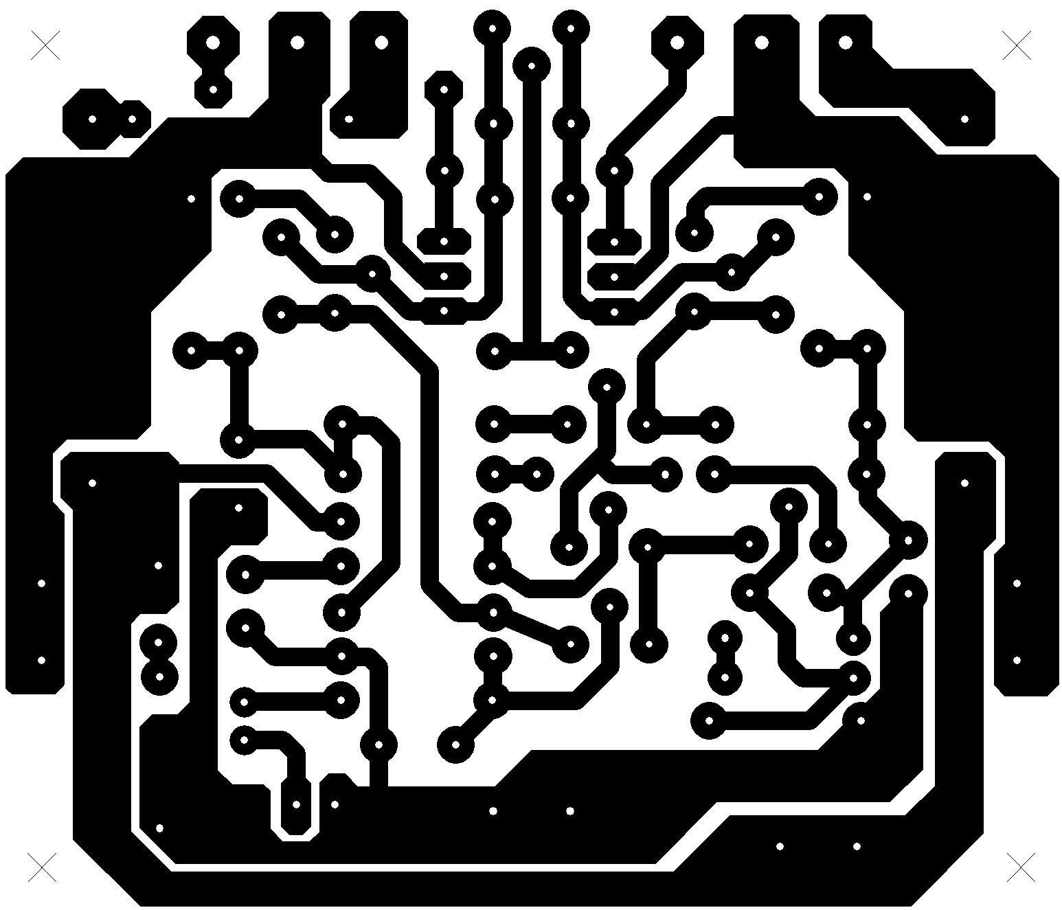

Nice work, but some tracks missing... can you share your PCB?

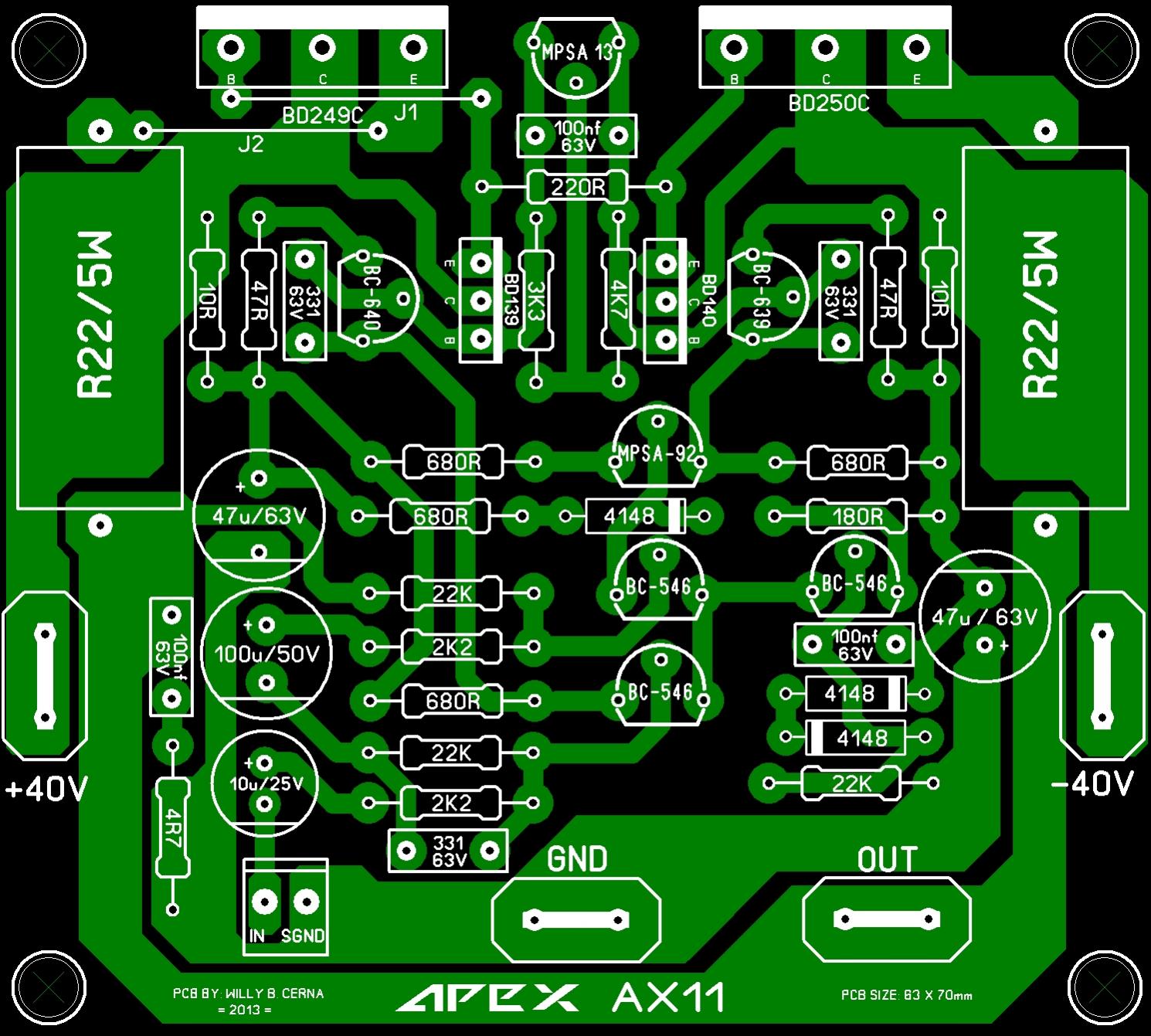

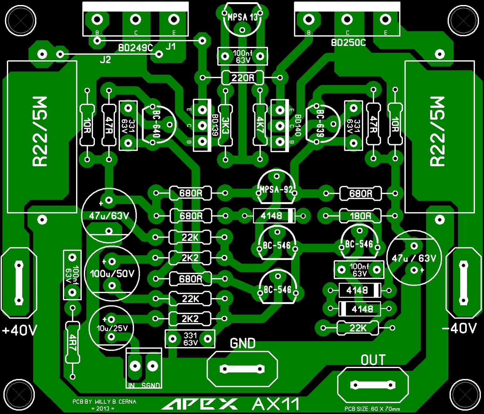

Here's the corrected one.....

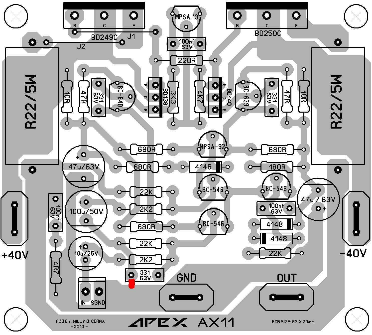

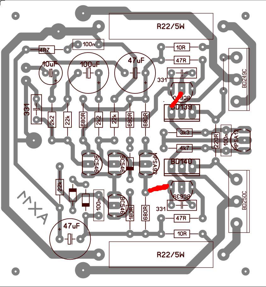

Nice work, thanks but one track missing,

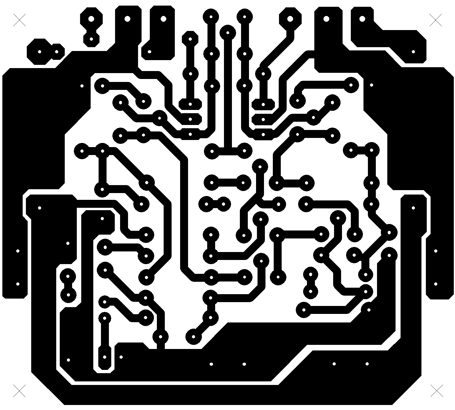

You can change this track, and your pcb will be perfect,

I will change that when i reach home tonight.

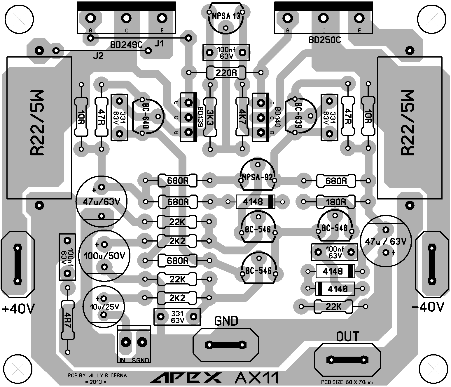

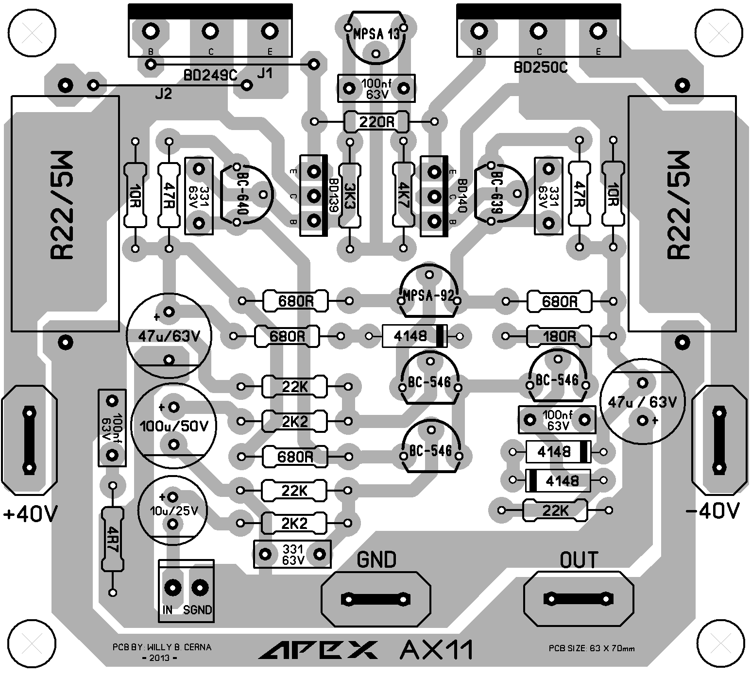

Here it is...
As suggested track, also PCB size was now reduced to 60X70mm.
