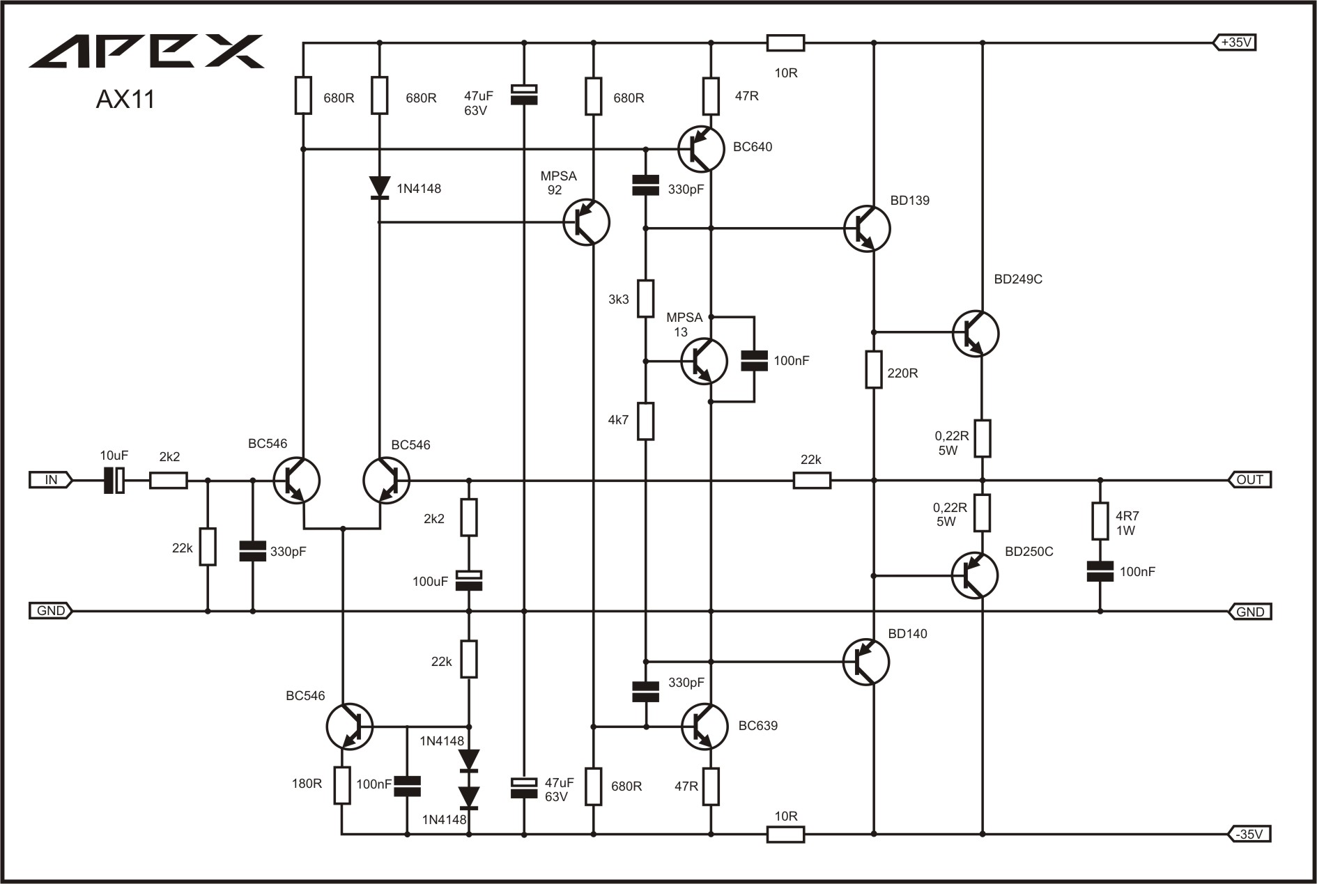

Hi Sir.. Can You share the schematic of Ax 11 amplifier.?
You can DIY schematic from pcb layout.

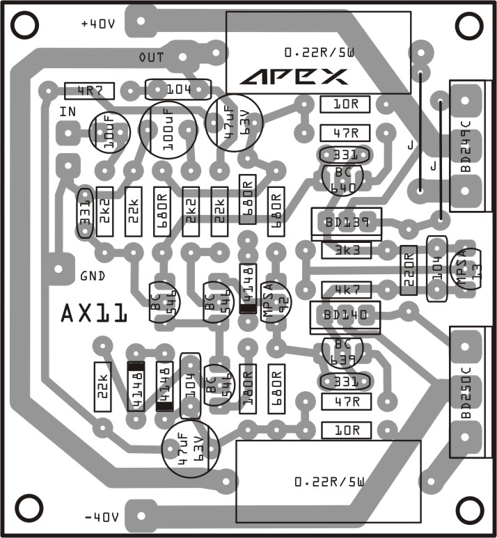

Please make changes in to the pdf file and post it here.

Sure...
As suggested track, also PCB size was now reduced to 60X70mm.
Very nice compact design! good job!

By the way, is there tracks/layout for SR800 in this forum?

Check this @ post# 977
http://www.diyaudio.com/forums/solid-state/173462-studio-reference-amplifier-98.html

i believe that many servicers will LOVE this amplifier,along with is small pcb and common used parts. thank you for this project and to wiljj78 for pcb redraw!
AX11 Schematic
lol beat me to it, just drew the schematic from the pcb layout,
didn't see you post the schematic already.

Nice schematic,
