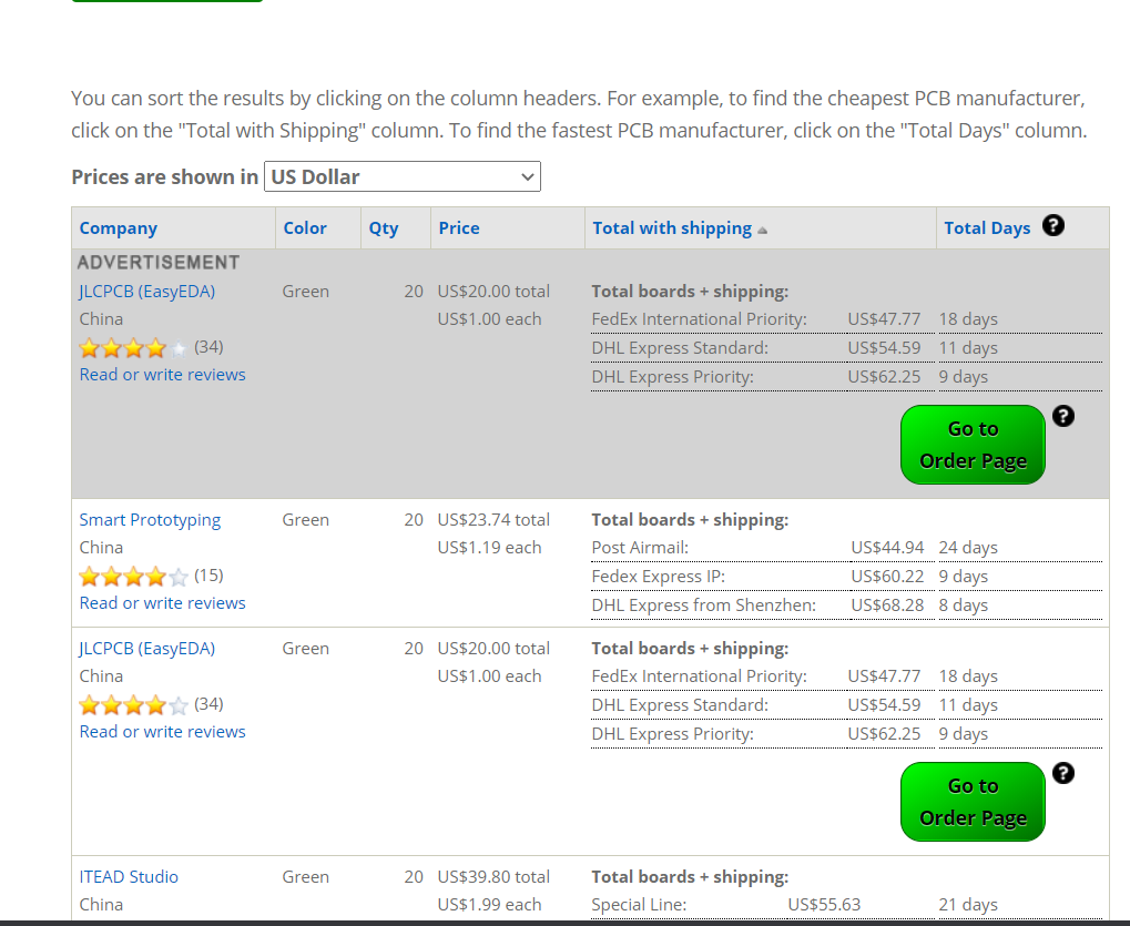

anyway I checked prices, here is a screen shot for 20 PCBs , around 48 USD total with Fed Ex shipping to India. But our customs dept is active these days and charge a hefty duty especially after the border issues.
So these days I am avoiding ordering from "China"

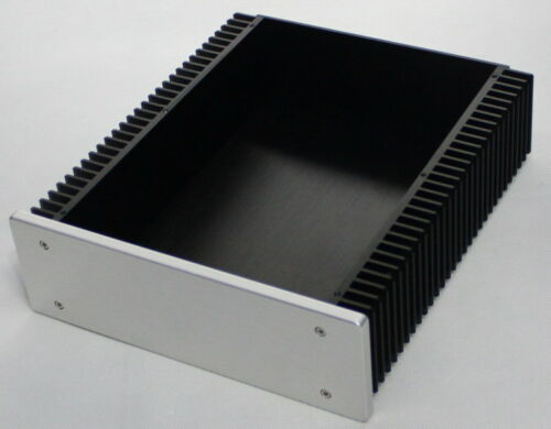

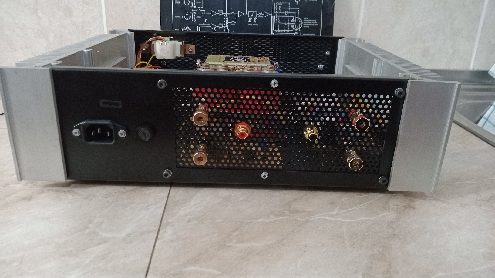

I am considering the following chassis from ebay with external dimensions:245x213x70mm. (internal width: 162mm and outside width: 213mm)
the height is only 70mm, so you wont be able to fit it , you need to go for some other design or cut the pcb right down the middle but that would be a hassle.

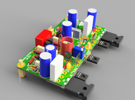

another design for Apex XRK FH-9 is shown (attached) , although shown as side mounted, you can mount transistor vertically on heatsink.
pr like Terry says go for FX-8, its one sweet sounding amp in 50 x 50 mm size , you find gerbers and stuff somewhere in the thread, but uses lateral mosfets which are hard to source or costly.
There are many more apex amps , compact but great sounding like FX-11 or AX 14 etc. with BJT instead of mosfet

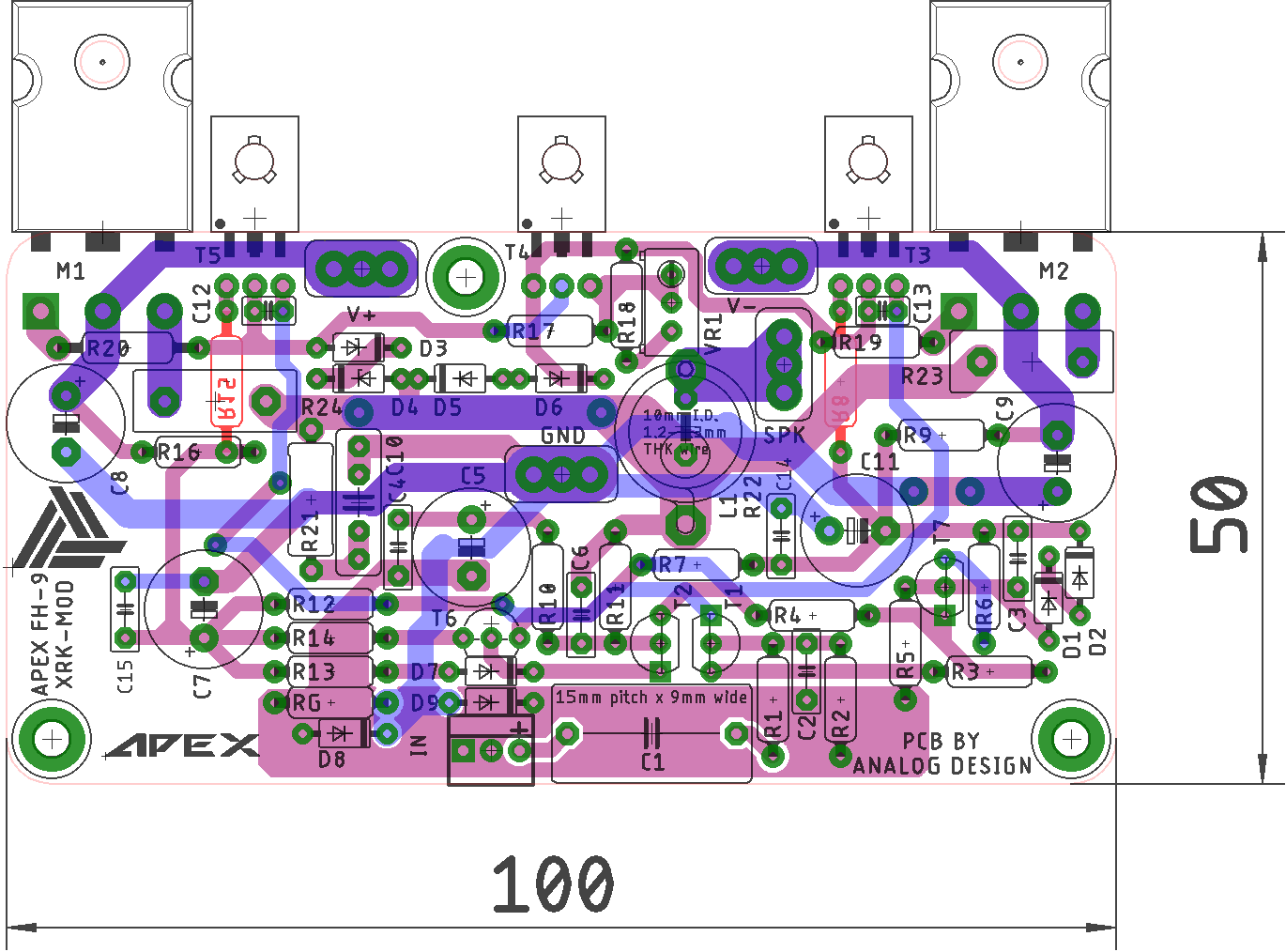

Here are final files and gerbers
I got a quote for the quoted stereo board from my local board house for usd 3 per pcb. if people want me to go ahead with ordering and supply, I can place the order.
If interested, please PM me your quantity (in number of PCBs) , paypal email and name+ complete postal address+ country. Once the PCB are delivered to me I will send out a Paypal invoice; once paid , pcbs will be shipped out via tracked post(doesnt track to usa, canada, australia, etc). [Shipping / packing and paypal charges extra, which is generally about 6-8 usd for 2 pcbs] .Request not to post your pcb requirements / questions regarding pcb/ shipment in this thread to keep it clean.
pcb specs
Stereo (2-ch) Apex -XRK mod FH-9 , size: 100mm x 100mm, 1.6mm thick FR-4, double sided, green mask, white silk on top, 35 um copper, HASL, qty of order will be limited (30-50 pcbs, if i can gather so many interests) and first come first serve basis. If cant get to that qty, I wont place the order.

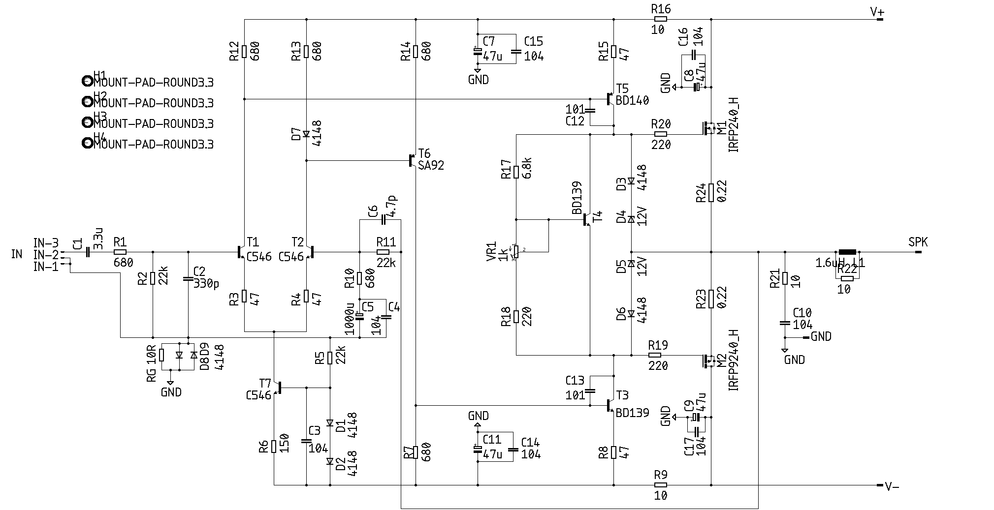

You are right, Stocktrader. The schematic for the stereo FH9 is missing a 22k resistor to ground at the base of T7. The mono board a few posts up has it though.
Thanks for pointing that out. I have added an LED in series with that 22k resistor to GND and it gives a good indicator that the amp is on, and that the CCS is working.
