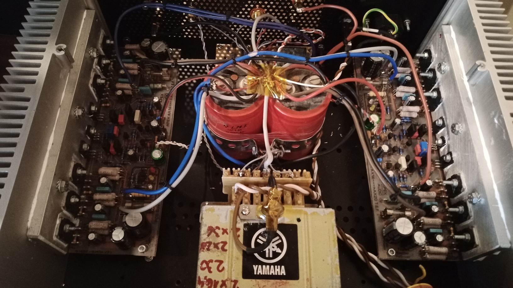

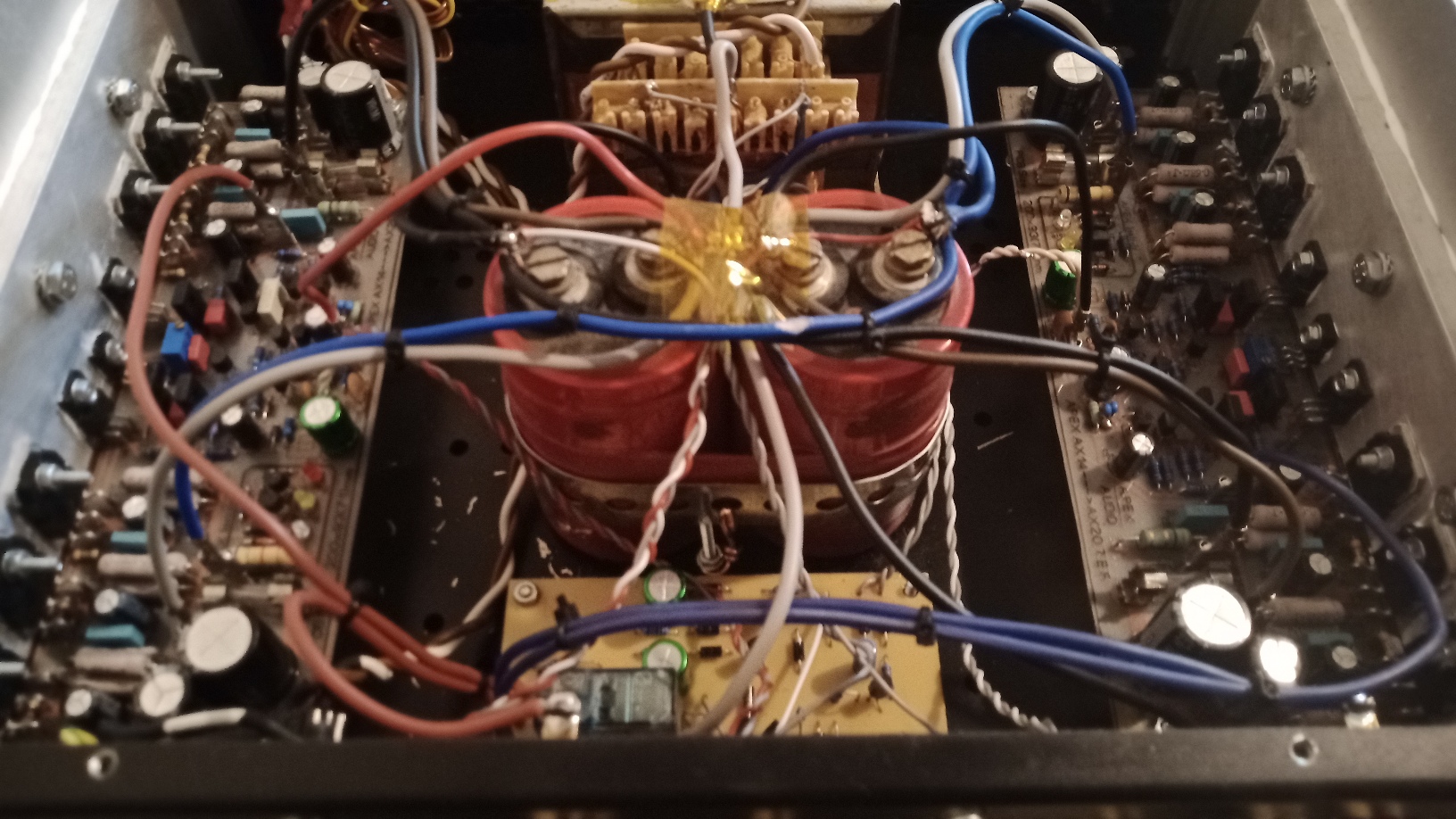

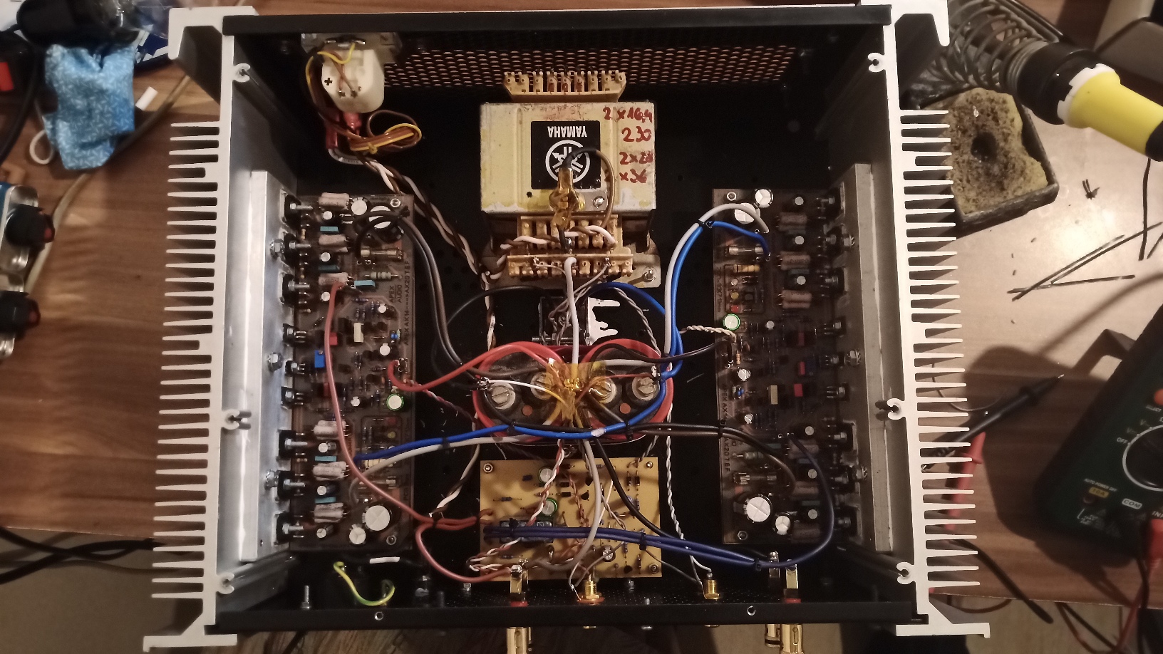

Love it!
Wow! very nice build.
thank you friends �� there are many wires left to be used �� i am at halftime now...

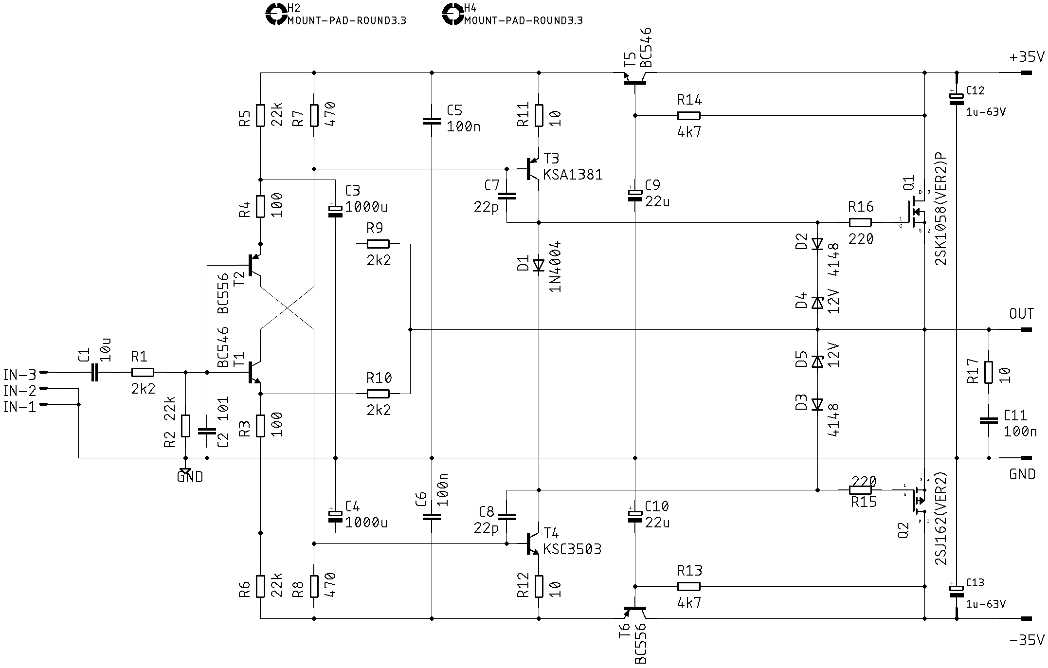

Hi All,
any suggestion for improving quality
Regards
MANOJ

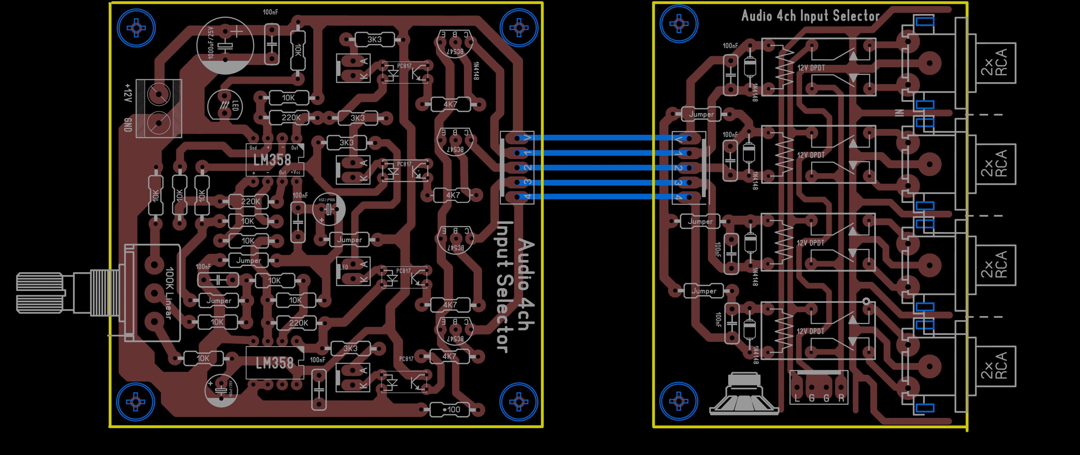

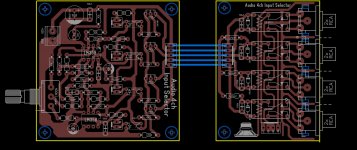

any one share layout audio innput selecter
What about Salas' I-Select board?
GB For Salas I-Select Mesmerize Type input selector and volume control

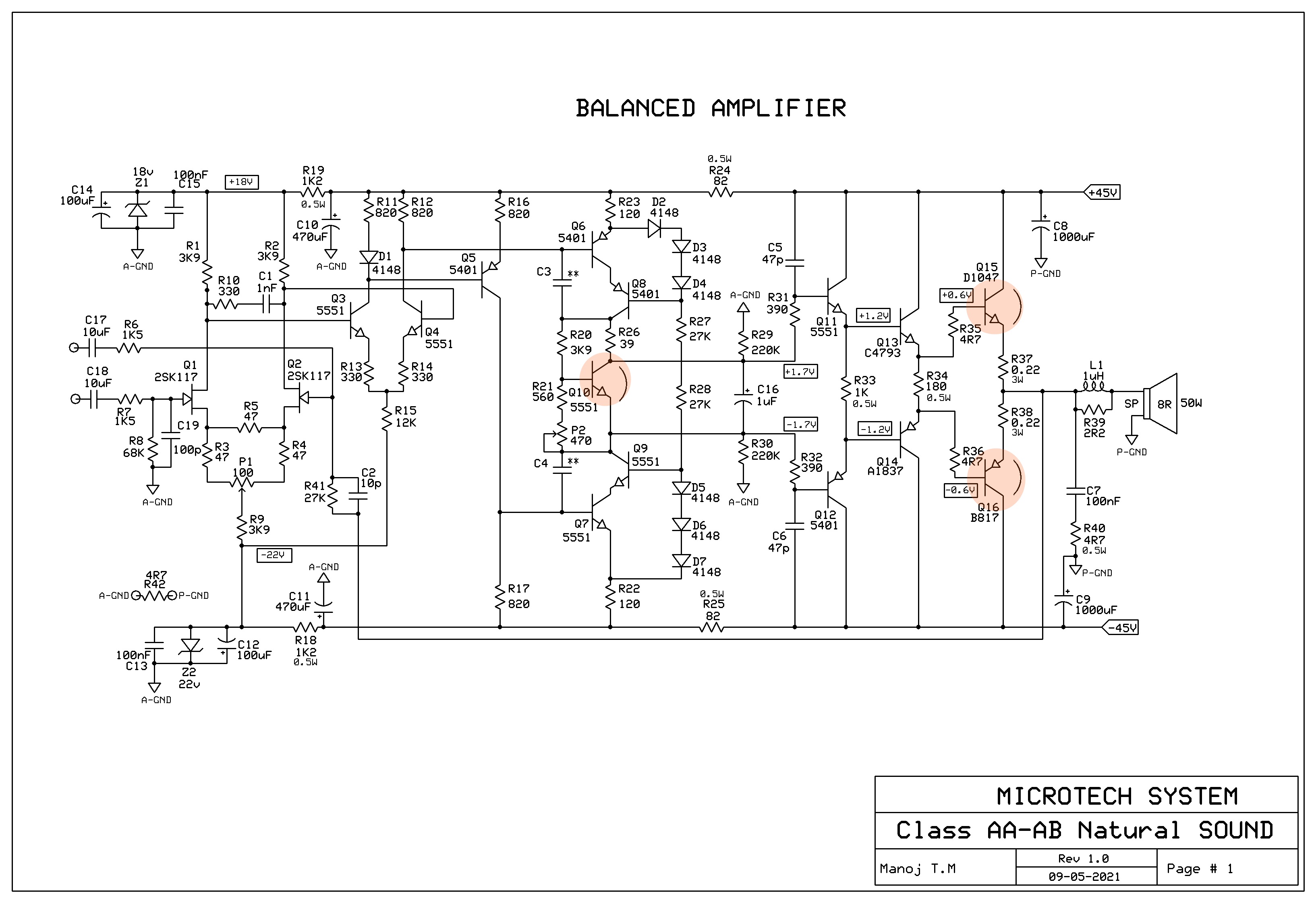

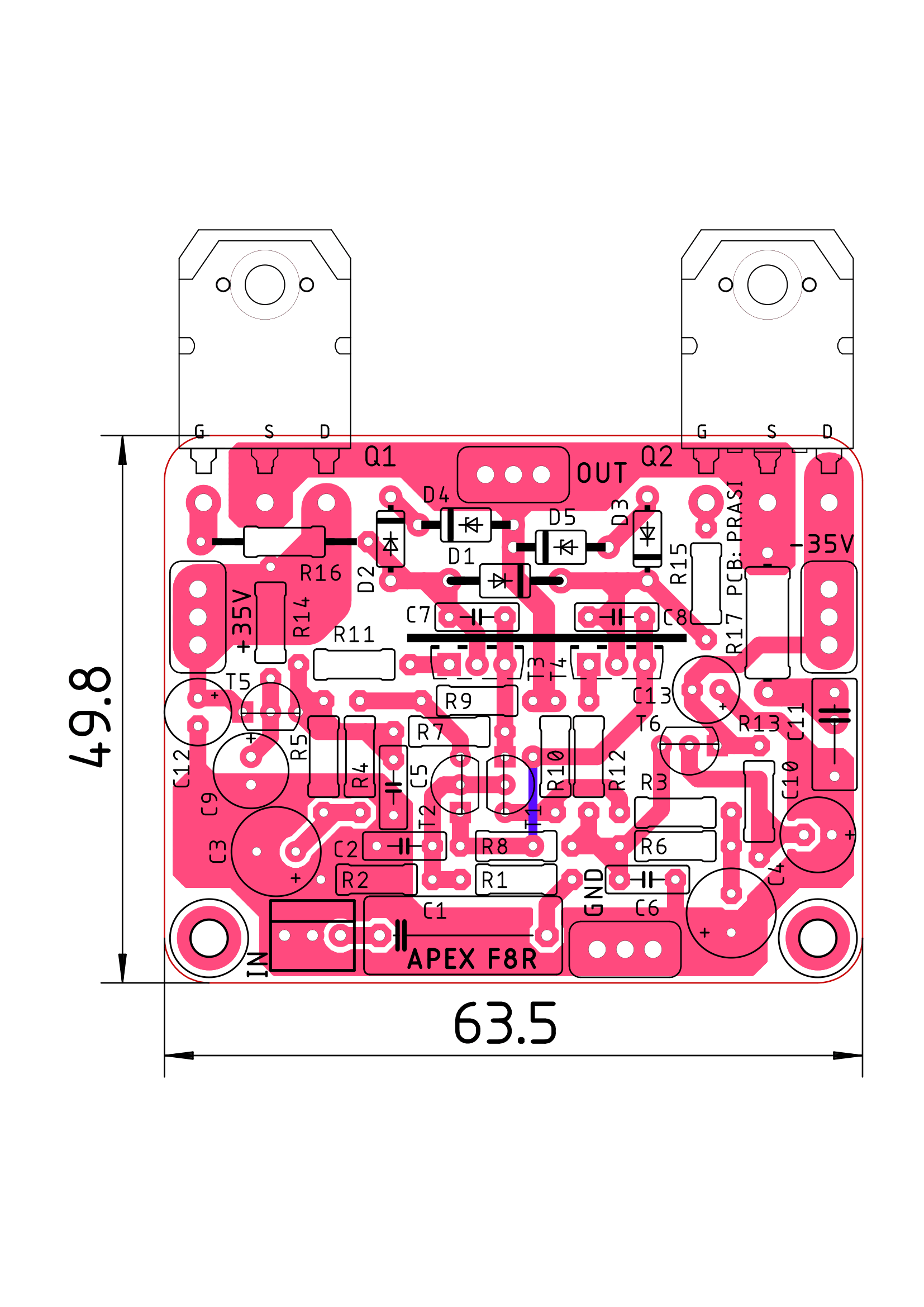

Hi All,
Regards
MANOJ

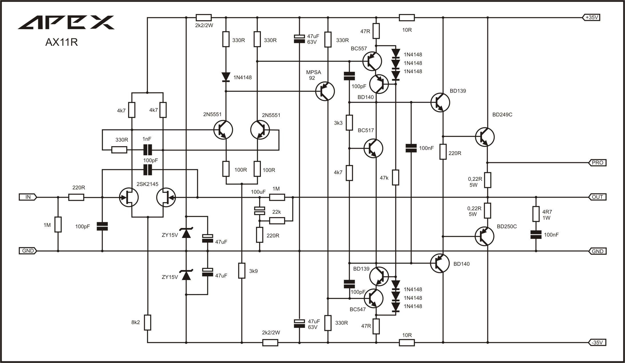

Look like AX11R
https://www.diyaudio.com/forums/sol...imate-fidelity-amplifier-915.html#post4918632

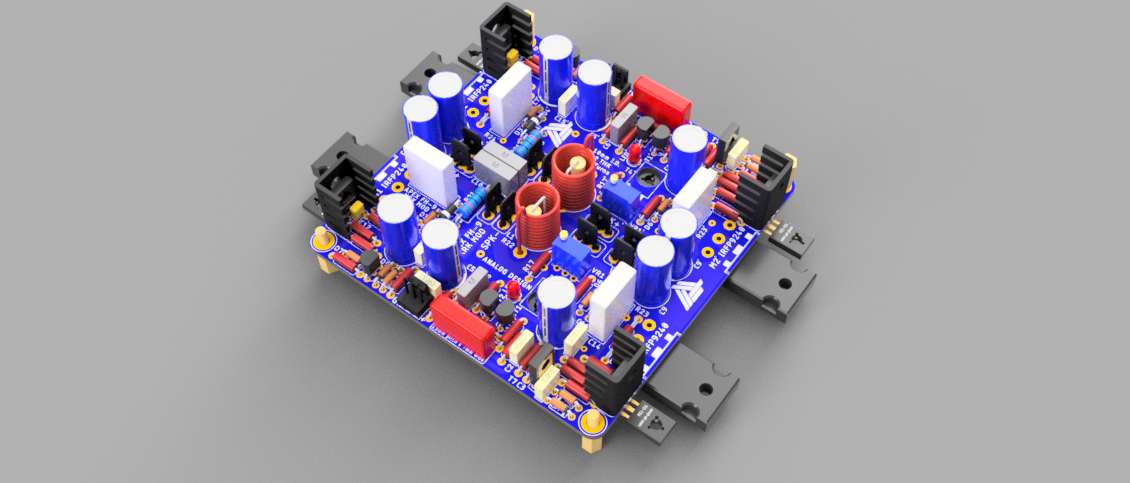

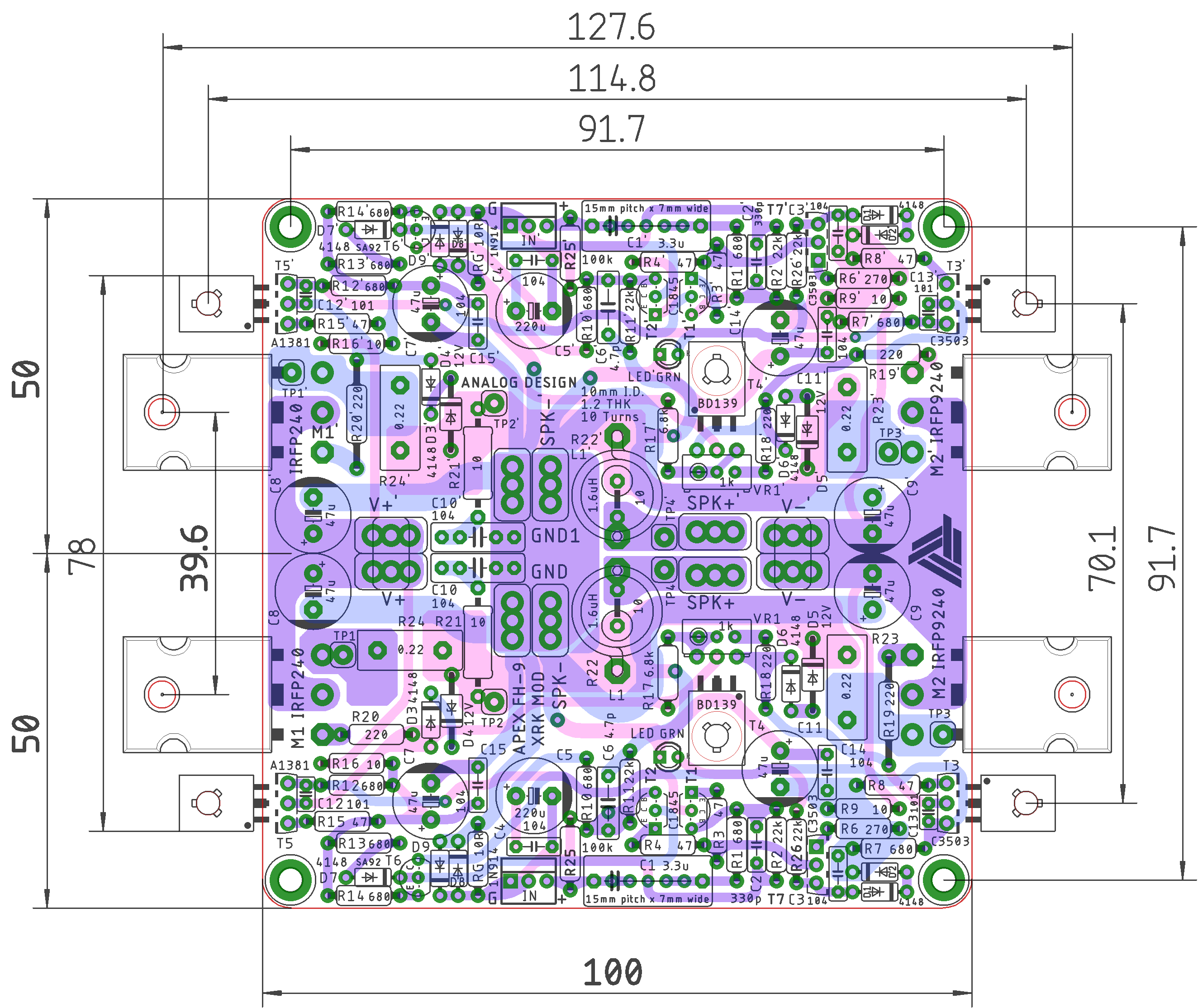

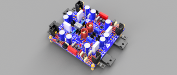

regarding APEX-XRK FH-9 stereo amp pcb, Since I didn't get many responses, I went ahead and ordered 10 protos from pcbway, they are all booked, strawa 2 pcbs, inyashd 2pcbs, viki_v2 4 pcbs, me 2 pcbs.
if anyone wants to place order , they can do so below.
APEX-XRK971 FH9HVX AUDIO AMPLIFIER-STEREO - Share Project - PCBWay

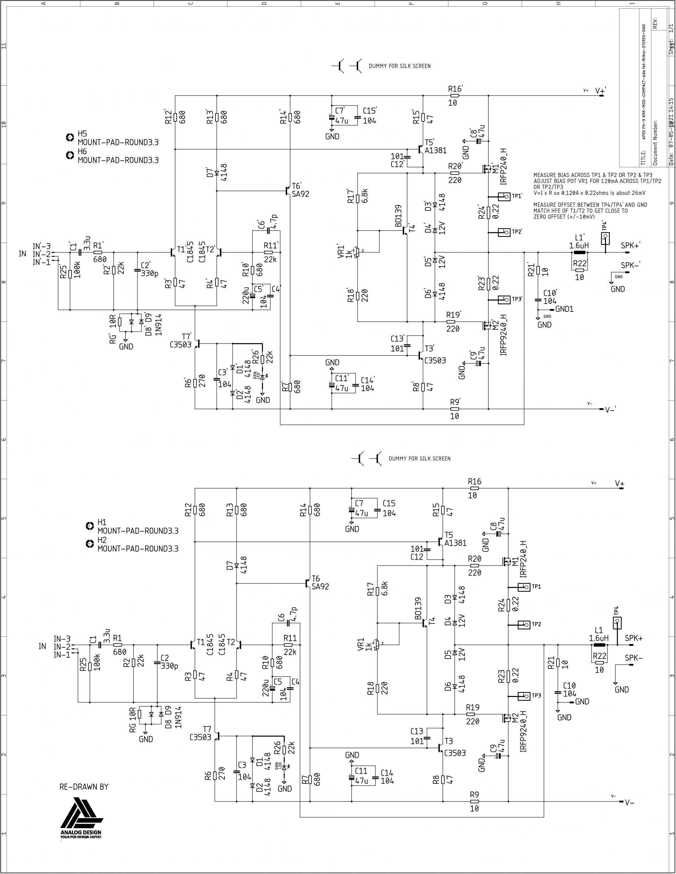

is there any option to get pdf of top and bottom pdf of cooper traces and layout here,or any other way? i could try to do this amp board diy. (my personal best way)
here are all files, pdfs , stuffing guide and sch and gerbers.
I will send you pcb if there are any remaining.
APEX FH-9 XRK-MOD-COMPACT-side fet-fh9vx-STEREO-GND_2021-05-07.zip875.8 KB · Views: 340
I think I had missed this one.
I didn't do any comparisons yet between the schematics, but will these BOM's work?
https://www.diyaudio.com/forums/gro...-100w-class-ab-lean-times-10.html#post6198185
If you want order from pcbway, order from the link provided, that way i will get some commission . You can also change pcb specification of pcb if you so desire. pcbway charged me 15 usd shipping. + 5usd for pcb + there will be some customs duty of about 1100-1200 INR by our overzealous customs.
Schematics almost same, but bom may not be valid for this design as I have used some other packages for some resistors and caps, (e.g. input caps , electrolytic caps, ceramic caps, etc). Also inductor is hand made in this design. I can give you parts list with dimensions.
regards
Prasi
PS attached.
