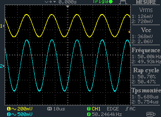

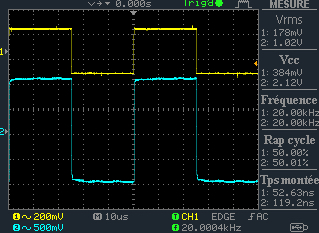

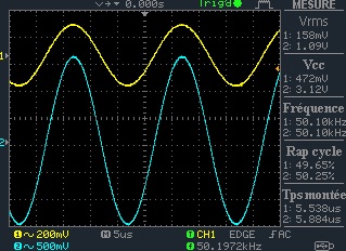

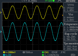

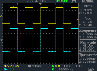

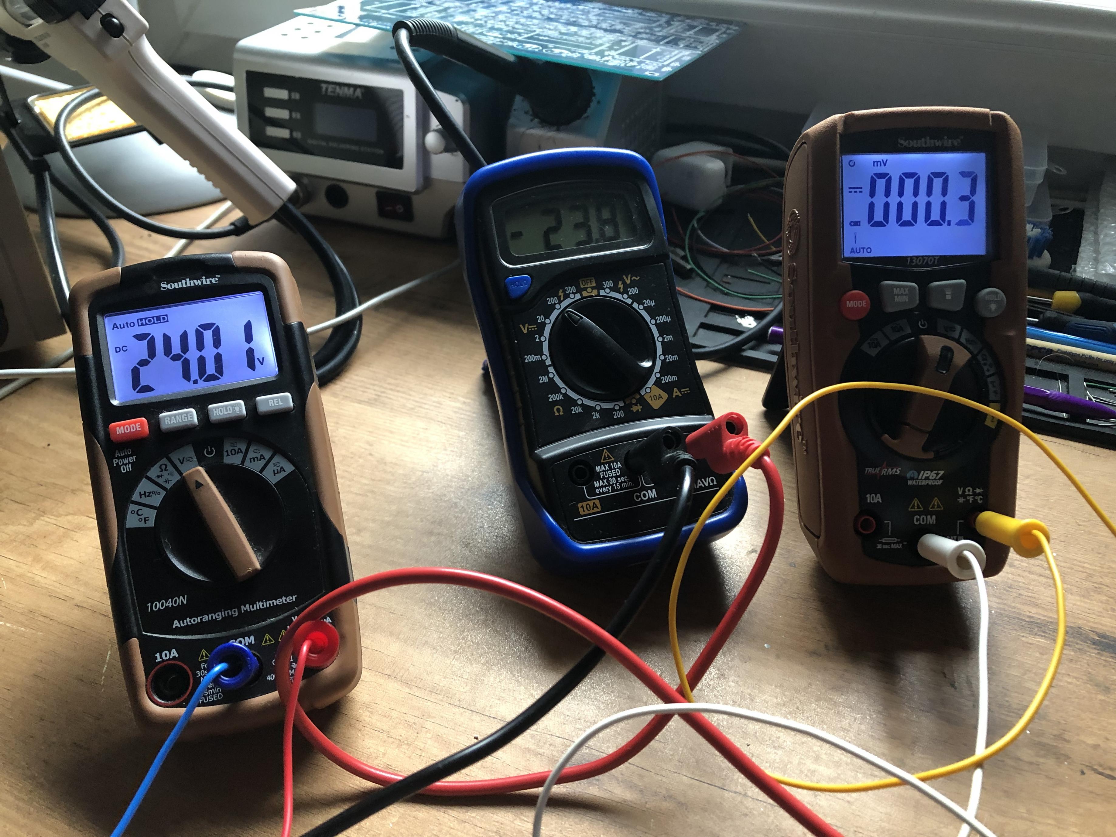

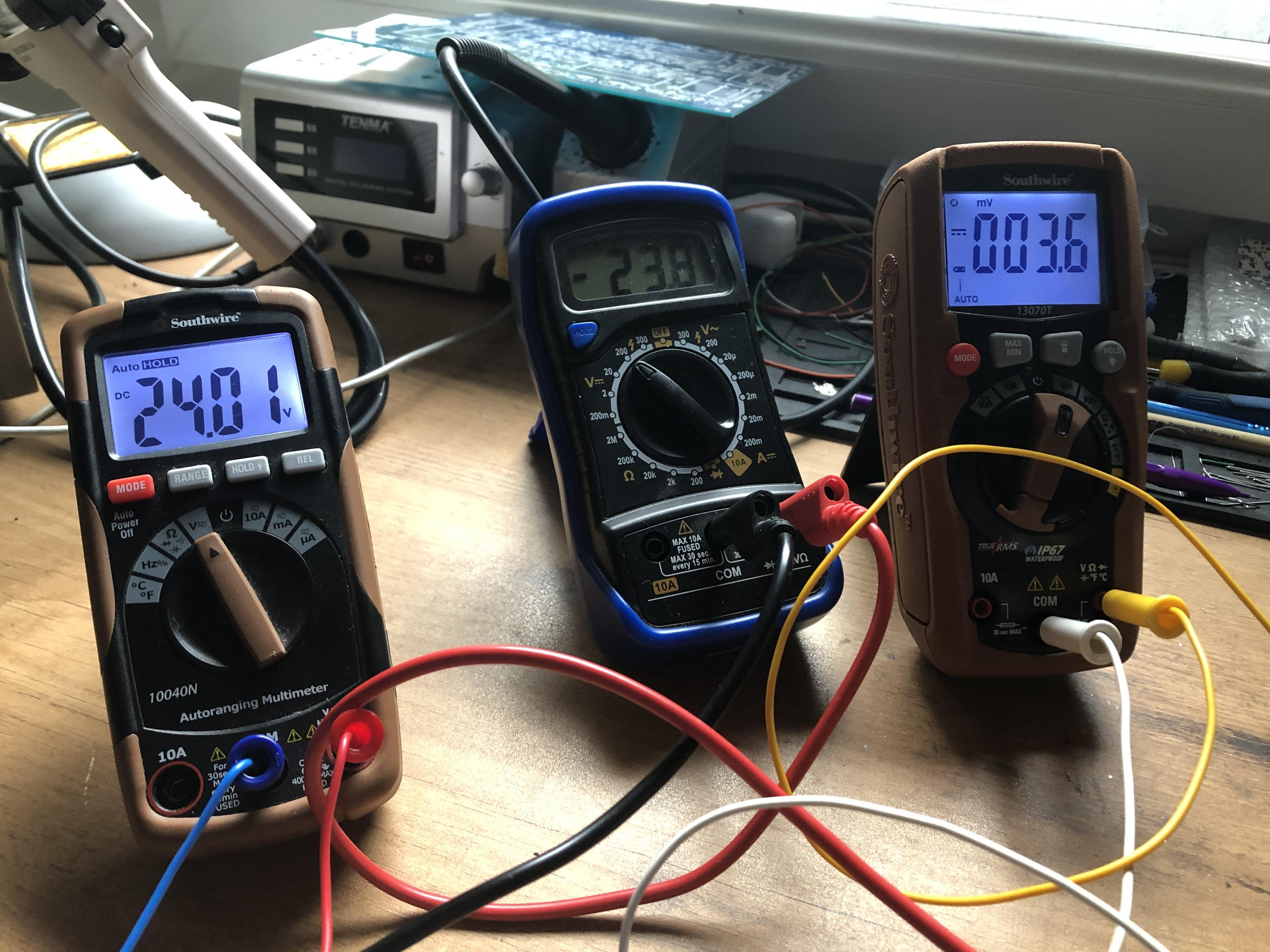

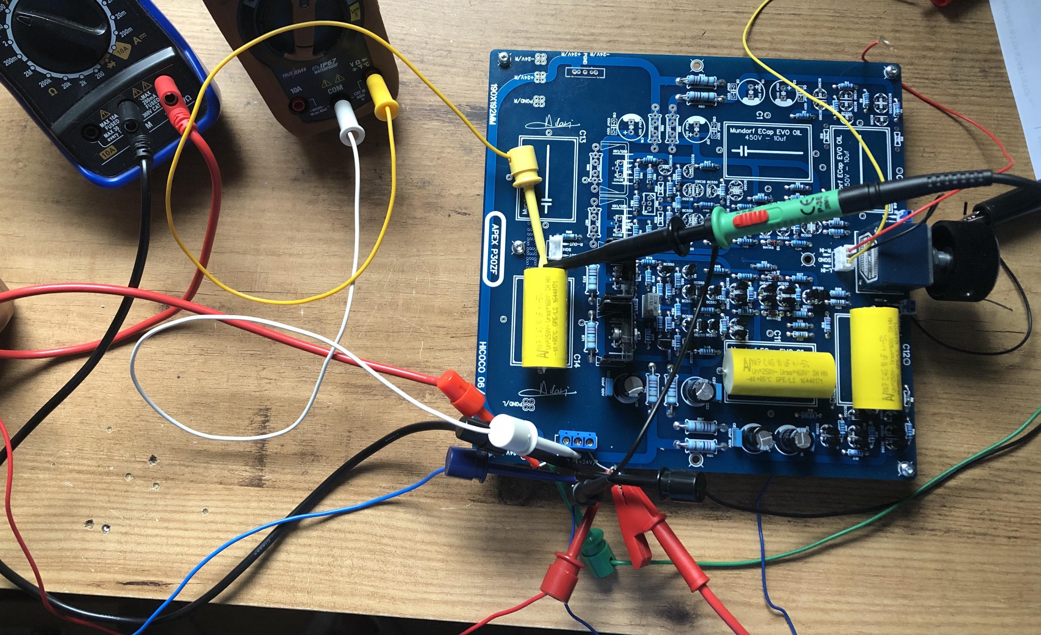

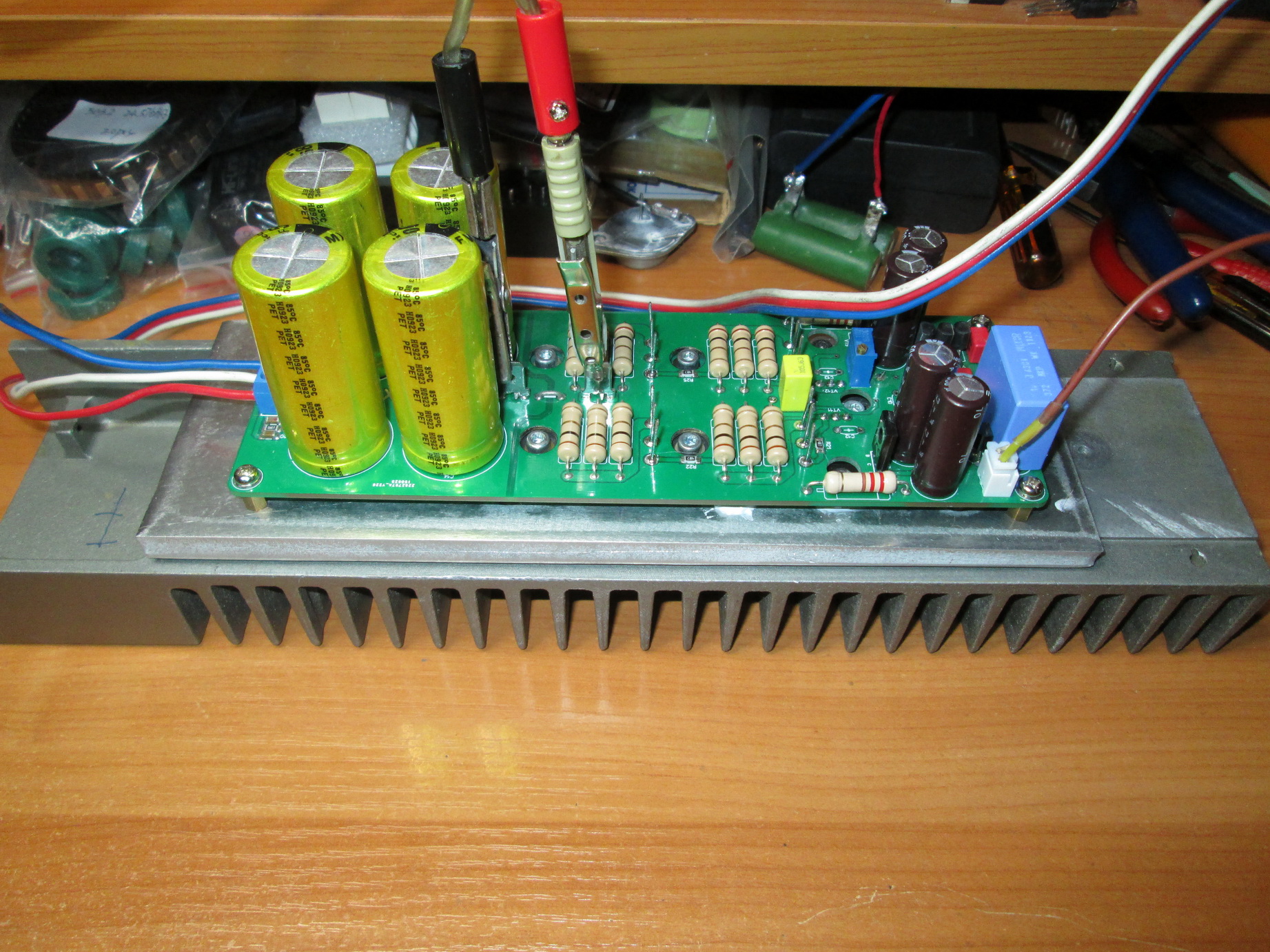

P30ZF Right channel test
Here are the first tests of the right channel of the P30ZF. Unfortunately I don't have the tools to measure THD.
I will work on the left channel now.
Please let me know your thought.
Couple of Question,
What is the 1K trimmer for, now it is adjusted 50%.
I have an offset oscillating between 0,3mV Dc and 3,6mV Dc at the output. Is that ok?
Couple of Question,

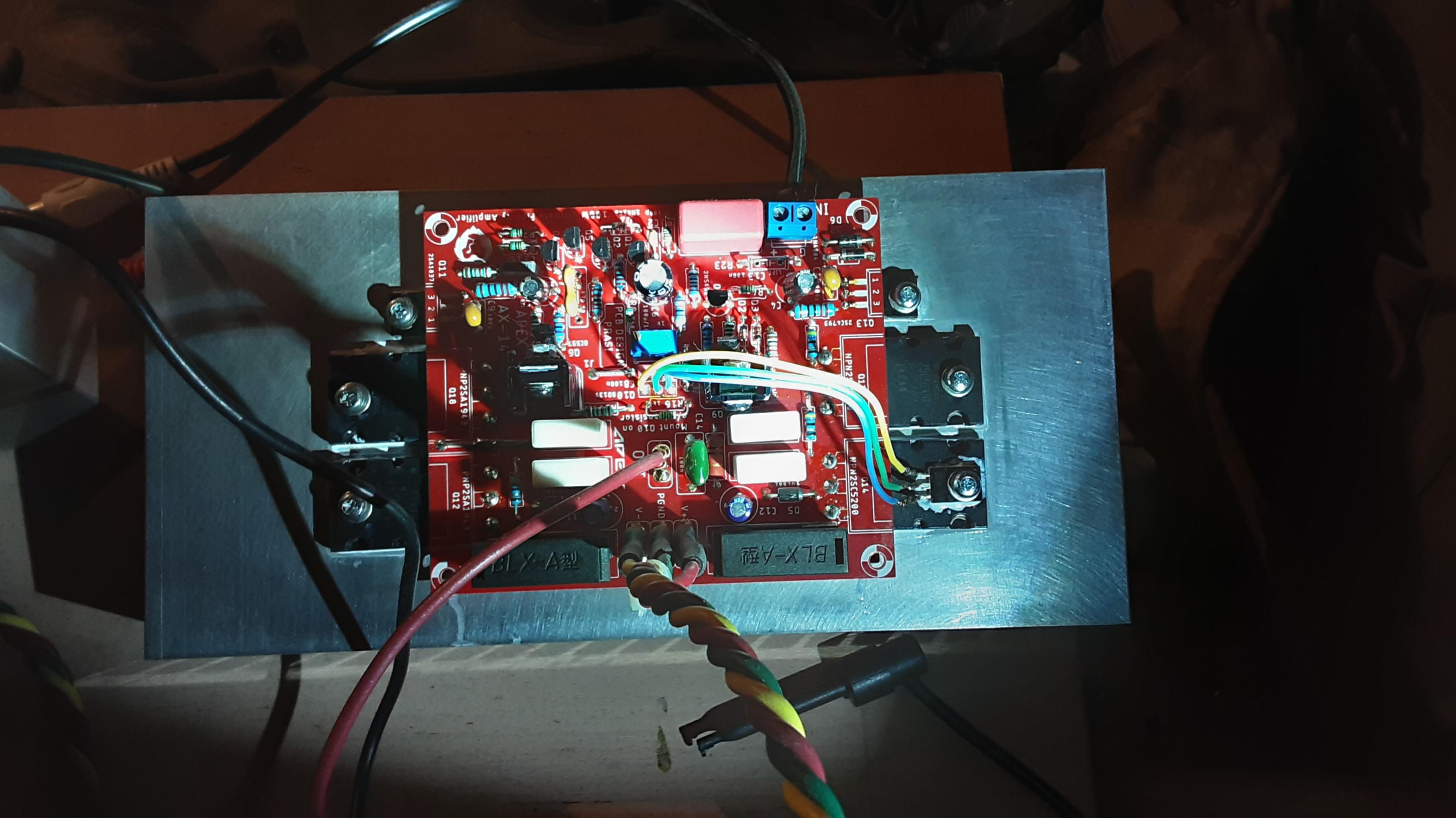

I'm trying to set the bias on my board but the most it will move is from 1.2mv to 1.3
Double check r16 and r17 value. Also, try jumper at r23 [edit - noticed you already have ground wire to input]. One more thing, mount Q10 directly to output transistor, using wire leads to connect to board. I didn't do this at first and bias was fluctuating. Thanks prasi for spotting that on my build.
Somehow mine has 10mV and idle current via Q14 and output at 0.10~0.15mA with no setting.
its working ok and nothing is getting hot, should i get worried?🙄 been up for the past 20min
Looking good with one exception. Mount Q10 to output transistor. See above, post 13148.

With 1k trimmer set THD, offset is ok.

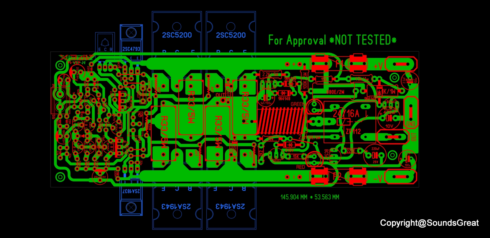

Am not good with pcb design and such hence requesting here else would've done it myself & shared it here.
I assembled an AX-14 on pcb, which I ordered from this link: Apex AX-14 - Share Project - PCBWay
. The pcb fit well with 7cm heatsinks. The diodes and capacitors of the power supply are located on the amplifier board.
New Draft AX-14P
Thank you for your reply but there are few issues with that, This version does not have protection which is what I mainly need and also the caps are too small Am looking at using 2 of 22,000mfd or so and SMD Parts etc to name few due to which I cannot go with it, I had already checked it out,But thanks nonetheless for your valuable response.
But even if I overlook the above biggest problem is,Currently there's tension between India and China that's causing all sorts of hell and due to this nothing from China is being allowed into India,So ordering it from the above is ruled out, That is the reason for me to ask for Sprint or Gerber files so that I can get the PCB done locally.

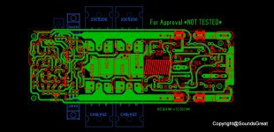

Anyways since no one bothered to respond I did what I could best and here's the result (might be poorest by other's standard but still).
I request people who are good at this to kindly take a look at the addition and either correct it or let me know what to do.

Thanks for this new draft of AX-14P.
You might get more help if you also attach the schematics to it.
Have a nice day.
Have a nice day.

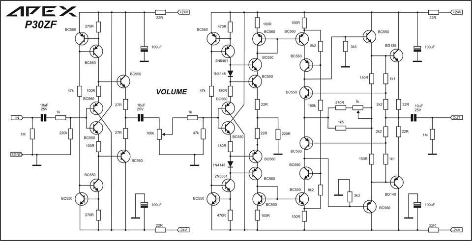

No need to thank,Hardly anything I did here. The Schematics is the original AX-14P with LED's added (as per the desertstorm's layout)
Hope at least now people respond😉

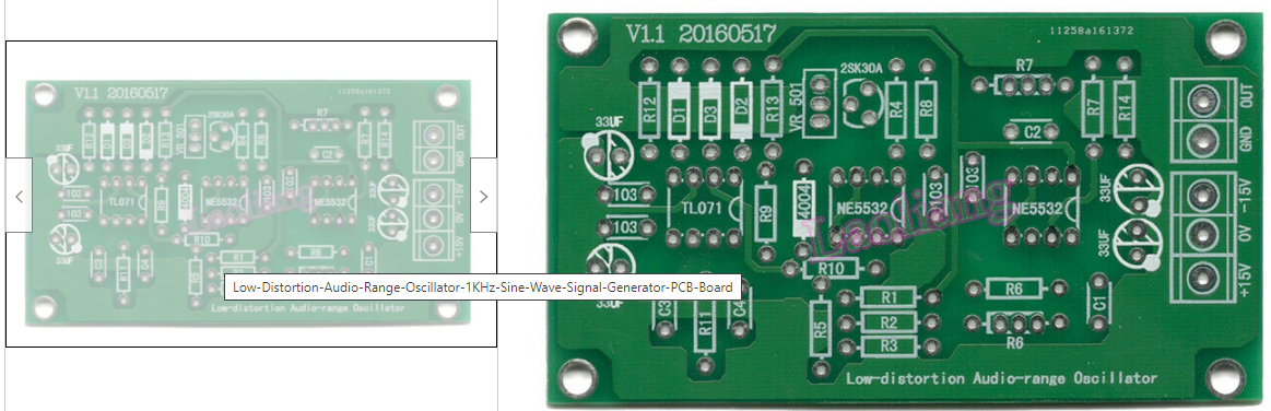

I did a few searches and after that I found the bare PCB pictured one on Ebay.
Is that one a variant of what you use (picture enclosed)?
It uses a 2SK30A. Not sure if that is one of the commonly faked parts or not. I wonder if anyone can recommend a suitable FET that can be reliably/safely sourced. The other parts I have.
If I can get it going I would like to do measurements on some of my kit amplifiers (such as the JLH). In particular I would like to see "as supplied" and then with Mouser/Digikey sources transistors swapped in. Later maybe some capacitor upgrades. I would be up and running already if the built in audio chip was not so bad. Perhaps an external oscillator will let me use the Audigy 2 ZS. Otherwise I need to get yet another sound card. (I already have Audigy 2ZS and an X-Fi. The Audigy 2 ZS worked just fine on older Windows versions.)
For example, I would enjoy looking at the results of the supplied TIP41 compared to Genuine TIP35 (Digikey) to Genuine 2SC5200 (Mouser) to Genuine 2SC6145 (Digikey). Please realize that I understand that the JLH might not sound better (in fact might sound less pleasing) but I would still find it very interesting. Also I would be interested in seeing if I can compare spectra of genuine to "clone" that I have from a variety of kits. Plus I can use the Genuine 2SC5200 & 2SC6145 in a variety of AB kits anyways.
