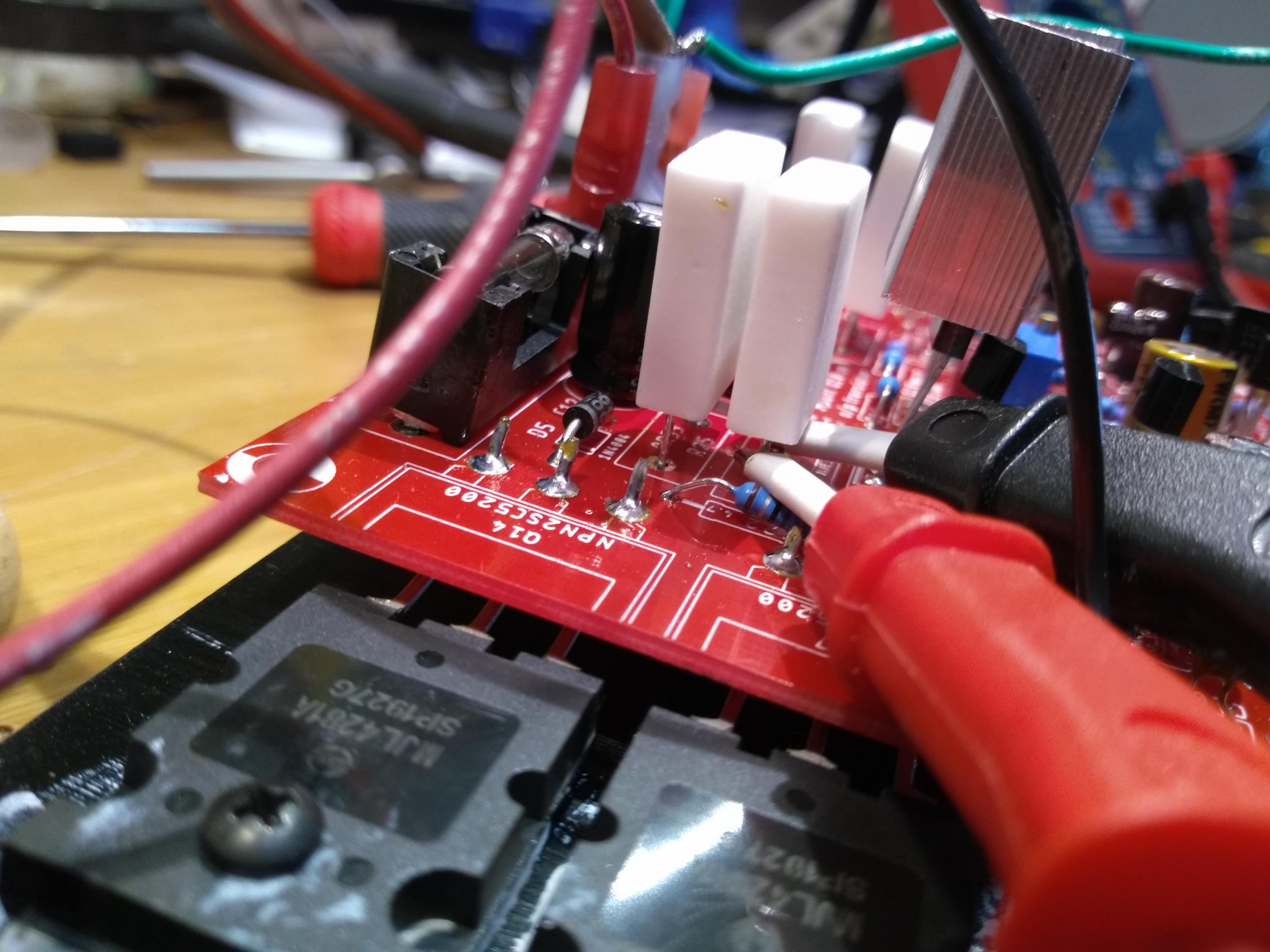

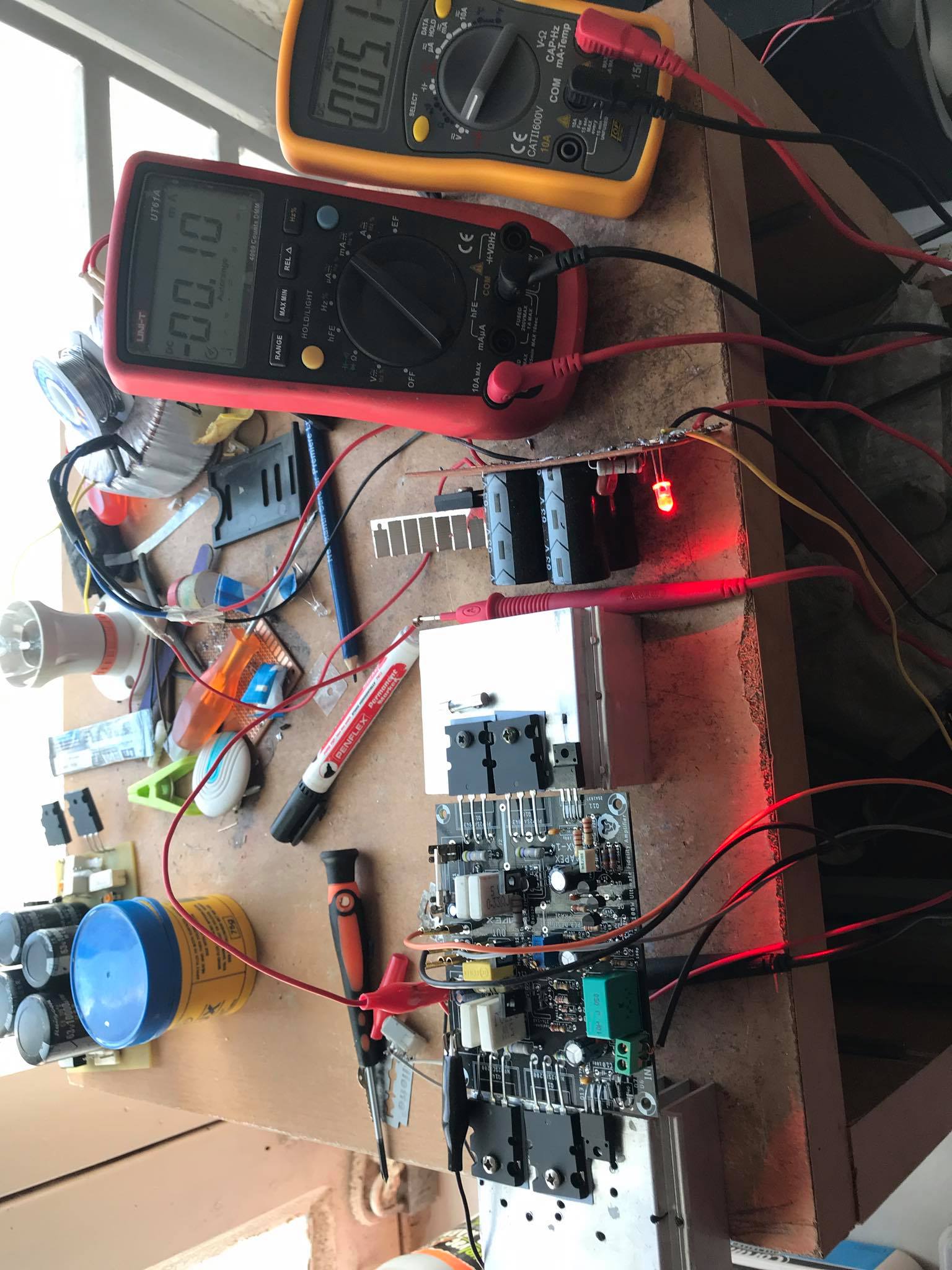

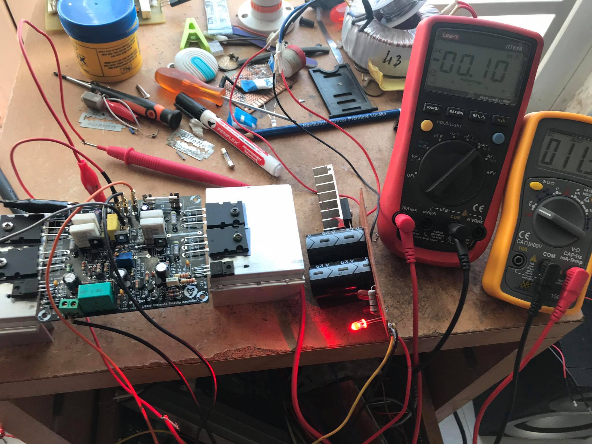

Somehow mine has 10mV and idle current via Q14 and output at 0.10~0.15mA with no setting.
its working ok and nothing is getting hot, should i get worried?🙄 been up for the past 20min

That is better than mine. It sounds terrible, really distorted and low volume level.
The other channel I did works fine. I still can't find anything that is causing this one to register so low and not respond to adjustment more.

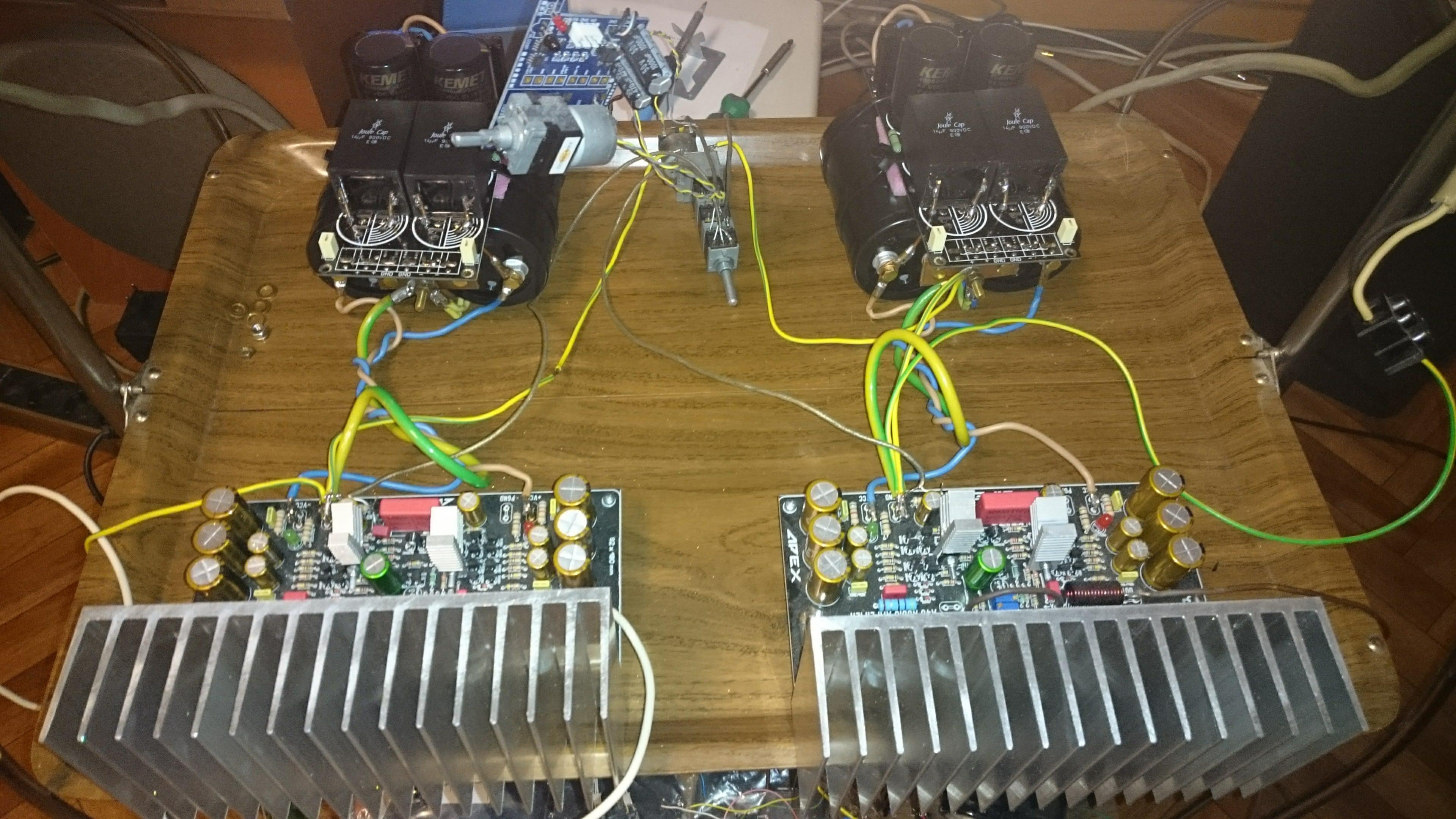

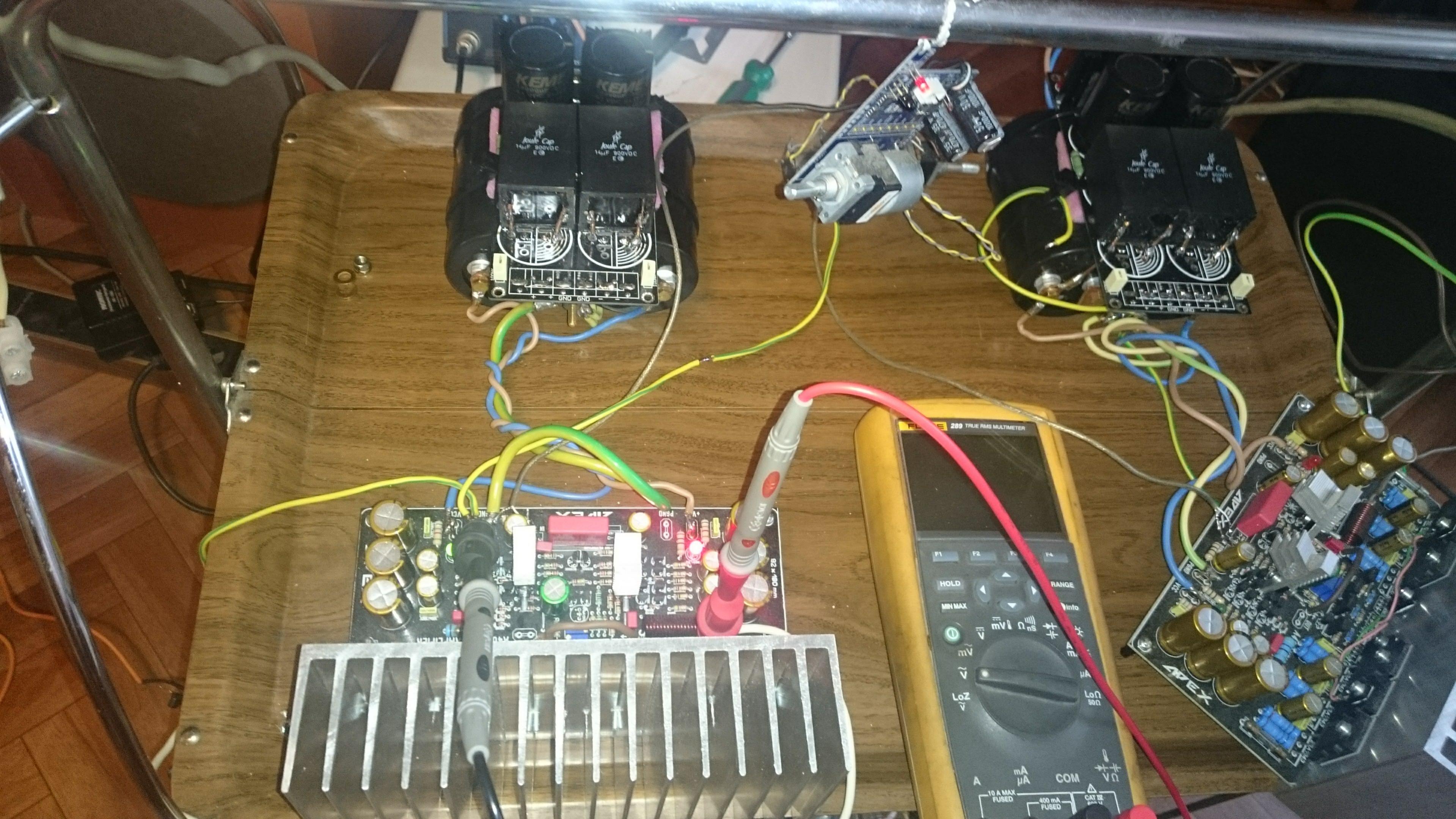

I use RSPro with USB hardcopy..almost done with the Right channel Test, i will post more pic.@ Hicoco,
Are you using a usb-oscilloscope?
Looking for a good cheap one 😀
I use RSPro with USB hardcopy...
Thanks for the info. The usb symbol mislead me 😉

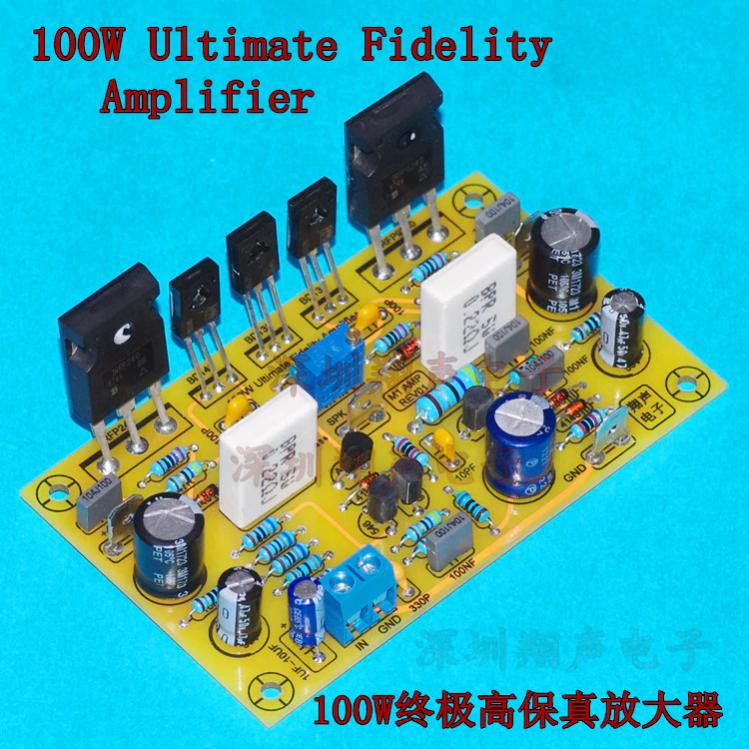

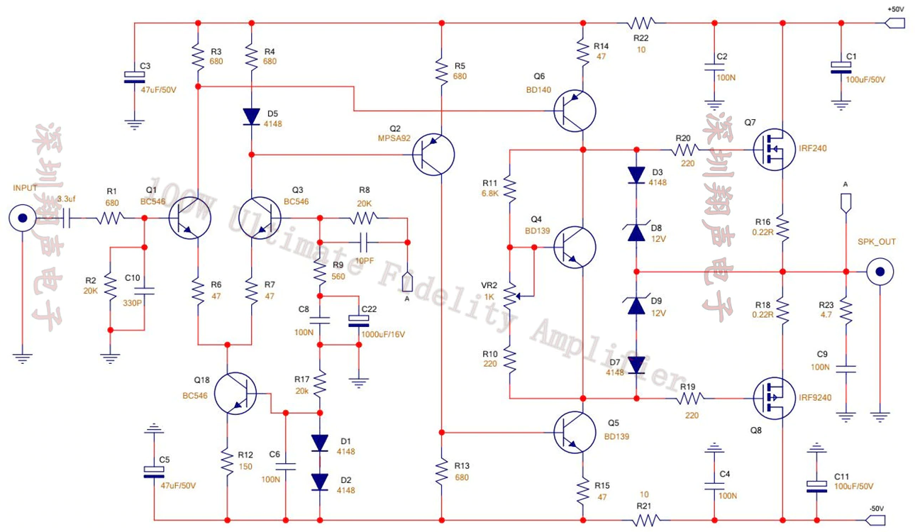

Is this a picture and schematic of the 100W Ultimate Fidelity Amplifier which started this thread? Is it a good kit to try?
This is clone of APEX FH9.
Is this a clone that you are "ok" with? Would you recommend that an interested hobbyist try this kit to compare with their other projects (such as MX50X2 and MA9S2)?
Due to the very high interest in this thread I thought this "100W Ultimate Fidelity Amplifier" might be a suitable next project for me to explore.
Or do you recommend a different starting point instead of this kit? (Maybe it is or is not a good clone, and/or maybe you have another design that you would suggest instead?)

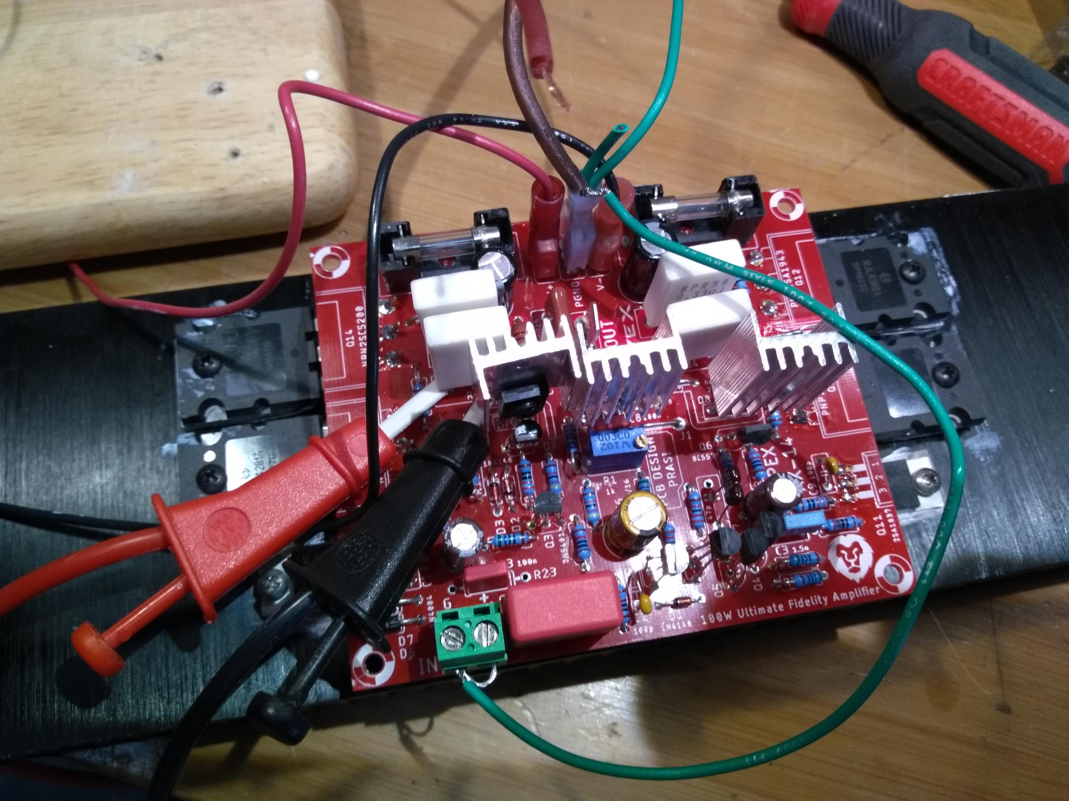

check VBE voltages. start from first transistor on your sch.
